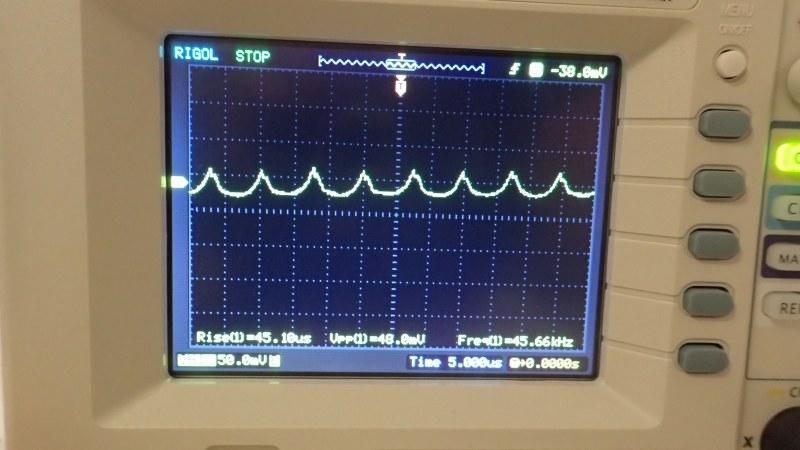

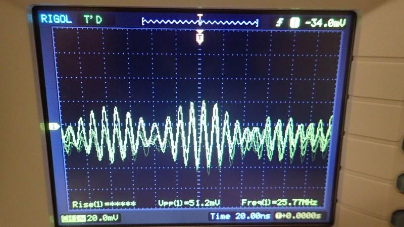

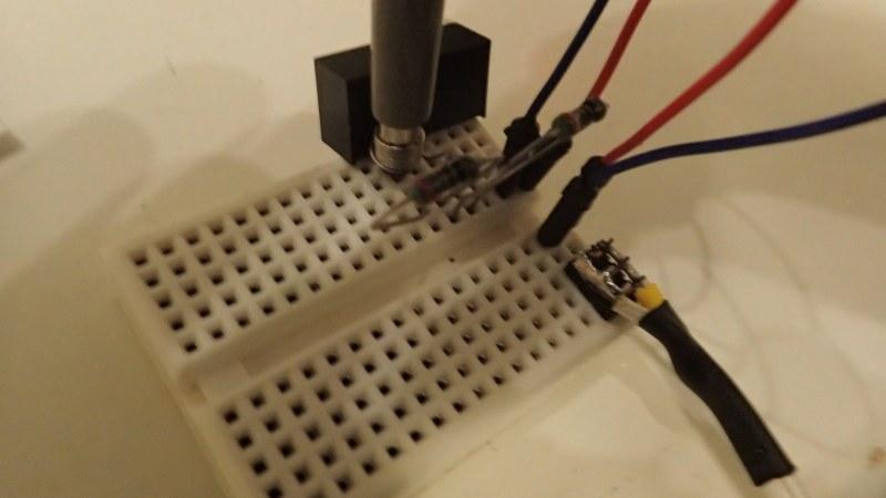

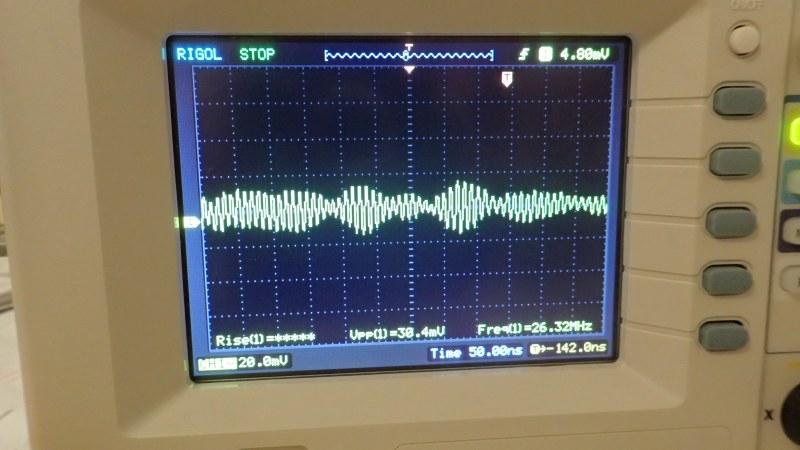

Two scrneenshots, neither of them even close to trutfull. First shows the effect of gounding clip. Second is measured with a "spring clip" (shortest probe length/grounding loop), 70% of nominal loading - purely resistance and keeping all wires as short as possible.
The scope is RIGOL DS1052E and it is 50 MHZ 2GS/s model. It has very little control over samplig rate/filtering, set it 20MHz and can't verify DC/DC converter ripple one way or another.

Scope settings look right, ripple period should be either 8uS or 4uS depending on what rectification is used. Maybe it's a good power supply?
PK

Turned out that ground clip picks up all signals there is in the universe. First picture: probe grounding with springgy thinggy.
Second picture: feeder PSU, DC/DC converter not connected.

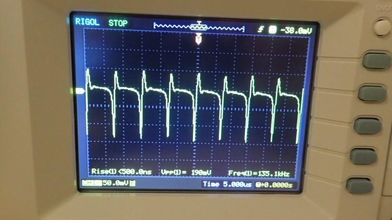

Third picture: same spot than #1 (primary  of  DC/DC) converter connected and loaded 70%. Looks like could use capacitor on input side.

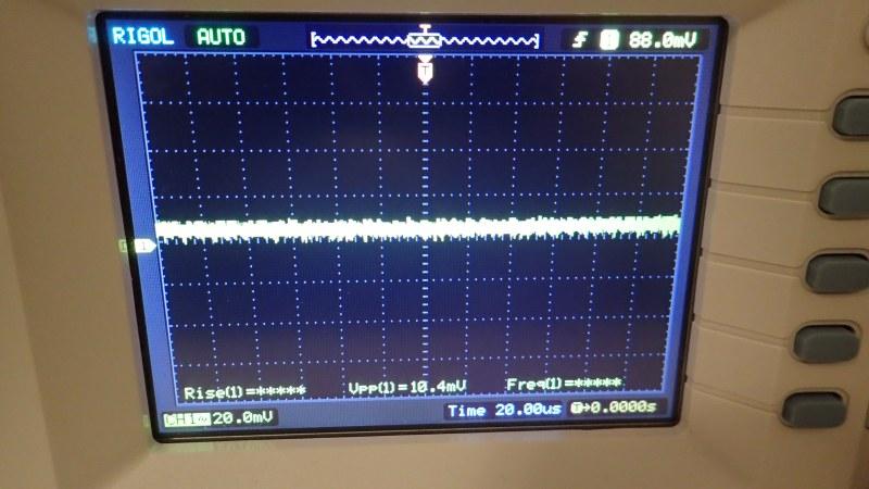

Fourth picture: Output of DC/DC converter. Looks ok.
