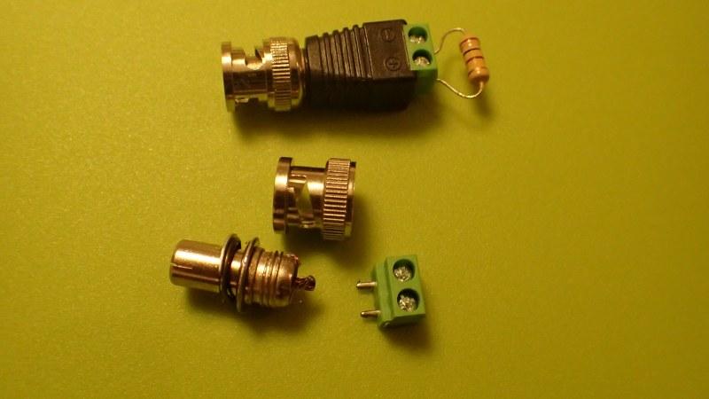

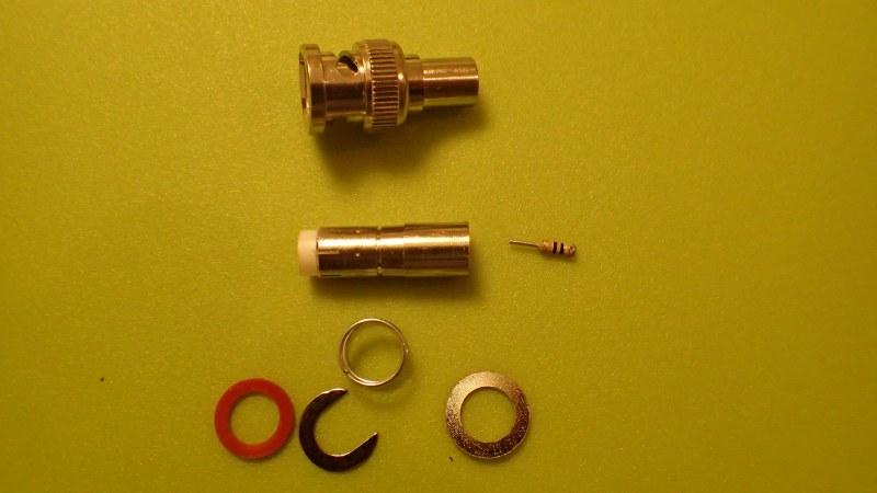

Re: How do you terminate your coax to BNC?
« Reply #10 on: March 03, 2018, 01:04:53 PM »
Three pictures of ebay stuf...
Bought some cheap terminators and found one not working. Maybe someone failed to make connection? Those were not cheapest. Pretty sure you can't give them 10Vpp signal.
Needed those BNC/screw terminals to test twisted pair cable (termination) and stuff. Nicer to build test stuff with a screw driver than trying to solder wires into BNC body.

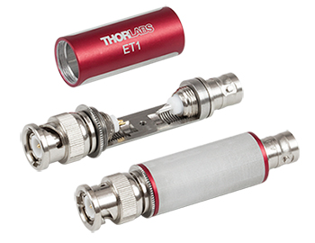

A little followup!
Roger, I just had ordered from that comppany some connectors and small stuff. Funny that I did not notice that connecor though.
I got some connectors and stuff for my previous projects.
Lately I have been making some low quality contraptions and all sorts of ebay specials have been dripping trough. There are some feed-tough terminator/filtering/impedance maching circuits I have tried out and alhough they work out ok when soldered trough terminals, some DIY solution that will be mechanically sound for test/measurement use has a little appeal.
Found some really nice and professional products.
https://www.thorlabs.com/newgrouppage9.cfm?objectgroup_ID=8681

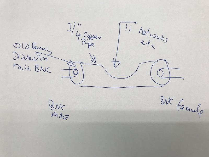

Back 'when I was a lad' I used to solder old pennies (240 to the £) onto the ends of 3/4" copper plumbing pipe that I'd scooped a section out of in the middle to give access for mounting pi networks etc within. Simple, cheap and robust.
« Reply #16 on: April 04, 2018, 03:50:09 PM »
Thank you, That is neat. How do you take clean bite out of copper pipe? Hole saw?
Sometimes something is better than perfect, but much too late....
https://e2e.ti.com/support/power_management/simple_switcher/w/simple_switcher_wiki/2243.understanding-measuring-and-reducing-output-voltage-ripple
« Reply #17 on: April 04, 2018, 03:57:37 PM »
When I was doing that I was probably 13 or 14. No machine tools, no electric drill. It was all hand tools and a 'brace and bit' carpenters drill and a woodwork vice.
I probably had four or five files at home and  my soldering iron was a copper lump on the gas stove. I did manage to sneak the tube with the pennies already soldered on into the school workshop and turn the pennies down to the tube diameter .
A bit later a friend of my fathers took pity on me and gave me a Henley Solon 25 watt electric iron - sheer luxury  :ddb:

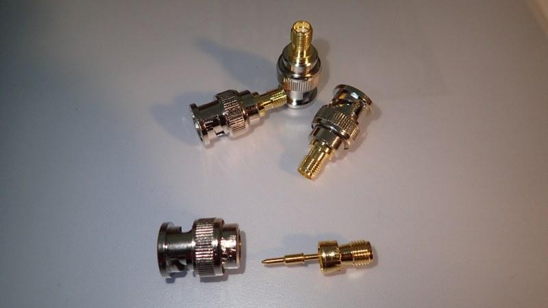

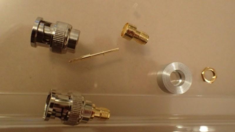

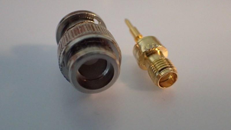

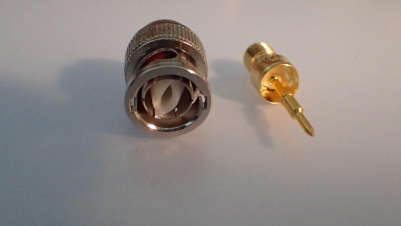

Goinf off the tanagent....
got some SMA terminated cables and BNC/SMA adapters.
Desided to disassemble one BNC/SMA adapter, because it looks like it could be a trough terminator with addition of one or two resistors.
Did no pull out easy, long nose plier slipped and made unssightly groves...now it's war: thought that it has been readed and glued. Heated it up a little bit.
Looks like the isulation is not teflon. This one does to go together, but I learned that has been assmbled with a press.

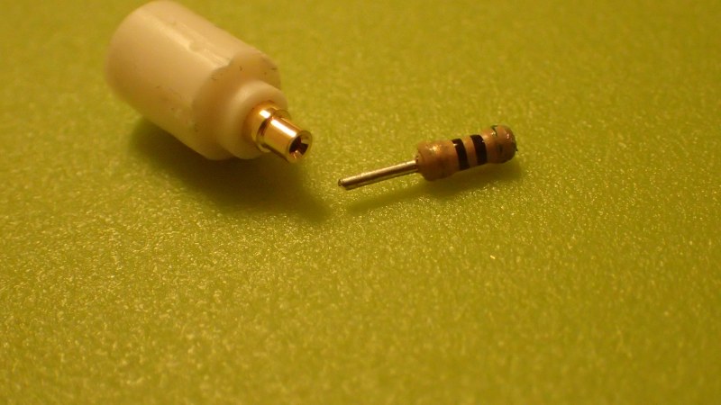

« Reply #22 on: April 29, 2018, 05:31:36 PM »
Made a little extractor: aluminium bushing that slips over SMA and 1/4" 36 nut to pull SMA connector out.
Wonder if I can punch (press?) small tab washer type carrier that alows me to solder terminating resistors inside of the connector.
