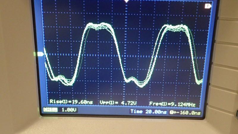

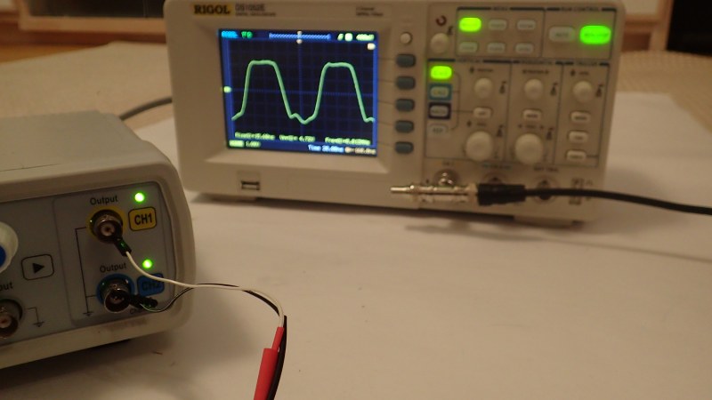

My signal generator sucks.
Need better buffer for TTL. Would something like this do? Sans oscilator

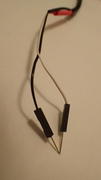

Testing small test probe, idea from here:
http://jahonen.kapsi.fi/Electronics/DIY%201k%20probe/
Put some pogos on dupont connectors. These will hook on normal pin strip and on most connectors.
