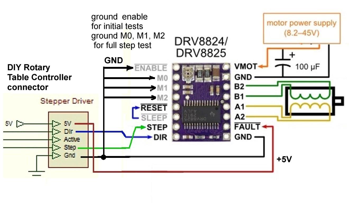

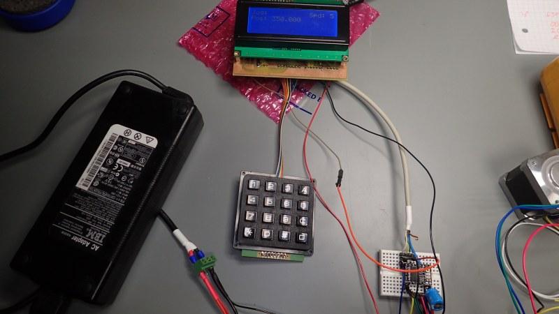

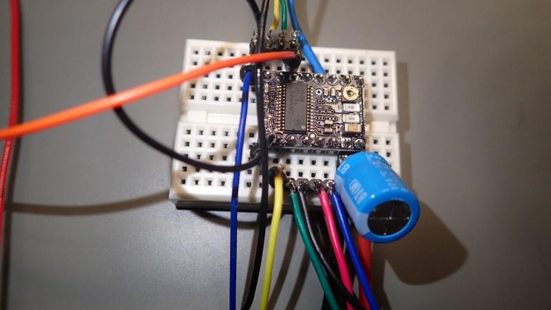

This indexer:
http://www.worldofward.com/rotarycontroller
Bought some years ago and finally got to order keypad and other parts.
Took a little time to fiqure out how to konnect the keypad. Layout was correct, but rows are inverted.
My problem is that the rotary controller seems to be working right and I can measure that all pulses comes out fine from it but the stepper motor does not rotate.
The stepper driver and motor are small, but I want to test the indexer completely, before I comit building the mechanics and rest of the system.
Pololu DRV8825 Stepper Motor Driver Carrier:
https://www.pololu.com/product/2133
This circuit:
https://a.pololu-files.com/picture/0J4232.600.png?f2f6269e0a80c41f0a5147915106aa55
The Ward rotary controller seemst to work fine. PSU for it is 12VDC galvanically separated switched mode powersupply. The linear regulator makes +5VDC. GND is connected to stepper controller GND.
The Pololu stepper controller receives +5V to RESET ja SLEEP pins.
FAULT-signaali is +5V all the time.
Motor current is adjusted to 1A:
PSU to stepper controller is repurposed laptop brick (16VDC/n.7A). Bulk capacitor is 100uF.
I haven't connected or disconnected anytjing with power on.
Nothing heats up, but the stepper bridge is floating, it does not feed the stepper, no matter what I do.
Am I doing something fundamenttaly wrong?

this is what I would do for my initial tests
once its working the stepper driver enable can be connected to Steves indexer
and the mode inputs M0 to M2 re wired to set the desired micro step

Thank you. Enable et.al. have pull-downs, but when I scoped them, I found some HF-componenet.
I ditched ungrounded PSU (12 volt one, that was feeding rotab indexer) and supply both of them from single 16V lap top PSU. That solved the problem.
Stepper is working now and I can shift my interest on mechanics. I need a bigger stepper and some bits to hook stepper on harmonic gear.

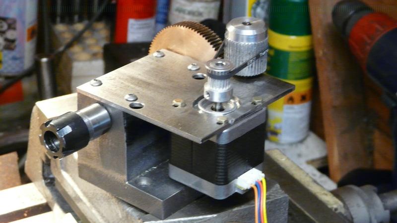

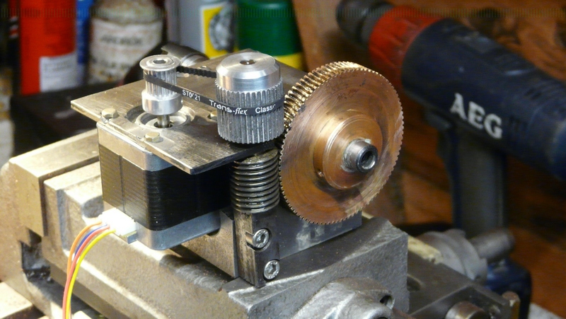

Insted of a larger motor you could gear down the drive , I have 100 steps per degree with a small motor .

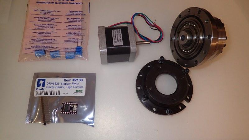

The gear I have is 1:50 harmonic drive. It has a coupling for 8 mm shaft, therefore I'm very much inclined to buy a stepper motor with 8 mm shaft and then stepper motor drive to suit.
I don't have a worm gear, but if I could find a worm wheel that clears 40 mm shaft and fitting screw I would fit that into lathe. I can think many ocasions that lathe chuck index would have been really nice to have.

The gear I have is 1:50 harmonic drive. It has a coupling for 8 mm shaft, therefore I'm very much inclined to buy a stepper motor with 8 mm shaft and then stepper motor drive to suit..............
Pekka,
I'm jealous of your 1:50 Harmonic Drive. My 4th axis uses a 1:200 Drive so, however fast I try to drive the stepper, it moves very slowly. With 1/8 microstepping it does give me 0.001125 degree resolution!

Made the worm and wheel , it's only ER16 collet chuck driven by Pllolu shield and Arduino .
Re: Ward indexer - Pololu DRV8825 Stepper Motor Driver
Can you elaborate bit more arduino/program and that Pololu hardware?

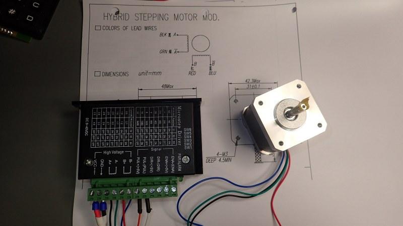

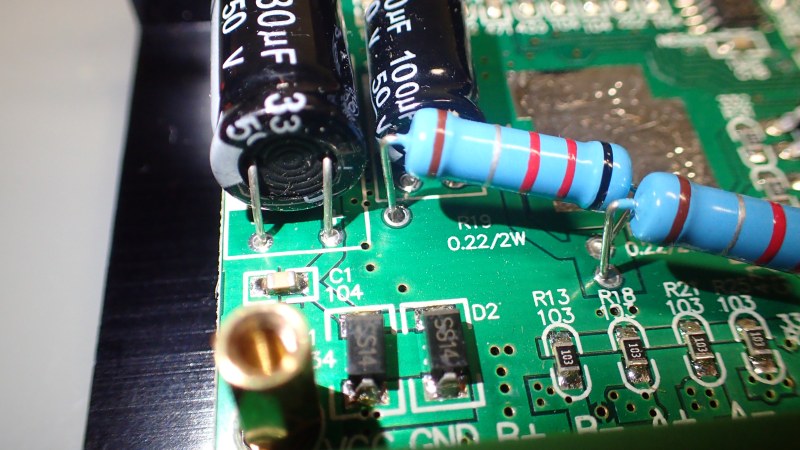

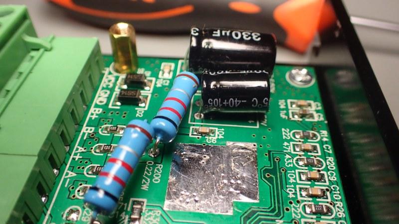

I got a Chinese driver from the mail and proceed to test that one.
Tehnical spesification claims it's perfect:
https://www.banggood.com/TB6600-Upgraded-Version-32-Segments-4A-42V-5786-Stepper-Motor-Driver-p-981997.html?rmmds=search&cur_warehouse=CN
But when I cross referenced the spesicication and TB67S109AFTG data sheet I noticed that word "upgrade" is very missleading and they have kept overly optimistic TB6600 numbers there to attract noob buyers. I don't even go trough the mistakes, it's all lies.
Anyway I got it, hookes it up to 16VDC/7A PSU and signal generator. Motor is NEMA 17 1,7A 200 step model.
Motor sound sick, moved erratically and hardly any moment on any mode. Also the motor current was all over the wall.
The front cover DIP settings have something wrong, I don't think same settings produce differet current limit.

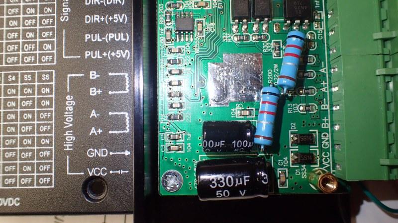

Also motor connection differes on PCB and cover.
Found that current sense resistors had cold solder on the other end and unsoldered from the other end. Also the capacitors were pretty much unsoldered.
Pretty sure it was completely untested.
