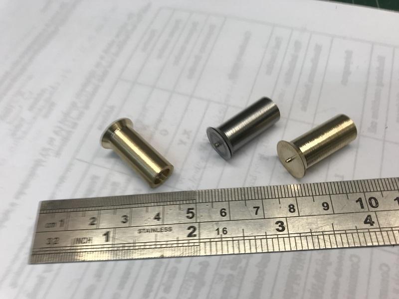

So this morning I actually made parts with the lathe :ddb: This bit is I presume supposed to be a countersunk rivet - it's made using the program running on the Youtube video I put up in a previous post - two in brass and one in steel. Watching it I reckon the feeds and speeds were intended for brass as although the steel part has a very good finish I cringed a bit as it was cutting !

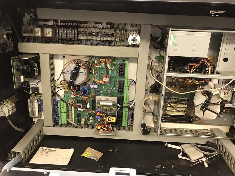

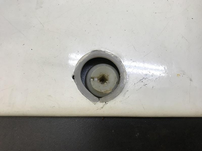

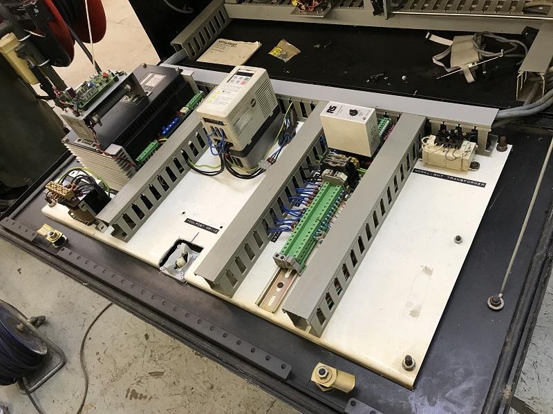

The power interlock for the electronics cabinet has been smashed - long square shaft from DIN rail isolator at the back of the cabinet should engage a door mounted handle, and has obviously been slammed shut a few times out of alignment smashing the external activator beyond repair - one on order should arrive Monday.
The open slot trunking in this cabinet is missing much of it's capping cover - again some should arrive Monday

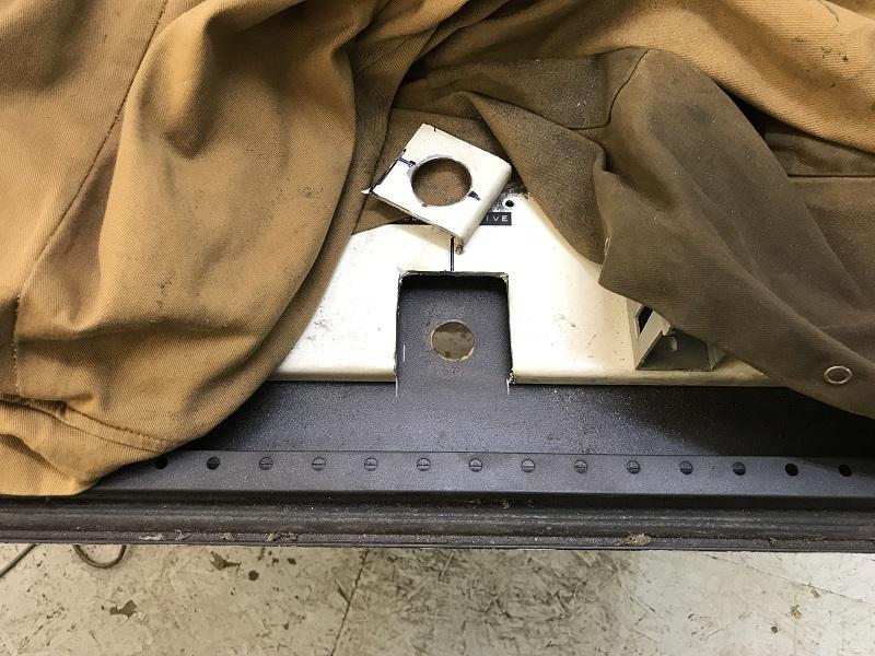

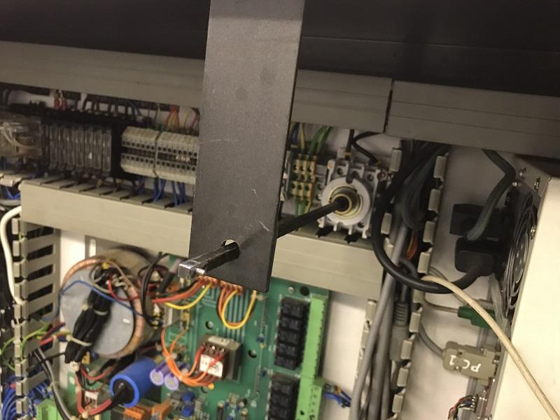

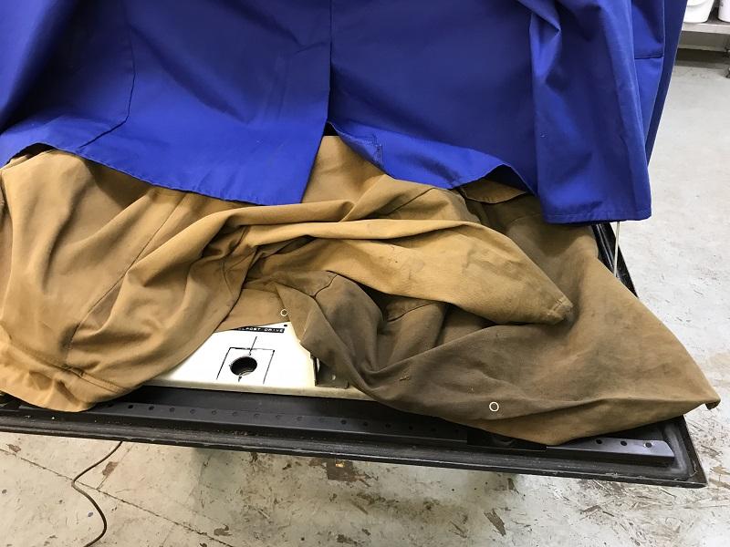

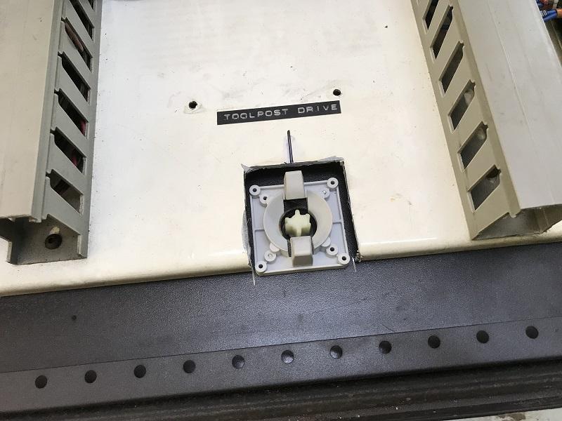

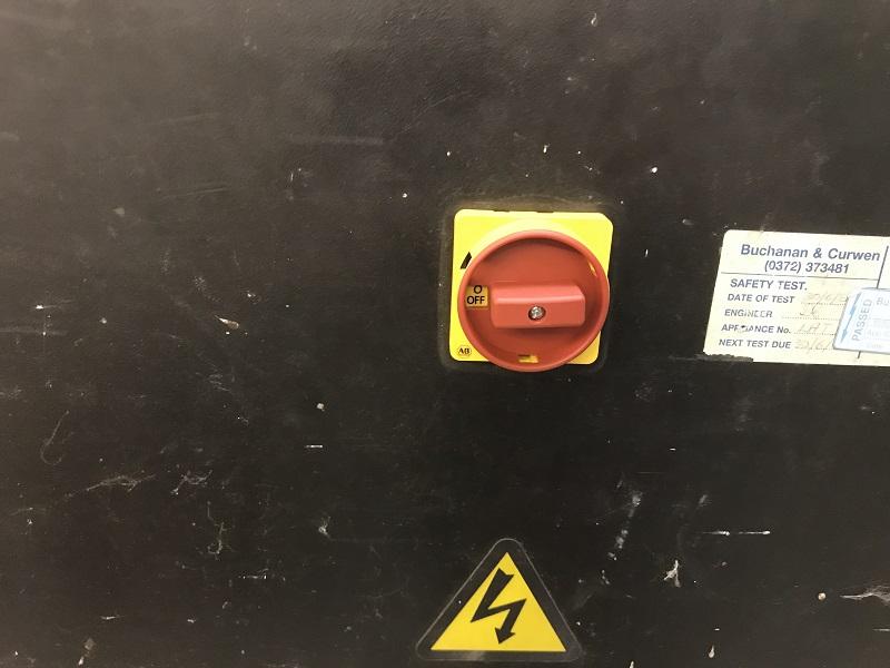

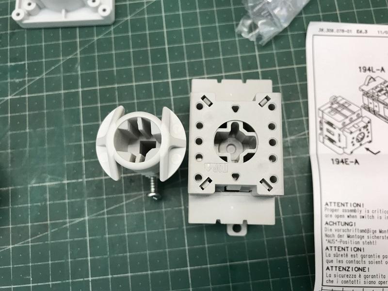

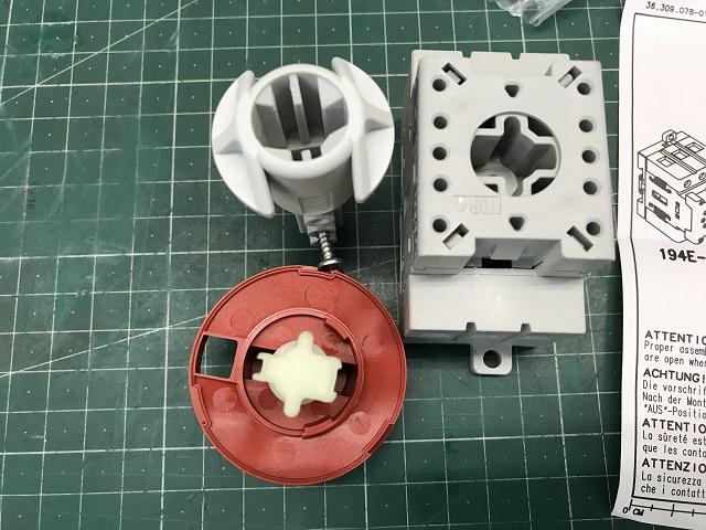

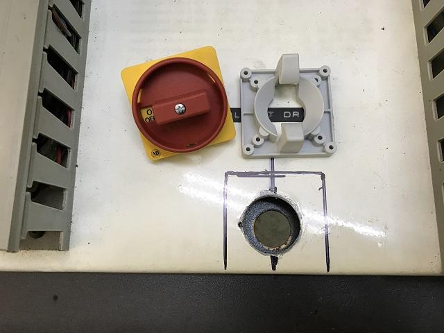

This morning Adrian the Parcel Force man delivered the new panel isolator switch from RS Components - though I sent him into a flurry when I told him there was supposed to be a second parcel with the trunking capping in it - probably come tomorrow.
Assembling the DIN rail isolator on the bench it was obvious that the extension rod and its fittings weren't quite right - one female plastic socket thingy had a pair of projections preventing the male sliding in. A quick call to their help desk revealed it was the wrong extension despite being referenced in the isolator illustration  :bang: Solution - another £25 for a different isolator OR a bit of vertical paring with a small wood chisel - I'll let you guess which I did  :lol:
As the rear panel on this machine is double skin and this switch assembly requires more hardware on the door than the previous one, I had to do a bit of butchery and cut a square hole for an escutcheon, then get it all lined up and the shaft cut to length. Got there in the end  :thumbup:

« Reply #34 on: February 12, 2018, 10:34:28 AM »
RS are sometimes a bit careless with the illustrations - often just a generic image rather than the actual part number you have called up.  If the data sheet isn't clear it can be pot luck what you end up ordering.

The trunking got delivered this morning, so I was able to steal it's capping and make good the missing bits that have been lost over the years.
