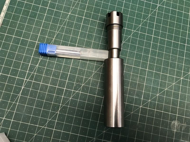

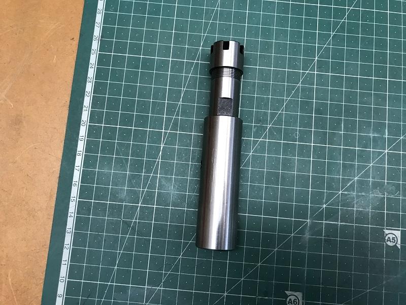

Will, I got these ER16 floating tap holders from Aliexpress:
https://www.aliexpress.com/item/SL25-WER216-80L-Floating-straight-shank-tapping-collet-chuck-and-tapping-holder-for-lathe/32442849161.html

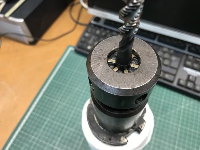

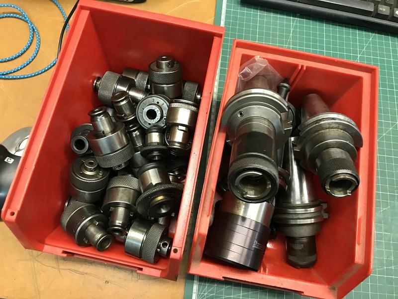

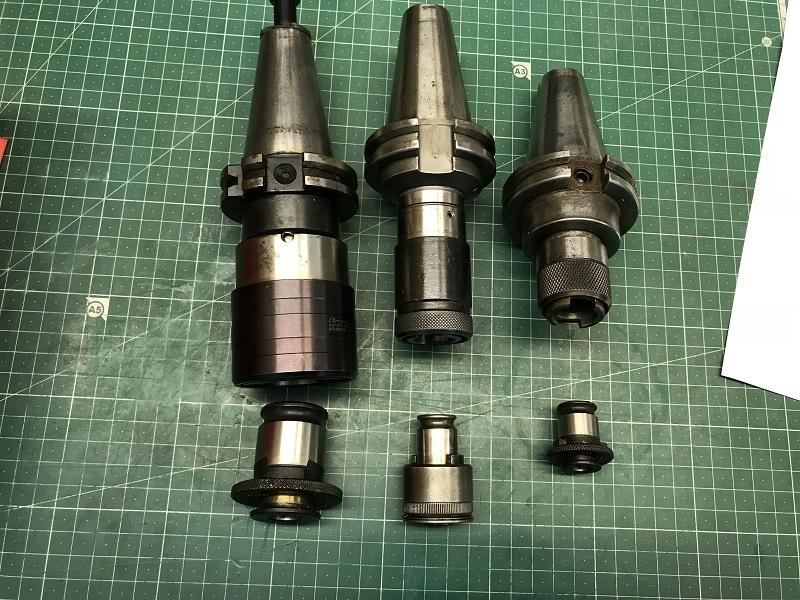

However I prefer to use Bilz style tap holders on the native Cat40 shank for my CNC Mill. Bilz floating tapping heads all give movement in the Z axis as to per a normal floating tap holder, but also the inserts are available in a torque limiting version.
Any floating tapping head allows tapping on a machine not set up for 'rigid tapping', and gives a degree of safety from tap breakage. The torque limiting variety obviously allow for an even greater safety margin
