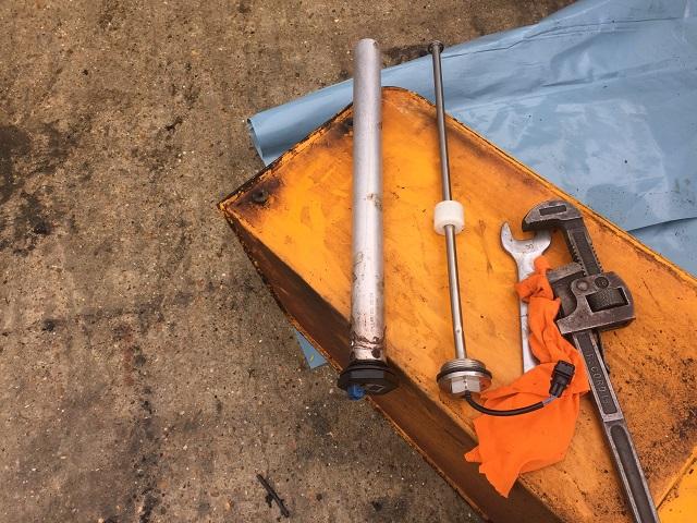

JCB 803 sender is a long thin tube giving a varying resistance so should fit i'd think but there must be many available in this  style

Right, now I see the problem, I have seen one with a float that rose vertically on a shaft, twisting the shaft as it went, and operating a variable resistor, what about a vertical tube with reed switches inside and a rising magnetic float. alternately, could you not take a tapping from the bottom of the tank and read pressure  as contents? I am intrigued, what sort of car?

the one i have removed is a magnetic float and 9 reed switches, just as you decribed... problem is 2 fold, the float is not as buoyant in fuel as it would be in water, so only just floats, and i suspect sink on harsh cornering, even though it is in a dip tube with small hole top and bottom
also 9 reed switches leaves gaps between them, there isnt physical room in the tube for more, and it is sometimes a few miles before i sees the first switch on the journey
the arduino that currently runs it, has damping programmed in for corners, but obviously isnt so good on first switch on...
its in a lotus 7 style kit, so is quite often subject to harsh cornering, hence the baffled tank
