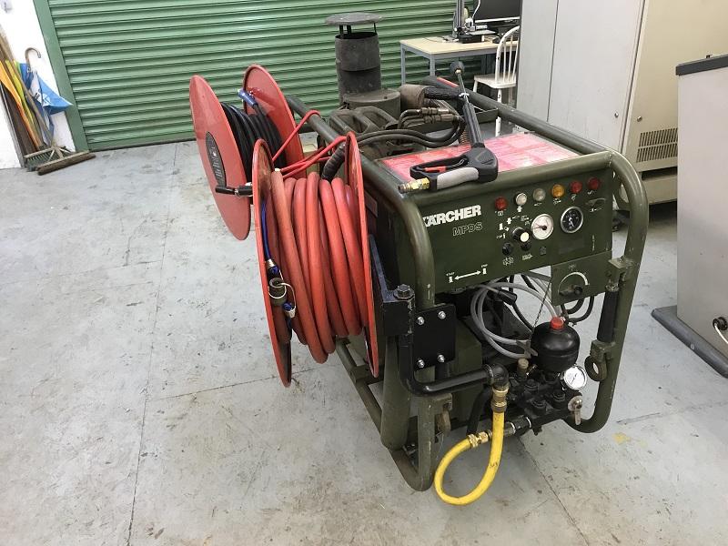

I've been rejuvenating the automatic water softening / de-calcification system on my Karcher MPDS steam cleaner.
It's probably worth pointing out that this is an ex-military 'Multi-Purpose-Decontamination-System' designed to clean vehicles and personnel after battlefield nuclear weapons had been used. Not much technical information about. However this bit of the design is relatively simple. A small tank holds a reservoir of dosing liquid that is dispensed via a solenoid valve into the 'suck' orifice of a venturi thence on into the machines pipe work. Solenoid valve is worked by a timing board pulsing it every minute or so. Built into the tank are a pair of electrodes used (presumably by conductivity) to warn of an empty tank.
So far so good - the electronics of the timer have been sorted, the tank repaired but what fluid to use? Obviously it needs to shift limescale, so something like citric acid or phosphoric acid would fit the bill. Saturated solutions of citric acid are insufficiently conductive for the sensing but 40% phosphoric acid works ok.
However what is it supposed to use? I have a Nato stock number for the correct stuff but no details.
It seems that the MPDS evolved from the HDS 1000 DE and it's manual stated Karcher RM110 fluid FOR WHICH THERE IS AN MSDS SHEET  :ddb:
The MSDS sheet says it contains  hydrochloric acid 1-3%  and sodium hydroxide 5-8% with a pH of 7.0-7.5
Now as far as I remember my school chemistry here we have an acid and a base being mixed producing a salt plus water with a pretty much neutral pH
so what is the resultant chemical ????

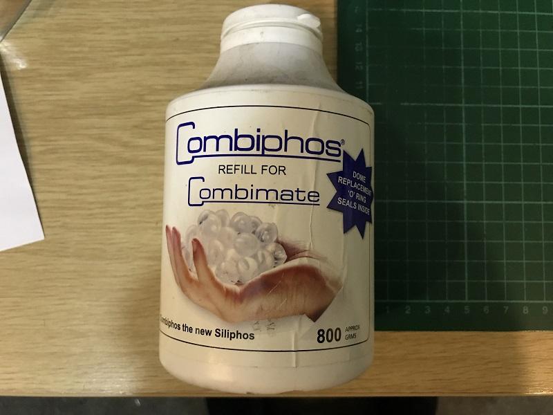

I just remembered that the entire water system in our holiday cottages has a ' Combimate' softening system where all the water passes though a chamber containing spheres of 'Combiphos' which gradually dissolve and have to be replaced - looking at my bottle of spare spheres lead me to the manufacturers web site:
http://www.combimate.co.uk/what-is-combiphos.html
So here is another total loss (ie cannot be regenerated) water softening system (*) that is perhaps in some way similar to the Karcher one  :scratch:
(* strictly speaking it's NOT softening the water but preventing the calcium being deposited )

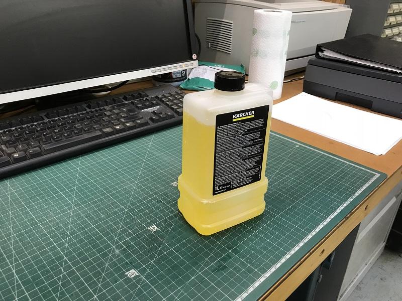

Well amazingly some RM110 Karcher water softener fluid has turned up on eBay. This is the stuff recommended for the MPDS precursor the  HDS 1000 DE :thumbup:
I shall order some and try it for conductivity :coffee:

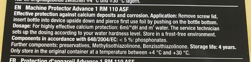

That's interesting...it says no phosphates...and the stuff I keep on bumping on this total loss system is hexametaphosphate. Like here:

But the karcher stuff is phosphate free...There may be different chemical systems, I could ask my friend. He used to work with power plants ans he is now in a company that makes water treatment systems for ships. Scale problems with boilers should be pretty analogous to this hot water washer heater - I think.
So, is it possple that karcher pump or boiler materials don't like phosphates? That leaves two more options: Polyelectrolytes and chelatants.

Yes Pekka, the phosphate free bit was the first thing that struck me.
I've no doubt this stuff will work in the sense that if introduced into the water it will prevent calcium deposits. What I don't know is if it's electrical conductivity will be sufficient to pass enough current between the sensor electrodes that detect an empty tank (no current flow between electrodes). The electronic valve timer module is inhibited if an empty tank is detected.
A quick test will soon show though  :clap:

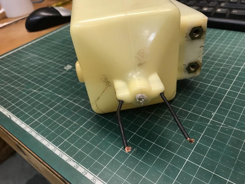

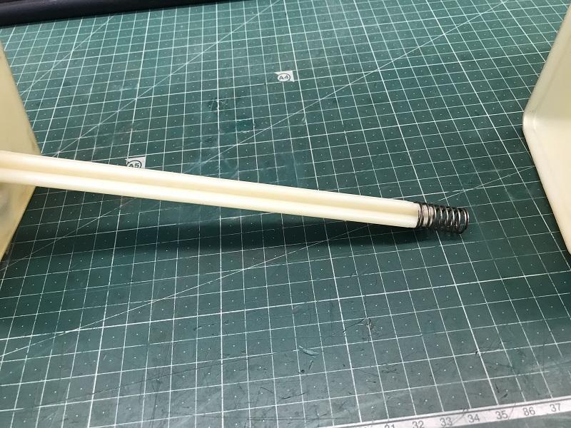

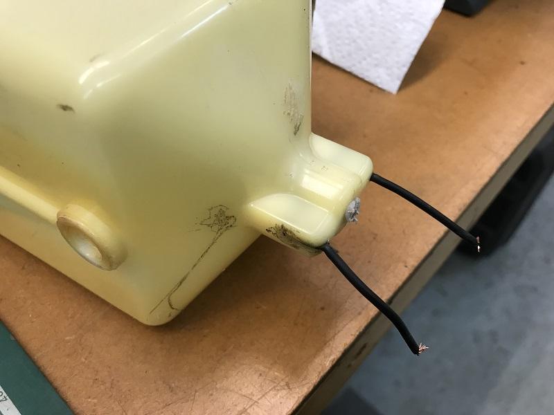

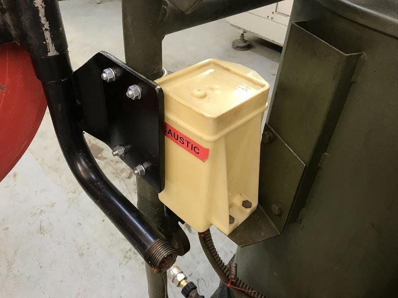

So now the photo issue on the forum is solved I'm uploading a few images of what I've been up to:
Firstly the de-calcifying tank and it's odd sensor electrode set up.
The tank had a broken outlet spigot that I repaired by turning one up from plastic and super gluing it in place. Right sat the bottom of the tank are two electrodes embedded in the plastic of the tank and looking possibly to be carbon, but they are pretty well un-get-at-able  :bang:

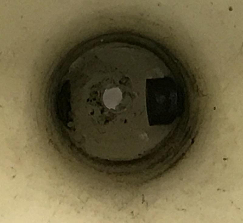

The lid of the tank has a long plastic column pointing downwards with a spring on the bottom that shorts the electrodes (Shorted electrodes means 'tank has contents' to the electronics) This spring really confused me, as I could see no way the electrodes could be used for sensing - something MUST be missing. But no, it turns out that the spring is there for initial delivery tests to inhibit the flashing 'low fluid' light - there is a moulded set of German text on the lid that Google Translate tell me is 'remove spring on initial filling'  :bang:
So the previous discussion 'up thread' about conductive liquids may now make more sense to people ?
Well this morning the Postman brought the bottle of RM-110 de-calcifying fluid specified for the earlier version of this steam cleaner - will it's conductivity be sufficient ......... in simple term YES  :ddb:
I temporarily wired the control electronics to 12v to avoid having to run the engine indoors - proved that the warning light flashed when the tank was empty and had no spring shorting the electrodes. Repeated the exercise with the lid and spring which stopped the flashing light, then removed the lid and spring (making the light flash) and poured in a tiny amount of the fluid - just enough to fill the well round the electrodes, and guess what - the flashing light was extinguished and the control valve was activated about every minute or so. All as should be.
Not surprisingly there is electrolysis going on between the sensing electrodes with bubbles (of probably hydrogen and oxygen ???) rising to the surface and indeed this may explain why one electrode is very much shorter than the other. I suppose long term it is feasible to drill out the electrodes and re-glue new ones in, and if I get to that stage their composition should become obvious

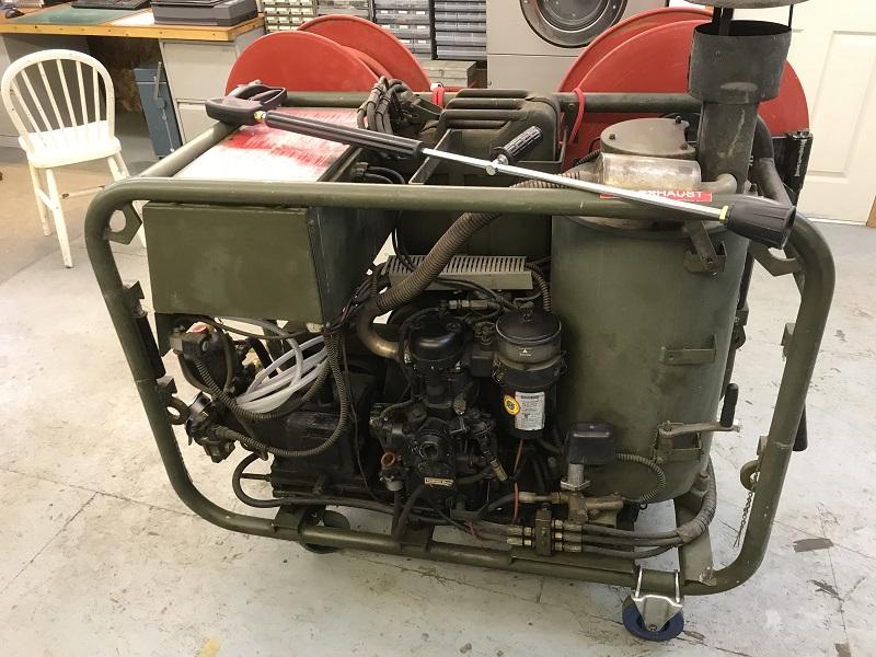

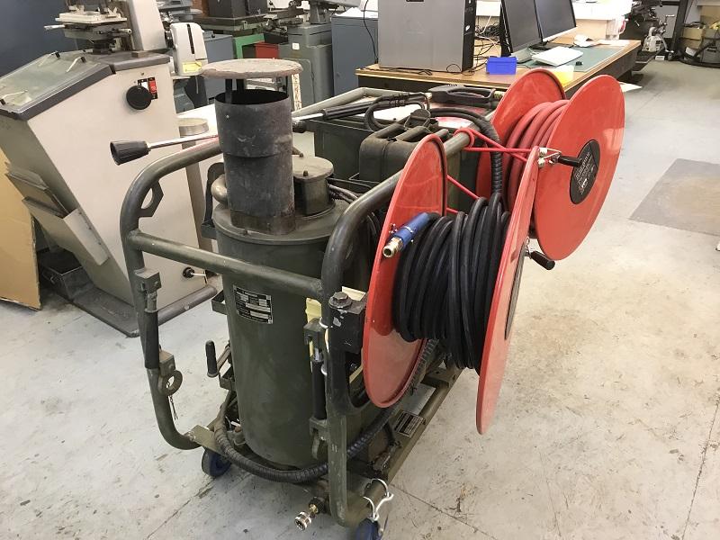

While the MPDS was in the workshop I fixed castors to it's frame so more easily to be able to move it about - oddly in the front lower frame are pre-drilled holes for standard castors, but there was no provision at all  at the rear. Pipe clamps round the chassis frame proved up to the task with slight modification to the hole spacing of the castors.
I had had the pipe clamps in stock for best part of a year, as they were bought to fix  redundant fire hose reels to the framework for feed water and pressure hose. The rolling up of stiff pressure pipe at the end of a cleaning session had always been a chore as it fights back all the way !
So again - whilst in the workshop fix those reels :clap:
It proved relatively easy. The feed water which is only at water main pressure could run though the original reel rotary joint and hence be permanently fixed to the machine. However the  high pressure hose had to have quick disconnect fittings to be done / undone each session, as the high pressure and temperature would easily  spell it's doom :bugeye:
