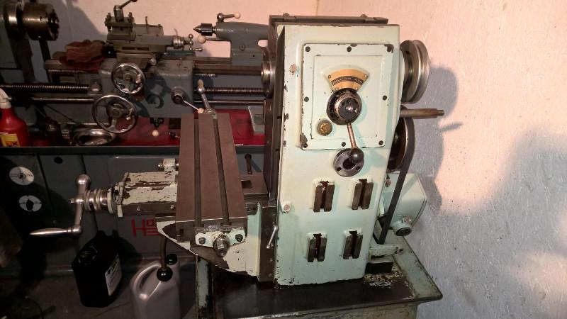

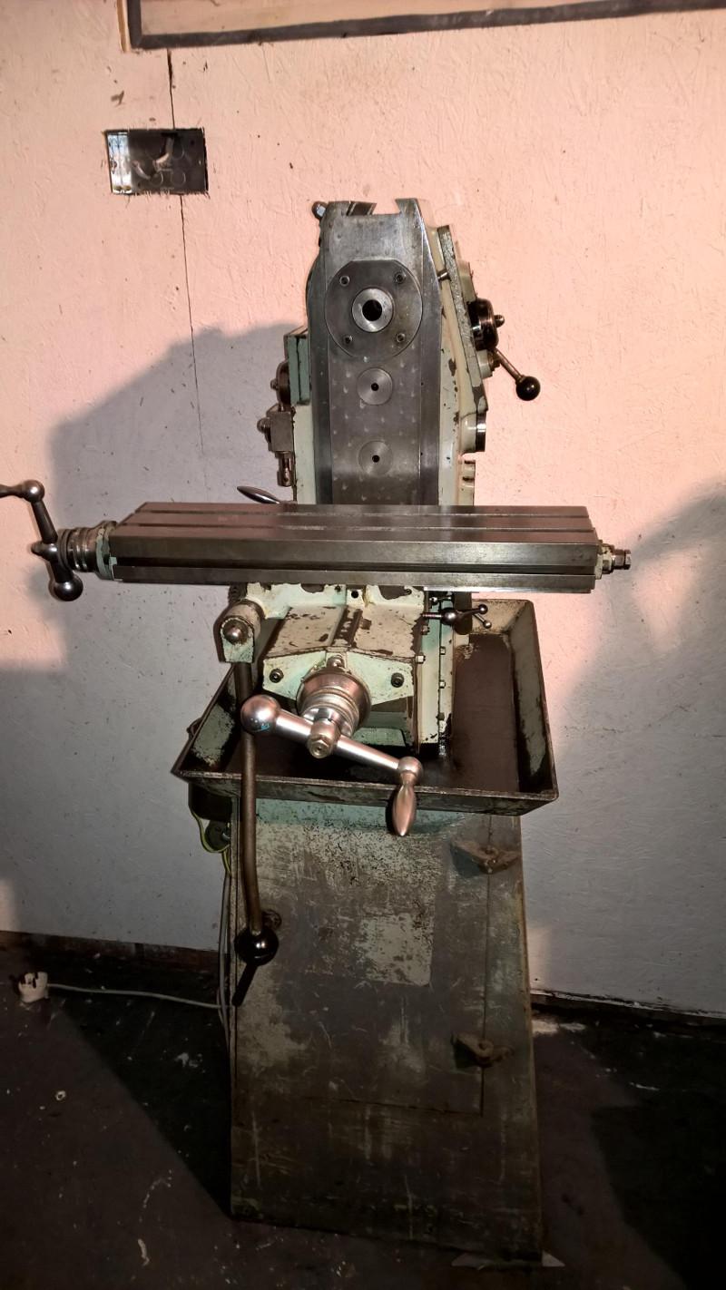

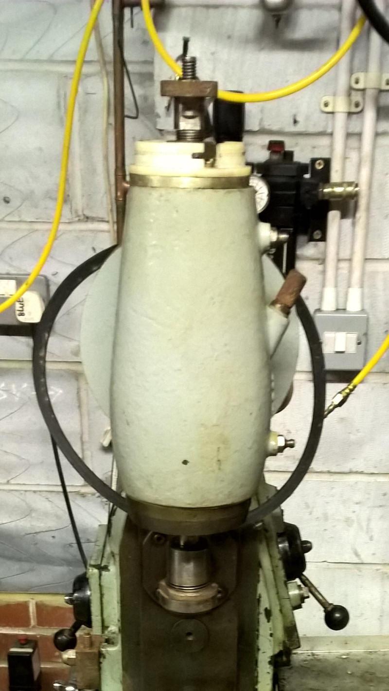

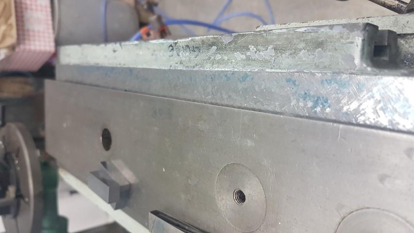

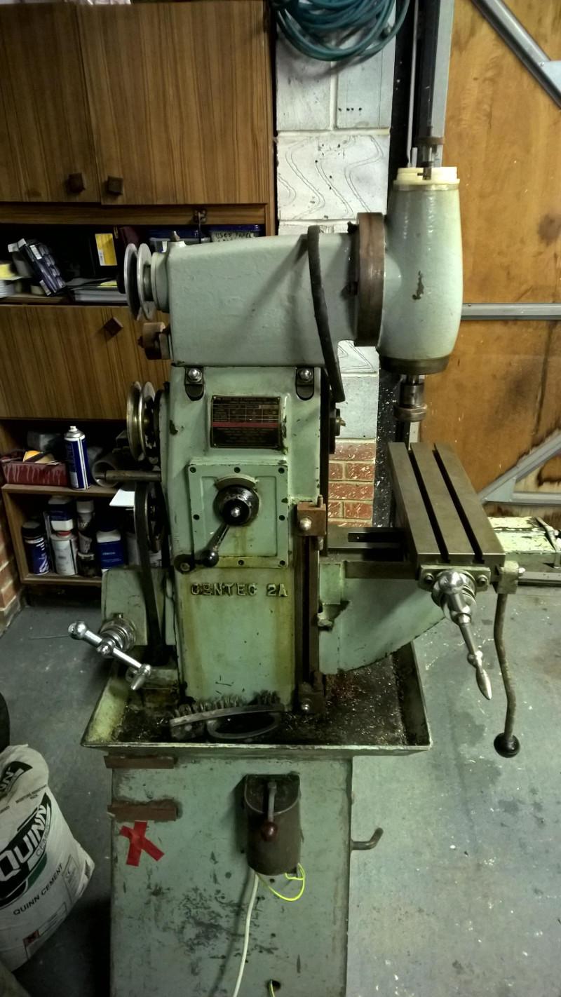

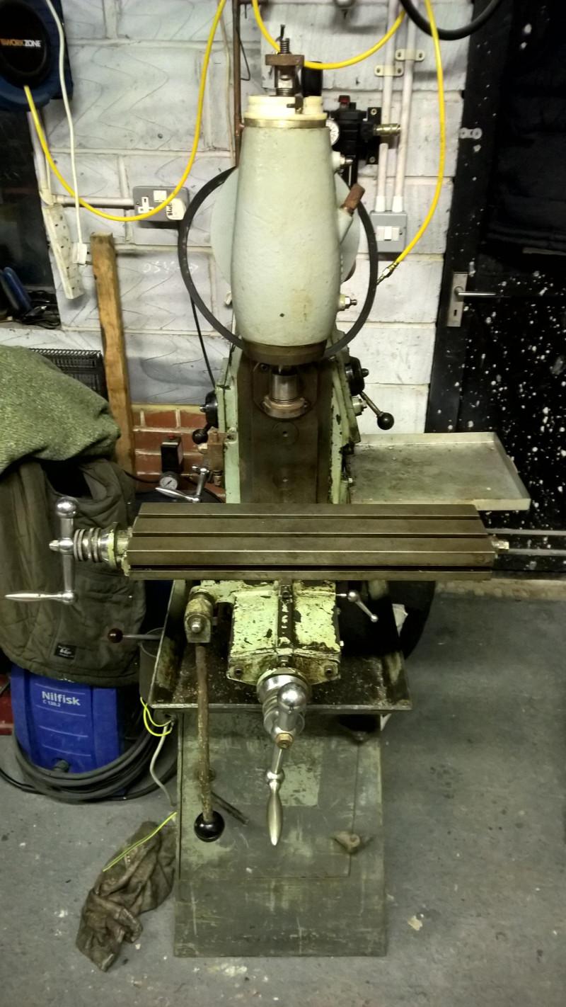

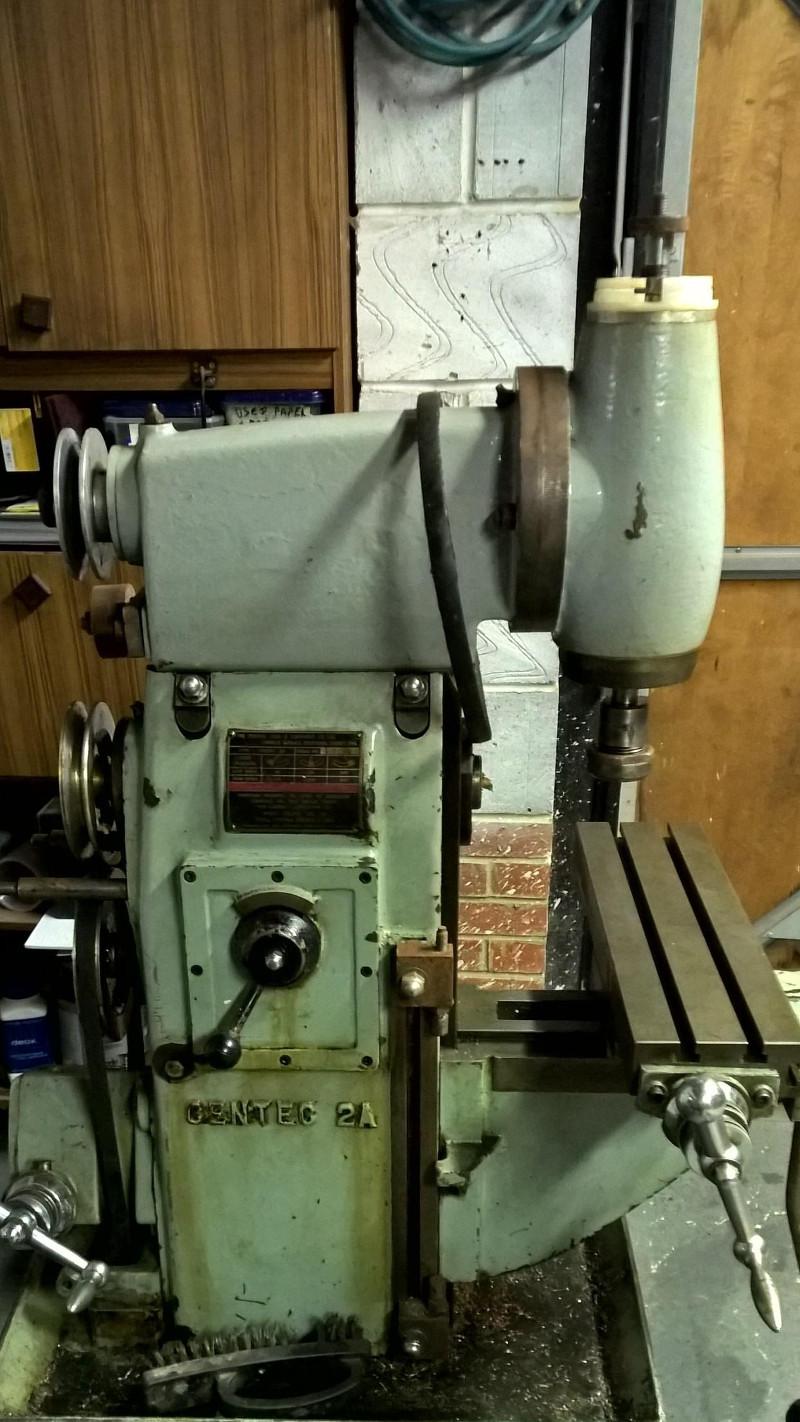

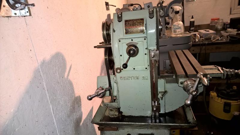

So after taking the Richard King scraping course a few weeks back I intend to continue the refurbishment of the Centec partly to get it running nice, but also partly as practice before attempting to rebuild the Beaver VBRP I have in pieces for the last 2 years :D
Just as  bit of history, I bought the Centec locally a few years back, it was in decent condition but as I have started to learn how to use it I have found it has a lot of slop in the table especially and if you try to take this out with the gibs it binds at each end of travel.
So, as it is a sensible size it also seemed a fair contender for a "project"  :thumbup:
Below are a few pics of what it looked like when I picked it up and a couple with it in its new home.

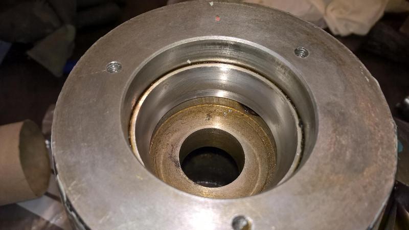

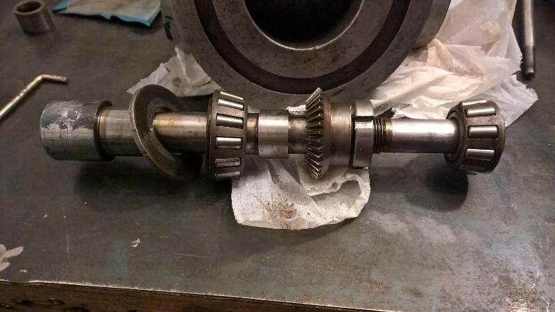

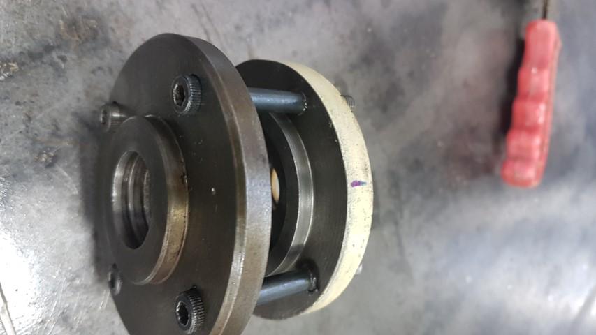

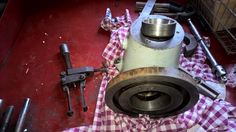

Just as a bit of history the first job I did was to replace the tapered bearings on the shaft in the vertical head. There was a fair bit of run out and, although I am still not convinced it is good as it should be, it is better than it was.
There is very little info on the web about the inner workings of these machines that I can find apart from a Yahoo Group, but navigating the Yahoo UI is soooooo painful I tend not to frequent that gathering.

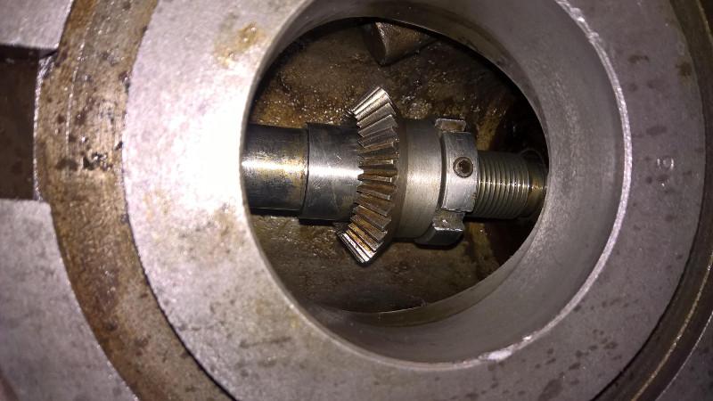

So just for posterity sake, a brief overview of how to overhaul the head is as follows (from what I can remember :bugeye:)
The vertical head mounts where the horizontal mill overarm normally goes and is driven by belt of the horizontal arbour pulley. It rotates to allow milling at angles and has a MT2 taper as per pic 1 & 2 below.
The shaft sits in two taper roller bearings at the top and bottom and is driven from a bezel gear off the pulley shaft. The bottom of the head has a plate held in by 3 screws, remove this and you expose the lower bearing. Pic 3
The shaft also has a preload arrangement for the bevel gear pic 4. Having removed the head from its mounting you can loosen this off and then I used a hydraulic press to push the shaft downwards and out of the top bearing. Removing the bearings and cups was then just a case of using the press and various bearing pullers I had in the auto shop.
With everything stripped I could then look at the bearings involved.

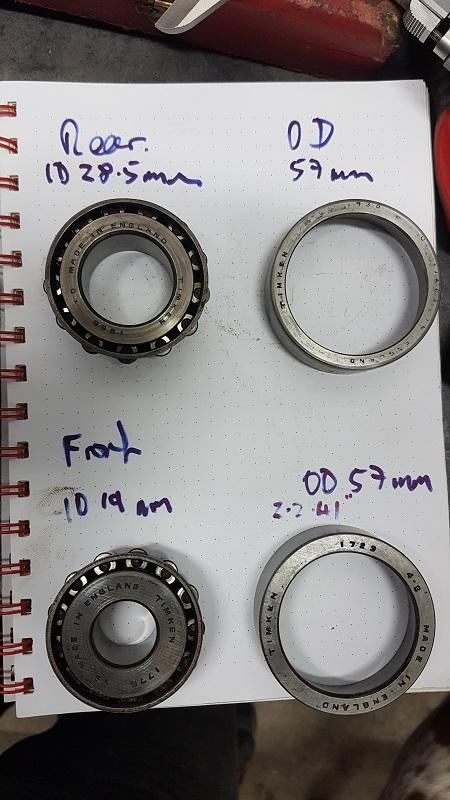

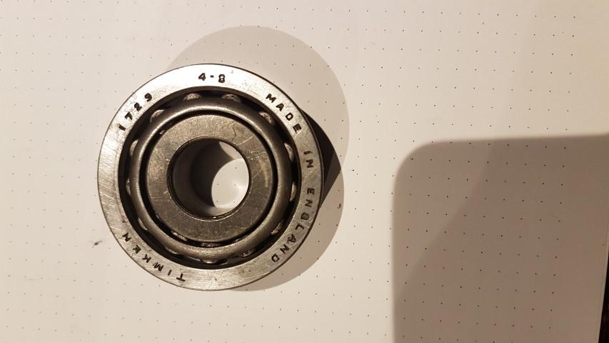

Will try to do that Andrew, don't suppose there is a quick way other than editing every individual picture?

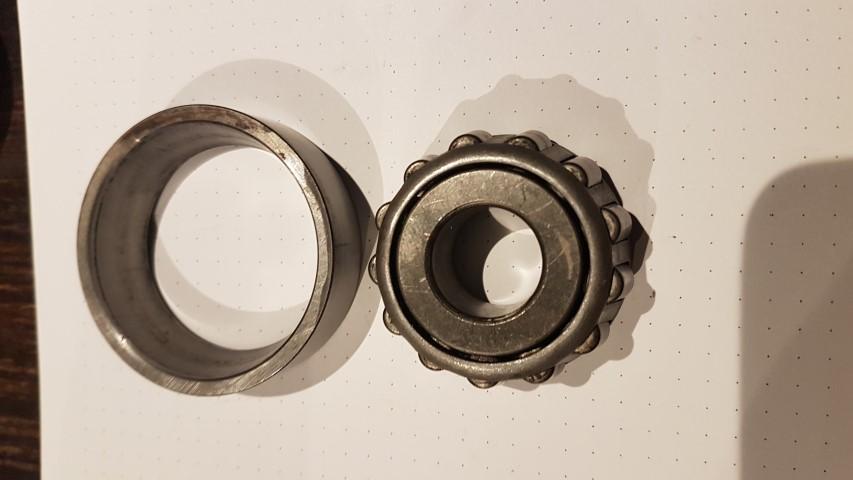

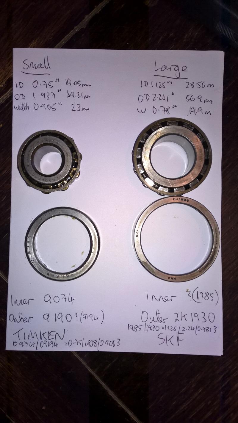

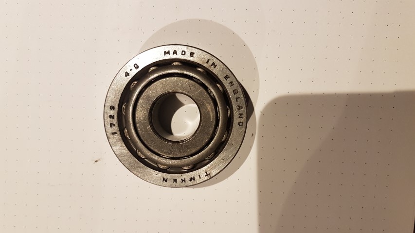

Back to Centec, the pic below gives the specs of the bearings that came out - useful to know as I couldn't find this info anywhere on the web.
Ordered up replacements, but I know understand there may be different "grades" of bearing with high precision bearings needed for these sort of applications ?  :bang:
Anyone able to tell from these bearings what standard they are? Couldn't see any other options when I bought the replacements.

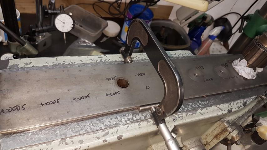

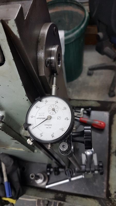

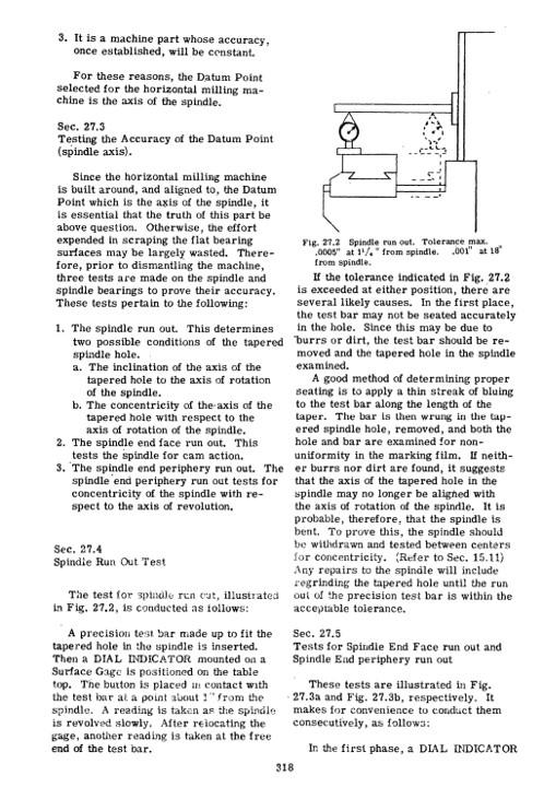

So prior to starting to scrape stuff I looked up Connelly and a few posts on here. First job was to check the true ness of a datum point, namely the horizontal arbour, so you can then use this to set the knee flat to the shaft.
I have included the relevant pages as attachments below but basically you are checking for run out on the spindle end face, what I would call "end float" on the spindle (in/out movement) and then run out at various projections from the spindle.
The bad news was that although my spindle run out with "no load" was only about 1 thou, when any side load was applied it was up to 7 thou and the end float when applying load (pushing/pulling the pulley) was 10 thou.
This was with the bearing pre load way higher than I would like so I think the bearings are knackered  :Doh:
So before I can start scraping in the ways I need to get some new bearings ordered. Pulled the old ones out which are Timken and interestingly marked as "Precision 5" - so I guess I have answered my own question about precision bearings being used in these machines.

The worst radial runout I see for precision inch taper bearings is .0003" page 25.

The cups look "ok" but not spectacular but the inner races feel very sloppy to me. The other thing I noticed which I have tried to show in the assembled pics below is that the inner race is not concentric with the outer. If you look at pic 1 you can see that the gap between the inner sleeve and  and the cage is less at 6 o'clock than 12 o'clock. In pic 2 I have rotated the cage and now the gap is less at 12 o'clock than 6. I may be missing something but doesn't that mean the bearings will run eccentric or do they only centre under load?

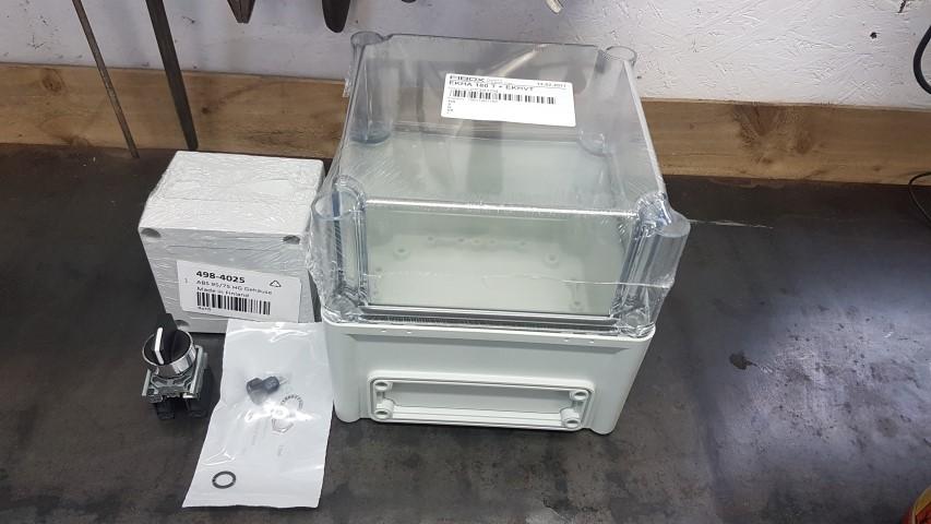

SLow progress so I have started swopping out the single phase motor for a 3 phase and VFD  :D
More on that later.

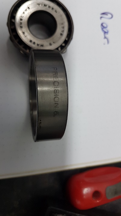

 I also had a bit of faffing about to get the bearings set up . The rear bearing was my problem,the bore for the bearing shell was in my opinion too tight of a fit to allow proper adjustment of the the bearings .
This is what I fitted to my Centec 2
Timken
Outer 1930 2-0
Inner 1985 1-6
Outer 1729 1-6
Inner 1775 4-6
Offline mm289

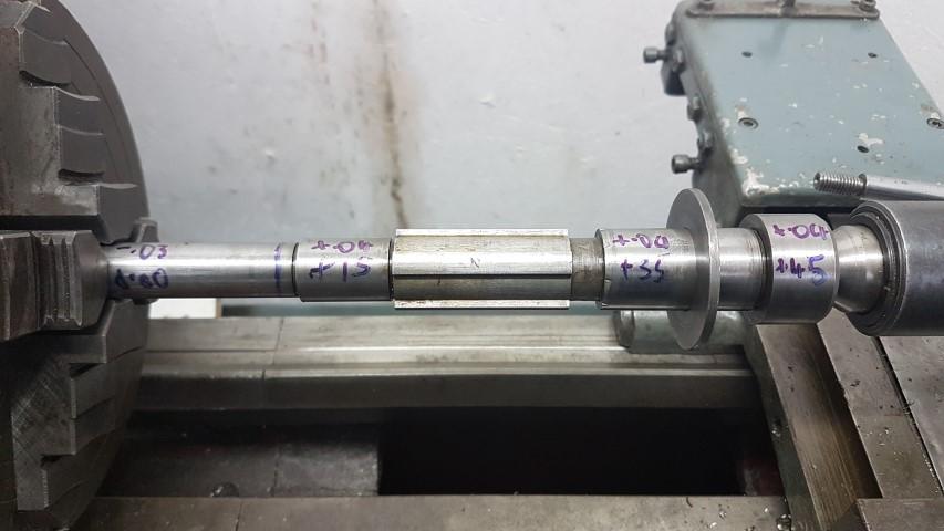

For the sake of anyone trying to do the same thing, or if you enjoy a Friday night read, the long story is as follows.........grab a cuppa  :coffee:
Had a long chat with Pete this morning and in amongst other ramblings the discussion got round to how it would be almost impossible for a set of taper roller bearings to be so far out unless they were literally falling apart - which mine weren't. I was all for just slapping a new set in and getting on with doing some scraping, but Pete got me thinking so I went back to basics. :scratch:

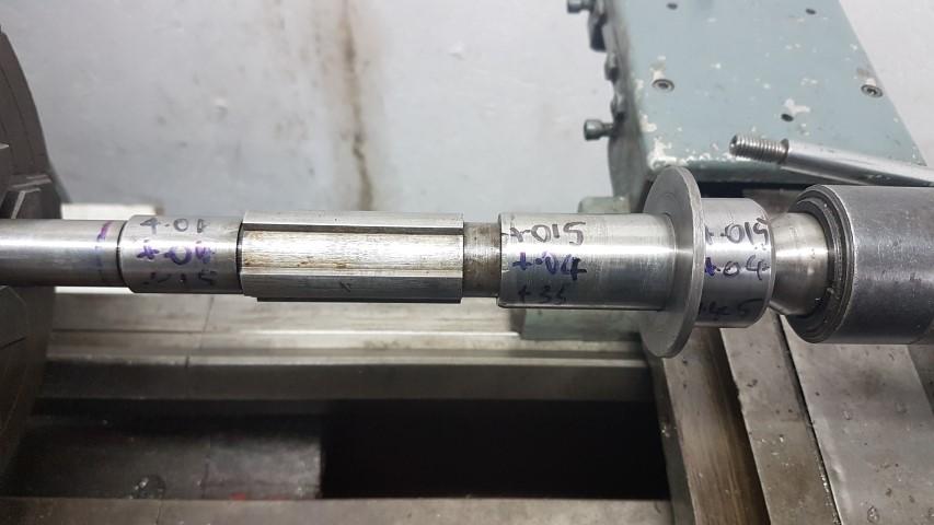

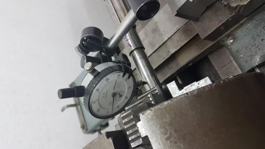

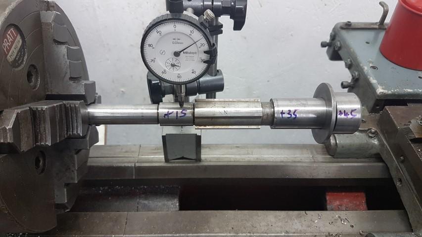

First off - eliminate the spindle as a source of error i.e. is it straight? So over to the lathe which I had helpfully just taken the 4 jaw off and replaced with the 3 jaw yesterday  :doh: so swapped the 4 jaw back again (which is mahoosive, note to self must get smaller 4 jaw chuck  :palm:). So en route to setting up the spindle it gave me a chance to strip and clean the 4 jaw which i hadn't done since aquiring the lathe 18 months ago!
45 mins later... got the chuck set up and popped the spindle into the chuck then centred it. At first look I had a bit of a panic as it looked like the spindle had .45mm runout from one end to the other - bugger I thought - bent spindle (pic 1)  :bang: At this point I will claim some sympathy for being a bell end as I haven't got any formal machinist or engineering background  :bugeye: - obviously it would help when taking these sort of measurements if you had the other end of the spindle supported as well  :doh:
So ran a live centre into the nose of the spindle and ran the tests again..... much better - runout down to  +.04mm. Checked at the chuck end and the runout was -.03 though which seemed a bit odd. (Pic 2,3 & 4).
Initially I had the spindle gripped in the chuck near its end, so I moved the spindle in to where the rear bearings would sit and re did the test (again). Bingo - runout reduced to between .01mm and .015mm (4 to 8 tenths) which is good enough for me. (pic 5)
My conclusion being, the spindle between bearings is running true but is slightly bent between the rear bearing and the end of the shaft (where the pulley sits). Possibly only about .04mm or 2 thou so I am going to ignore it for now and press on  :clap:
More to follow...... just grabbing some grub!

SO having convinced myself the spindle was OK back to re-assembly. Old bearings were dropped in some Jizer for a while to get them as clean as possible, meanwhile man from Royal Mail arrived with my RS Components delivery of an enclosure, 3 way switch and potentiometer to tidy up the 3 phase motor and VFD upgrade I am doing (more of that later  :thumbup:)
So the way the spindle bearings are mounted is they are situated in the casting and held on each side by a retaining plate/cover. This is bolted together with 4 bolts - but it became apparent that when these were machined they must have been done in situ or as matched pairs. Reason for saying this is on mine at least, they would only bolt up in one orientation, the bolts would bind as they went into the covers otherwise, so both sets were test assembled to find the "best" fit then centre punched to mark orientation (pic 2)
I then drove the bearing cups into the case so they butted up against where the retaining plate would sit and reassembled the shaft with dry bearings. I just did the front bearing first and was puzzled that as I tightened up the retaining plate on the front of the knee the bearing became tight to the point of stopping the shaft moving. :scratch: AT first I thought it was pulling in crooked and binding on the nose of the shaft so despite having aligned the plate/cover I tried all 4 possible orientations but still had the same problem.
Eventually I engaged brain and broke out the depth gauge. Now this is going to be hard to explain without a diagram - and your not getting one of those!! :bugeye: - but, it seems that if the bearing cup is driven in flush with the retaining plate (which sits inside the case) then when you tighten up the cover it effectively preloads the bearing to the point of clamping it. This is because the cover has a flange which will press on the bearing cage. To fix this I drove the cup in further so as to give me 1mm clearance between the cover and the bearing.

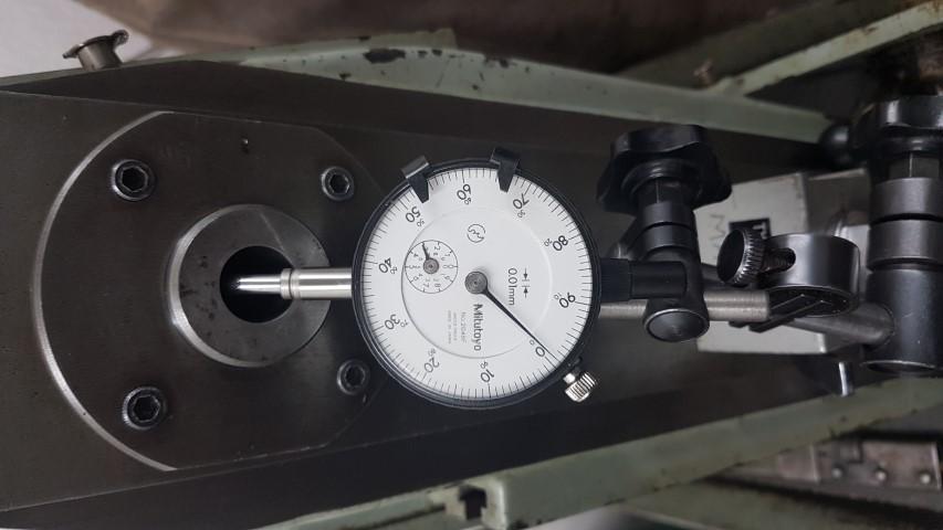

SO all tightened up nicely and shaft rotating freely. Repeated process on the rear and exactly the same problem! Again pushed the cup in a bot further and the bearing ran freely.

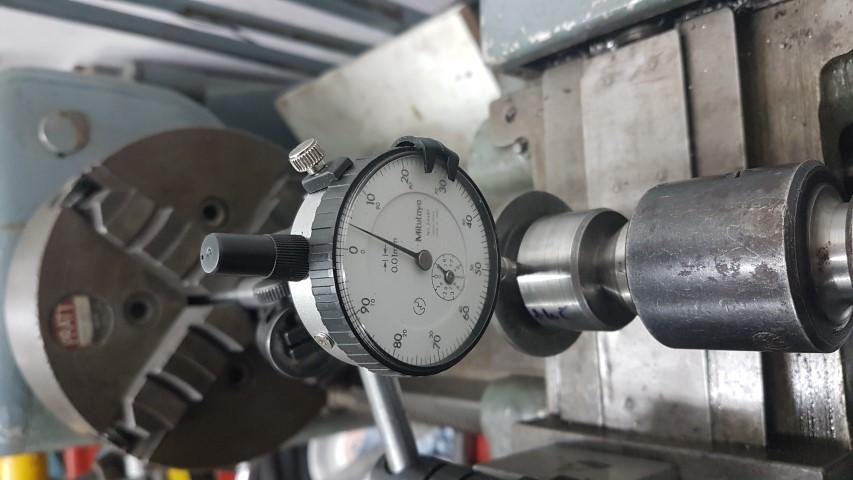

Moment of truth... wound in a small amount of preload (1/8th turn) and put the Dial Gauge on the nose and..... 0.015mm runout  :) :)

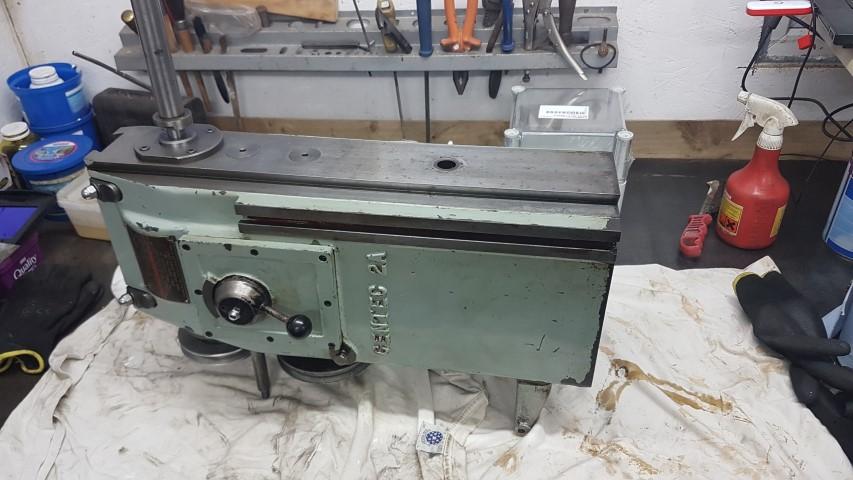

Rebuilt the spindle again having lightly packed with the NGLI 3 bearing grease (Pic 3) equivalent of the original Centec recommended lubricant and then ran a series of tests at different pre loads as per Pic 4.
Result, finished spindle showing only 0.015mm runout at nose and when under load only deflecting 0.006mm (~3 tenths). Also end float is now zero. I then measured runout in the taper rather than on the nose (as suggested earlier) and it reduced to 0.01mm.
RESULT  :beer: :ddb: :ddb: :ddb:
SO bearings were OK (thanks Pete  :headbang:) - I can only think that somehow the cups had got moved around that that whilst I was winding in pre load on the shaft it wasn't actually loading the bearings hence why I was getting so much movement in my original test. Anyway, now I have done this I can move onto setting up for measuring and scraping ( a day(or 4 ) later than planned  :doh:

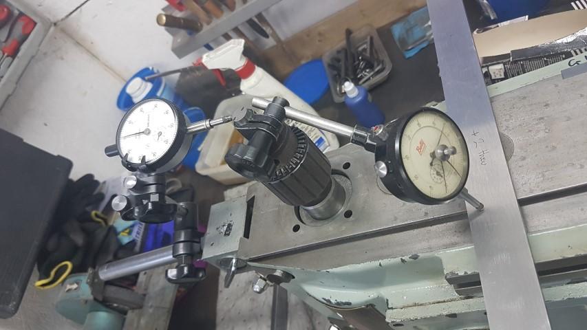

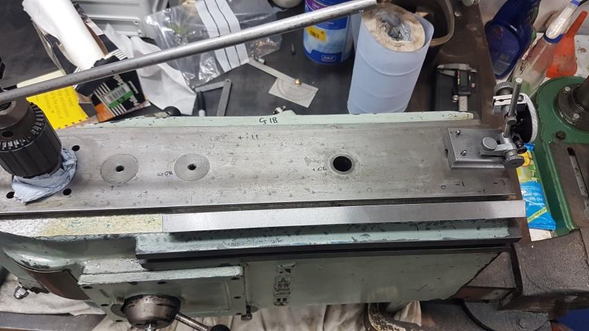

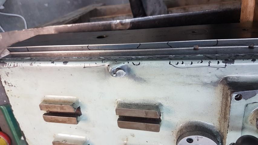

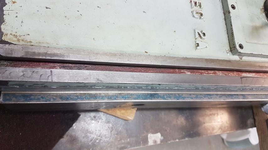

Offline mm289
  • Posts: 27
Re: Centec 2A Rebuild

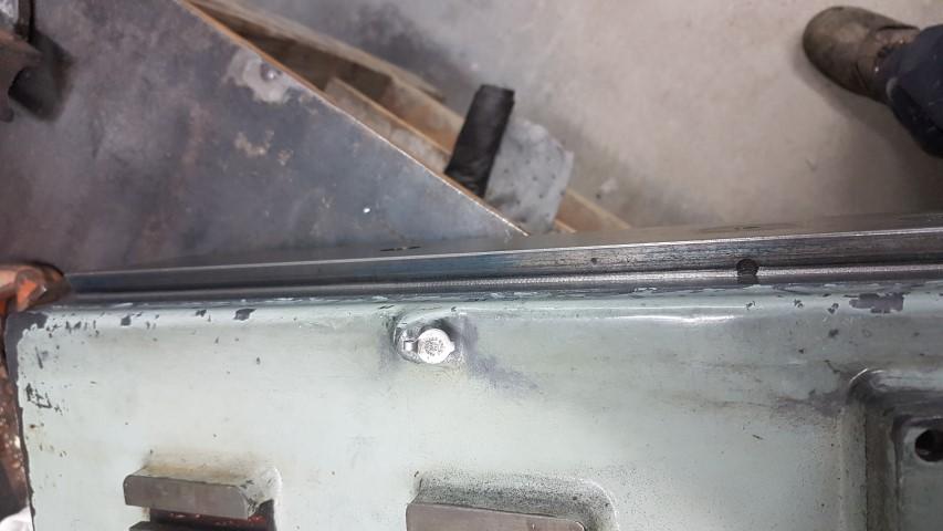

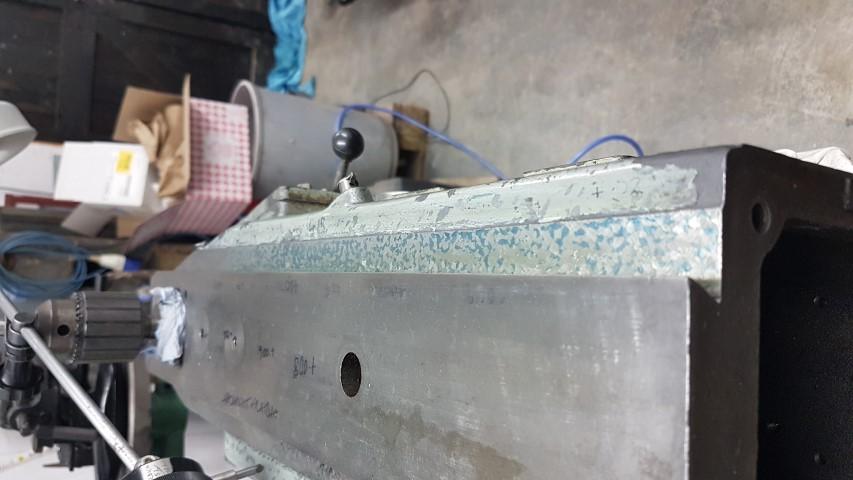

« Reply #19 on: December 29, 2017, 06:07:39 PM »

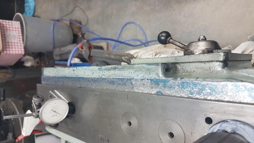

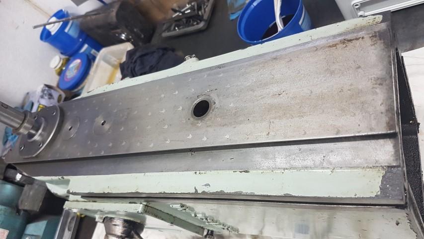

Have now removed the knee from the base and setup on workbench to make scraping easier.
In doing so I have discovered a few things:
1. The horizontal arbour when mounted in the overarm is uber accurate, only .01mm of runout at the far end of the arbour which is 6" from the nose of the shaft  :thumbup:
2. My clarkson collet chuck is pants  :bang: the chuck body gives about .02mm runout but when I mount a straight bar in it it is giving me .07mm run out, got the same result mounting it in the 4 jaw in the lathe so figure the chuck is rubbish.
3. My "spare" collet holder doesn't take any of my Clarkson collets (not sure what collets it needs  :doh:)
4. My Jacobs chuck on an MT2 taper is my most accurate work holder with a runout of only .03mm :( -
5. Trying to figure out how to check the alignment of the knee from the horizontal arbour when none of your workpiece holders are accurate is a PITA :hammer:
Oh well, tomorrow is another day  :D
Cheers,
Paul.
« Reply #20 on: December 30, 2017, 02:27:18 AM »
If I'm reading this right the cover pulls the bearing in flush with the outside edge but it has another mm to go before it stops against the seat? That would explain the results you were getting. You would have forever been adjusting the spindle until both cups were fully seated.
Glad you got that sorted.

Success!, you were lucky with the   horizontal arbor I had visions of it running out badly.

Pleased you got your bearings sorted Paul, also a very good description of your trials and tribulations.
Just one thing, when you mentioned you tried to mount a pice of round bar in your clarkson collet chuck.  If it’s an autolock type the tool needs a threaded shank to work. The nut does not tighten the collet but as the cutter screws into the collet during cutting, against the pin in the chuck body the collet is pushed downward against the nut. Self tightening the collet hence the name autolock.
Offline mm289
  • Posts: 27
« Reply #23 on: December 30, 2017, 06:34:48 PM »
Thanks for that Ross - that explains it, could never figure out how these were meant to work  :doh:
Still gonna have to buy myself a new "ordinary" MT2 collet chuck and some ER32's or something, I have loads of plain cutters as well as the threaded ones for the Clarkson.

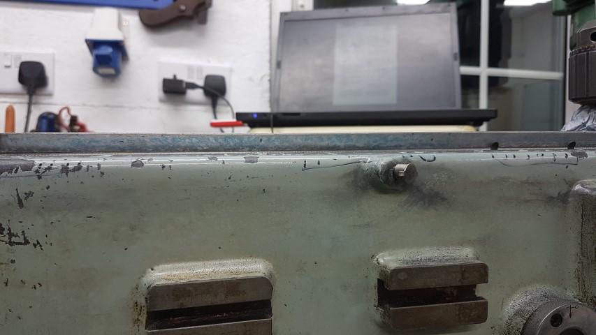

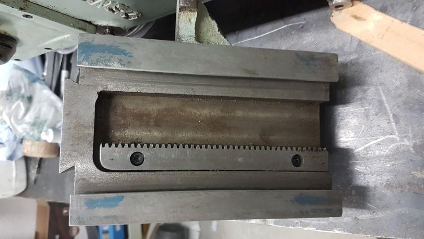

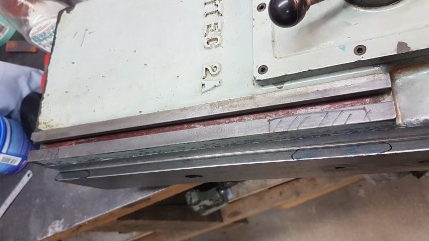

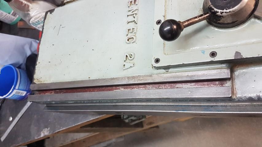

So with a decent reference point I was able to start work on scraping - a week later than planned  :bugeye:
Connely talks about getting the face of the column flat and perpendicular as the first step. On the Centec though the column face isn't a load bearing surface as the knee runs purely on the ways.
So next step in the process is to get the "guiding way" (opposite side to the gib way) flat and square. To do this I used a combination of a dial indicator mounted in the arbour and a longs straight(ish) edge. The straight edge allows you to measure deviation as you swing the DTI in the arbour. Pic 1 shows the setup if you were using it to check the face, but I just used it in the way. Also had the arbour (Jacobs huck :bugeye:) clocked with a seperate DTI to keep an eye on errors there.
Rather strangely to my thinking the bottom of the face is further out from the chuck than the top, this is true on both side and is about a .12 - .14mm difference. I could understand the bottom being deliberately "proud" to combat sag when built up but 5-6 thou seems a lot. Also I expected the bottom to be most work but it is actually the middle that was showing more wear.
After a rather abortive effort (see post in "scraping lessons learnt") I eventually got the way pretty flat. I am using a combination of a dovetail straight edge kindly lent to me by Julian (but this only covers 3/4 of the knee) and a prism kindly lent by Pete (which covers the whole knee but is very heavy and difficult to balance on the way). As a result my work method was to mainly use the small edge to get the bottom 2/3rds of the way flat up and down and outside to inside edge and then check the overall flatness with the prism. the top 1/3 of the way isn't actually used on this mill as the knee never goes that far so I wasn't too concerned with this part.
After the first attempt it looked like pic 3 and the gradually worked it in via pic 4 till we ended up with pic 5. It is about 15 - 20 PPI across 60% of the main bearing surface and that is good enough I think. The "incline" on the column is now .06mm (3 thou) top to bottom i.e. the base of the way is .06mm proud of the top measured relative to the spindle.
So that's way 1 done only another 15 surfaces to go :doh: - might wait till next year to do those :)

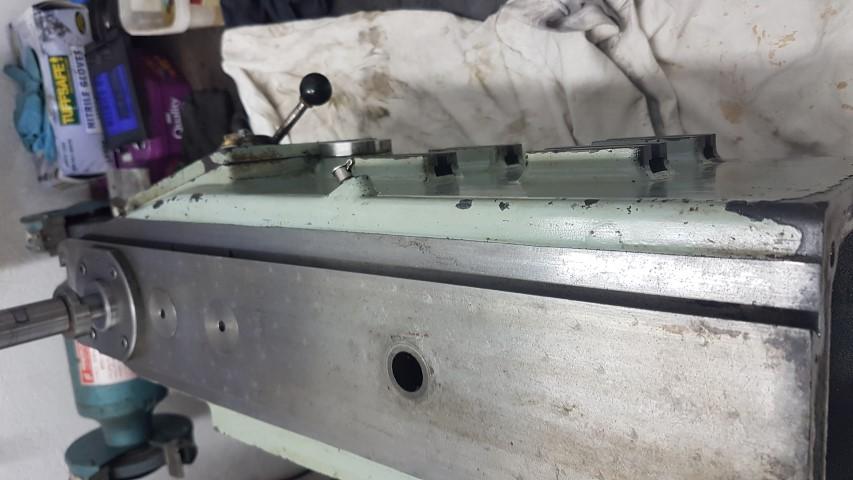

« Reply #29 on: January 21, 2018, 02:28:40 PM »
Bit of an update.
Have completed work on the column dovetails now. Started out by checking for parallel between the dovetails at different points along the column using a couple of milling cutters as pins to measure with. Used a pair that pressed against the middle of the dovetails.
Pic 1 shows me measuring up, was pretty good actually with only about .02mm variation across most of the column widening out to .06mm at the top where it isn't worn.
Then ran the straight edge across the dovetails to see where the high spots were. The Gib dovetail (pics 2 & 3) actually looked flatter than the non gib (pics 4 & 5) so I decided to use that as my "master" and scrape this flat first.
It actually didn't need much scraping to get it flat, but it had a couple of nasty scratches in it so I took it down a bit more to get rid of these until I had a nice finish - pic 6.
Once this was sorted I did the guiding way dovetail (pic 7) and re-measured. Dovetails are now within .02mm all the way along so I am happy with that.

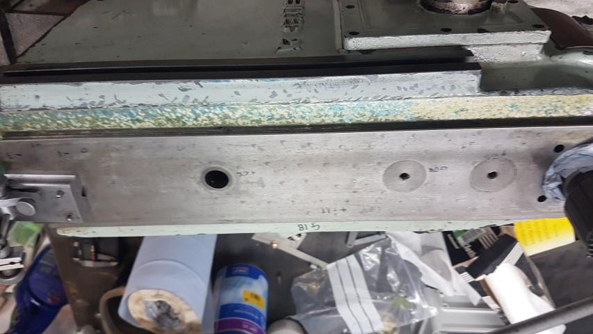

Just for laughs I then blued up the column and took my first print of the knee  :bugeye: (pic 8). Not a lot of bearing surfaces here then, just resting on the four corners.
Next job is to attack this.

« Reply #32 on: March 12, 2023, 11:16:36 AM »
I wanted to say a huge thanks to Paul for starting this post. I’m trying to strip a seized mk2 vertical head and there really is no other resource to help understand the innards, particularly now the Yahoo groups are gone.
I’m fairly sure the bearings on the shaft of mine are the cause of the seizure. I’ve removed both top and bottom caps and can see the bottom bearing as described.
I am going to need to drop the shaft out of the head, downwards as suggested.
My question is do I need to loosen the bevel gear thrust nut first at all? Should it all just press through the lower bearing shell? Best guess at the moment is that it needs pressing down until I can reach the thrust nut,undo the grub screw in it and unscrew it up the shaft as the shaft is pressed out, the nut will eventually come off inside the casing and the bevel gear can be slid off too, then the shaft pushed the rest of the way out..
Any advice would be gratefully received - I’m wary of trying to press the shaft out and causing damage but I don’t see any other option
All the best
Darren
