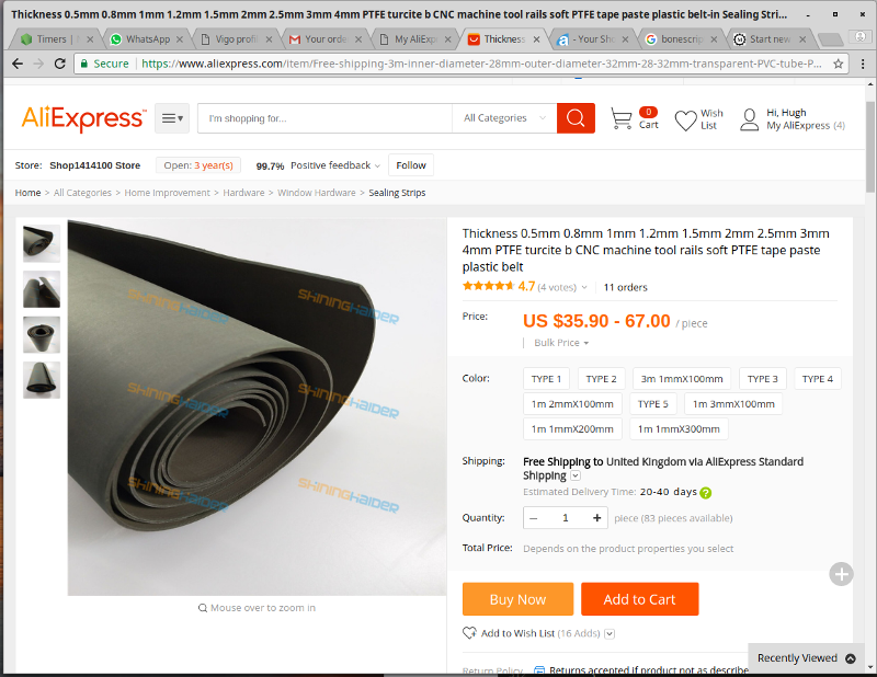

As I alluded to in my emails after the scraping class, I have found a source of far eastern Turcite style way material. A sample is on order and will be here in the new year. Details as below:
Re: Turcite from the far east
« Reply #1 on: December 21, 2017, 11:30:12 AM »
I'd like to try that out. What size sample did you get?
Offline HughF
  • Posts: 14
« Reply #2 on: December 21, 2017, 11:34:49 AM »
1m long, 2mm thick, 100mm wide, £27 delivered :)

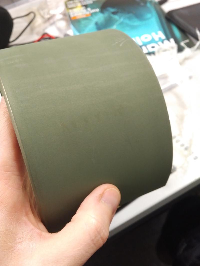

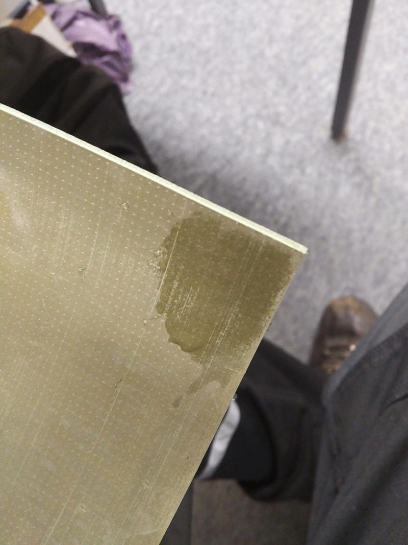

The fake-a-cite has arrived, and apart from the included free gifts, appears to be half-way-decent. It looks like it has bronze in and has a side that is etched for taking glue.
If anybody wants an off-cut from this roll just PM me, I don't actually have anything I need to stick it onto yet.

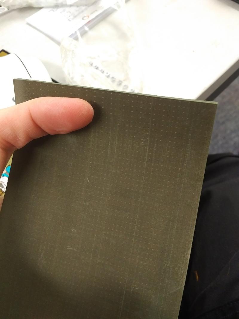

Got some of it. Cuts nicely.
Wonder which side is the glue side? The one that has sor of grid? Looks etched.

Not sure how this specimen is manufactured. I imagine that some are cast to thick slab and then skived to certain thickness.
The glue side must be prepared, ususally etched or it bonds badly. The sample I got has two little bit different sides...one that I suspect is the glue side.
I rumaged my suff but I didn't find any normal non filled epoxy. Shops are not open this hour, I have some time to procrastinate, before I need to try.
Also I have completely run out of small sample cups....I buy like 50 of them and now that my daugter has been making up some of her own make up and does whole lot of painting, the cups just disappear. Plenty of lids left. Mystery.

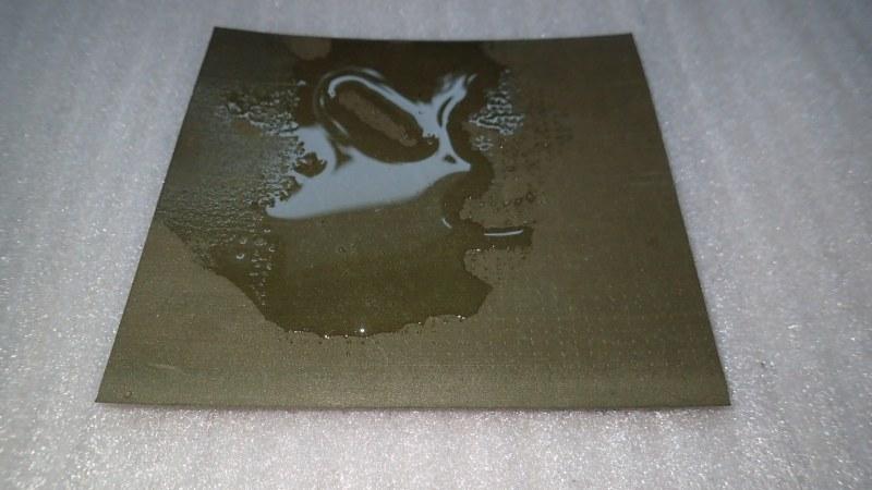

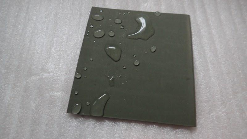

Pour water on it, it sticks to the side you glue, runs off the side you don't.
Well, on real Turcite it does anyway :D
« Reply #22 on: January 28, 2018, 05:09:11 AM »
Why I didn't come to think of that? :Doh:
Thank you very much!
Glue side is the side I suspected. It looked "etched". But very good to have confirmation.

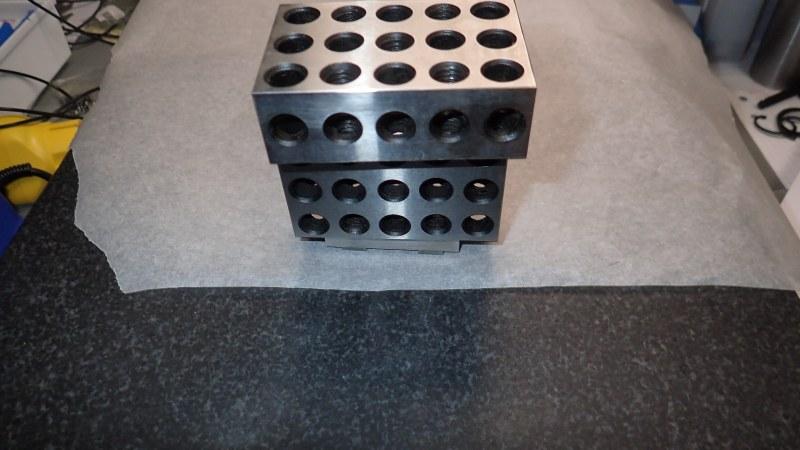

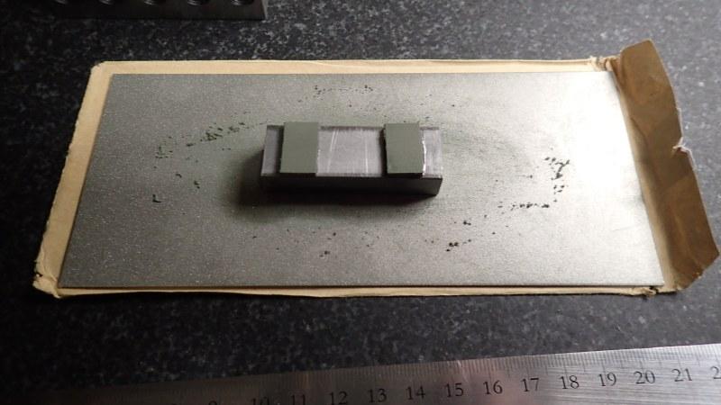

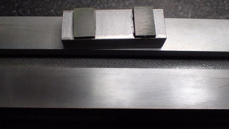

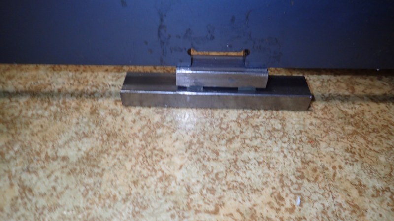

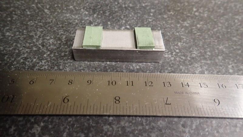

I got some two componenet epoxy, consumer brand. First I lapped the key stock reasonbly flat. Then I cleaned the key stock and 10*20 mm pieces of this bearing material with IPA, waited few minutes and mixed slow cure epoxy. I tried to get very thin even coat of epoxy.
I stacked over a granite surface plate: Baking sheet, glued bearing material under the key stock and wighted them down with two 1-2-3 blocks.
Let them cure overnight and then checked them. A little of the glue has extruded out but no dollops or runs.
The surface needed a quick go with 400 diamond plate, it was not even for testing. It has clear bronze sheen on it, but I did not got clearly on camera.

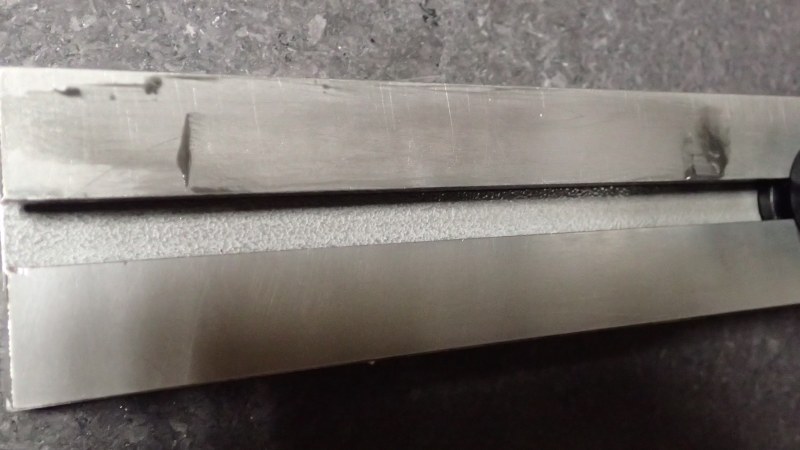

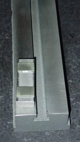

First when I tested it to granite surface plate I was a little disapointed. It has not stick like metal or really flat granite. It also has some friction.

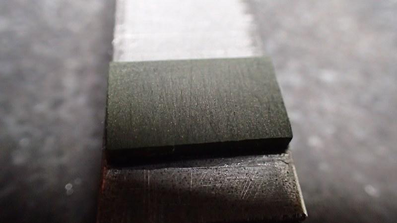

Then I tested it on dry and lubricated cast iron micrometer foot. It needed a little work and lubricant before the stick-slip feel decreased. Interesting.
I used some thin parafin oil as a lubricant and then it had a very nice feel. It still worked well when I pressed it harder. Some black material (grphite?) came in oil suspension.
I cleaned both surfaces and tried again. It still seems pretty much ok when it is used dry.
Would need some serious testing, because it feels a little different depending on how well it is bedded, amount of oil, pressure and speed. Tried to figure standard way of measuring...would need a good spring scale and try it on lathe bed. Anyway, it feels like it works.
Did not try to scrape or grind it with a TCG yet.
Maybe next step would be to measure thickness and put some weight over it to see if it is likely to cold flow during use.

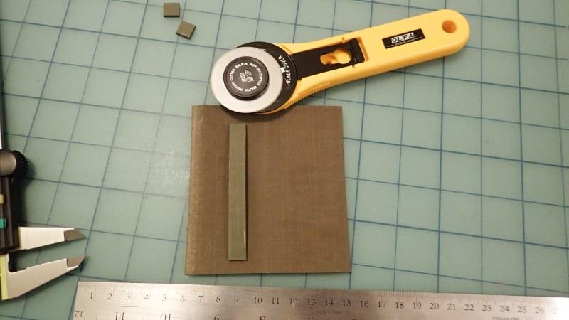

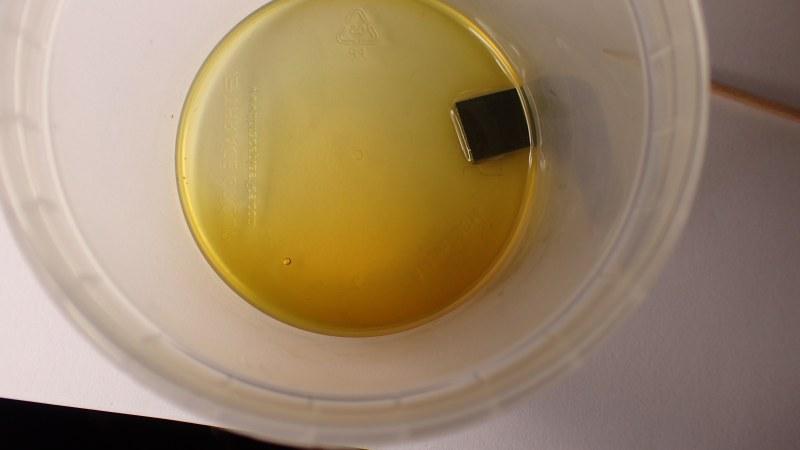

One day of immerrsion test in synthetic cutting oil made no difference on 10 mm square sample dimenssions.
Only funny thing is that the is just very little discoroured. Just about noticeable. I started doubting myself, but then I dropped one little blob of new oil and then the difference is quite clear (but still quite small) :D
Hard to cattch riveting drama on camera - after all it is just a small piece of materil immersed in oil.
Planning to keep it in oil for few weeks and I really don't expect it to expand. If it does then there is something really wrong with the material, but it feels pretty genuine.
Does this makes any sense?
Real test is ofcourse to make something usefull and test it there.

Still soaking and shedding some color....
Put last night about 55 kg of weight atop of the bearing material to see if it sqashes. Let's see.
« Reply #27 on: February 09, 2018, 04:11:08 PM »
Interesting. No change.
The specimen in the immersion test has not changed in dimenssions any measurable way. I'm using a digital caliper. Only thing it that it is shedding green colour in the oil, that means something in the end.
Wonder if I should try out way oil, hydraulic oil and I still might have some cutting emulsion left for test.
The other specimen has not been deformed at this load level. I could double the load or keep the one plate I have few more days.
All in all it looks pretty promissing.
