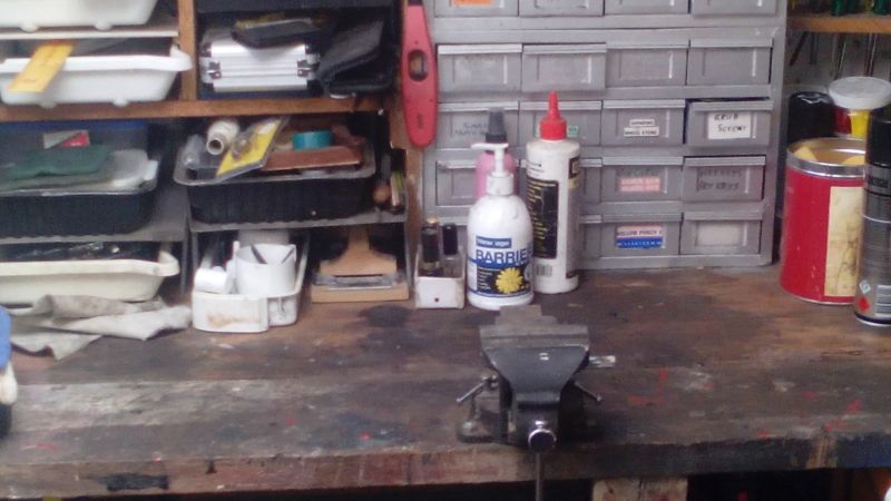

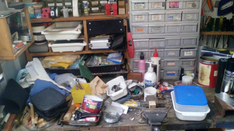

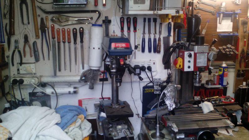

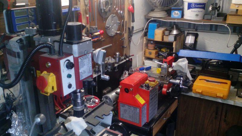

Now here is what you don't see in the videos. The platform the engine is siting on is a laminate basin cutout that becomes my layout table and an auxiliary bench by clamping a lug on the underside in the vise.
  An idea from Harold Hall's Workshop series No 39 from memory.
   Why? Well the photo should explain it, see the poor photo definition from my phone?
Re: Elmers Simplified Beam Engine
« Reply #2 on: November 04, 2017, 02:52:25 AM »
A few hours later the bench looked a tad better. How long for is quite another question. Probably until I start another project. AFTER, cleaning the rest of my small shed (3.5 metre by 1.6  metre)
As in the other two photos.
