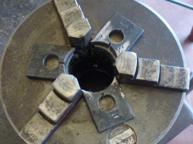

« Reply #8 on: October 29, 2017, 08:15:41 AM »
Before you change chucks,maybe you could improve them by grinding the jaws; I seem to be having trouble attaching an image. The idea is to make three blocks that fit between the jaws so that the chuck can be closed tight and still allow grinding of what are usually the clamping surfaces. the holes and slots allow a little spring. You will need some kind of internal grinder to run this on the lathe!
Re: Camlock chucks
« Reply #9 on: October 29, 2017, 07:34:16 PM »
a
Excellent tidbit.  I've seen it done with a ring in the back, but the ring gets in the way of most chucks.  This method wouldn't get in the way at all.  I'm assuming the idea is to turn it SLOW to avoid throwing the blocks.

« Reply #10 on: October 30, 2017, 02:38:24 AM »
I have used both ring and plates but without the holes , the ring must not toutch the bore of the chuck , a quick test for the jaws is to lightly grip a piece of round hss in the chuck and feel iff it rattles .

« Reply #11 on: October 30, 2017, 03:46:39 AM »
a
Sparky,
I never had a block "throw", remember, they are clamped in by the jaws!
Cheers, Matthew

« Reply #13 on: October 30, 2017, 07:50:39 PM »
Yes, but the direction of centrifugal force is only countered by the friction between the blocks and the faces of the jaws, from what I'm seeing.  It seems that if you had a little too much spring built in, or too light a touch in tightening things up, it might launch one.

« Reply #14 on: October 31, 2017, 03:37:38 AM »
It's a tried and tested method that's been in use for over a century ( like most things to do with lathes !)
To get good results you don't want light clamping anyway as the jaw teeth need to be in firm contact with the flanks of the scroll as they would be in normal use to get the same alignment.
Re: Camlock chucks
« Reply #15 on: October 31, 2017, 04:00:10 AM »
Sorry mate, the spring action actually equalises the clamping action. The friction under pressure on these very light, near to the centre blocks is more than enough to hold them in place. Might I suggest that you try it? I certainly wouldn't advocate anything dangerous that I hadn't tried. This being said, I'm not responsible for anyone that doesn't tighten their chuck jaws when using this method!
Cheers, Matthew
