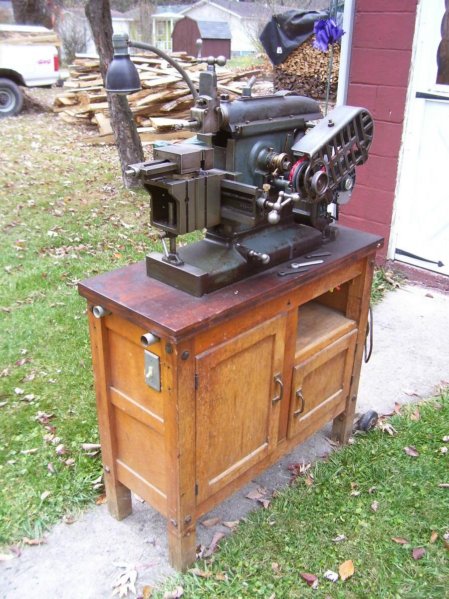

« Reply #8 on: October 20, 2017, 06:35:56 AM »
That's very similar to my AMMCO 7"  Mine is even on the original cabinet as is the attached picture is from the net  :drool:

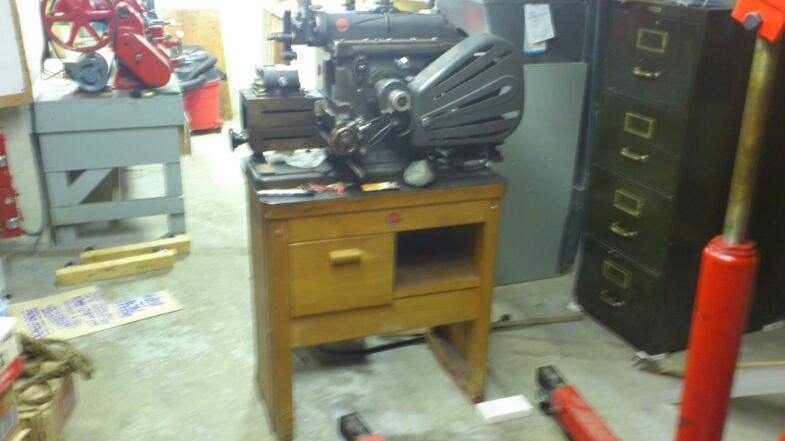

I have the Atlas 7b shaper that I inherited from my father he didn't have a mill and was using it for his steam engine he was building it seems to work nice but we would love to get a extention for the table so we can use the dividing head.
