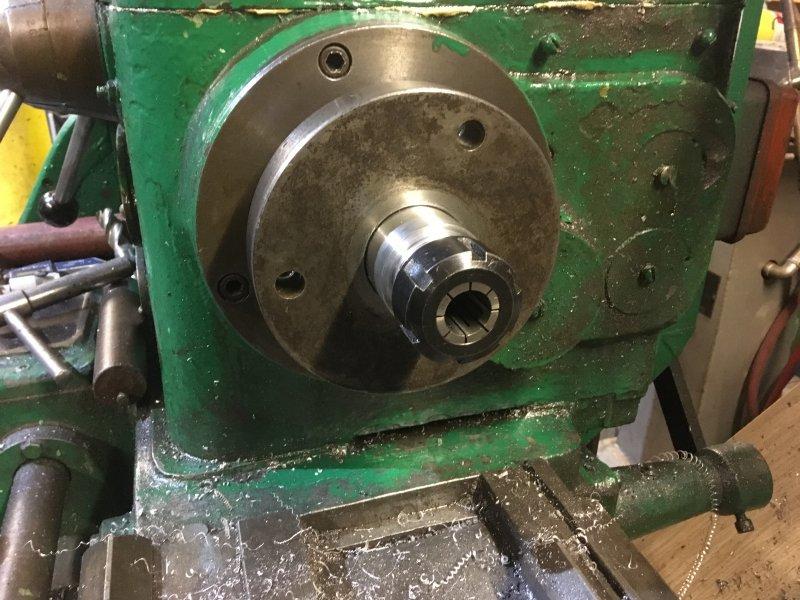

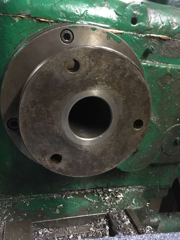

I'm getting fed up with the runout in my chucks, it's impossible to get anything even remotely re-centred, and even if you do the chances are it's at a funny angle, so whilst I can work fine so long as everything can be done without having to turn the workpiece around, as soon as one needs to reverse a part to finish off the backside, it's all out of true.
I'm 99.9% sure the problem is a worn out chuck - all my chucks are second hand at best, and quite bashed about & worn, so it's not entirely surprising they're past their best. The final solution will be to buy a new chuck.... but that'll have to wait a few weeks until I can raise sufficient spare funds.
So - in the meantime, I'm pretty sure the spindle taper is an MT5: I've got an MT5 to MT4 sleeve, and MT4 to MT3, and my ER32 collet chuck has an MT3 arbor on it. Put them all together, and I should have a super true-running chuck  :thumbup:
Er, no chance. Seems the spindle isn't MT5 after all. So.... question is.... how do I measure the taper? Given that it's deep into the spindle, which is only a couple of inches across at best..?

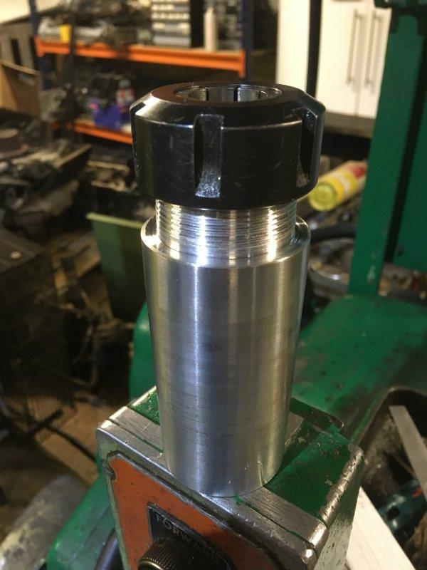

I've made a series of taper blancs to be able to make various ER40 and ER32 holders. I "copied" the spindle taper to the compound slide using a rule to get it in the ball park and the tweaked it with a dial test indicator. The spindle had a rusty zone, so I re-cut the spindle at the same time. I digress, what do you want to do!!
Cheers, Matthew
Re: How do I measure a spindle taper?
« Reply #8 on: September 13, 2017, 05:01:06 PM »
Hi Matt,
It probably is in the manual (doh! Never thought of that....). First job is to make a sleeve adapter to take a 3MT so I can use my ER32 collet chuck without it wobbling all over the place (as it does if I put the non-tapered body into a chuck). After that.... who knows! Most of my stuff is 3MT (for the tailstock), so that'll be the most useful item.

It might help if we know what the Lathe is... Colchesters have their own tapers that are just bigger than a 5MT and have adapters to take them down to 3MT. Have you checked if it mentions the taper on Tony's site?
An ER32 collet holder up the nose of a lathe that size  :scratch:
Jo

I'll answer for adev, as i have the same Edgwick mki that he has. It's a proprietary spindle nose taper. the spindle bore is 1 3/4 inches so we are over Morse 5. I think Er32 and 40 could be very useful on this lathe especially as it a 1940's modle, so chucks are pretty worn out!!

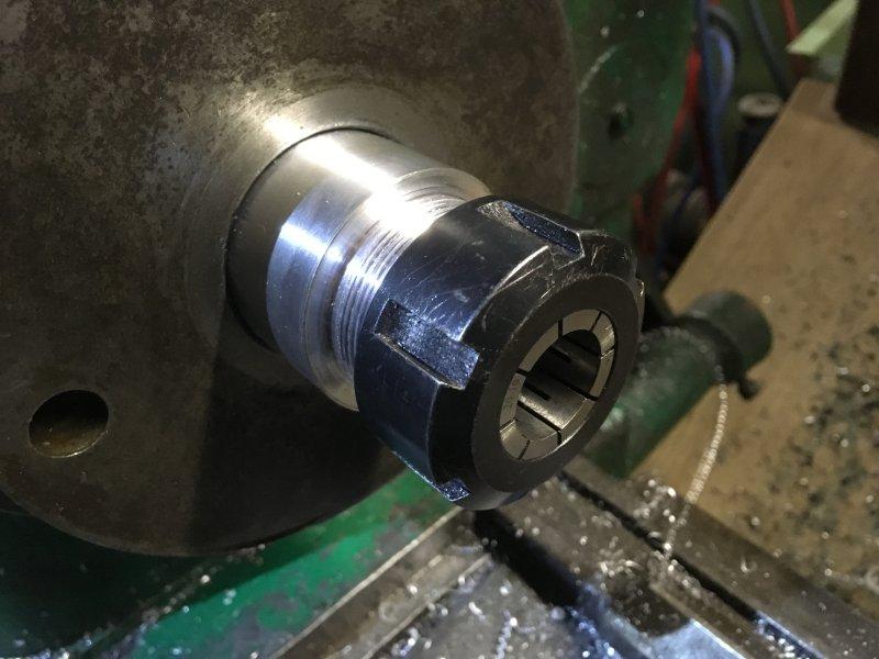

Just a quick update on this one..... So, I set my topslide over to measure 0.050" per inch to cut the taper, cut the taper which came out very nicely thank you (lovely smooth finish on the ali). And, as some of you will have already realised.... at completely the wrong taper of 0.1" per inch!!!  :palm:
Then I had a 2 week holiday.
Having a spare few minutes the other day... I tried my new taper out & discovered my glaring error. So, back to the topslide, re-set for half the previous angle, as measured with a DTI on some freshly squared up stock. Cut the new taper, crossed fingers & clenched backside, removed the chuck, cleaned out the spindle tube & popped the freshly cut aluminium taper jobby into the spindle. A sharp tap with the plastic hammer seated it beautifully, hurrah! In fact, it took some fairly hefty beating on the back face to get it back OUT of the spindle!
I blued the spindle with some Stuart's Micrometer Blue, and popped it in again. And when I did finally managed to smack it out, it looks like it's contacting all the way around for a good 2", so I'm going to call that "good".
Whacked it in again, faced it & turned down the outer diameter so it's running true, and drilled a 1/2" through hole (I'll open that up a bit further yet), but this leads to my next question!

Right, well, I'm officially a happy bunny!  :ddb: :ddb:
First, drill & ream to 25mm (slightly oversize, it should be 23.5mm, but I don't mind the extra smidge of room). I should have just drilled straight out to 1" TBH, it'd have been quicker & easier, but hey ho.
Looked up the ER32 taper angle (8 degrees), set the topslide 4 degrees, cut, why won't it fit properly?  :scratch: Bloody hell, the included angle is 16 degrees! A single side of the taper is 8deg!  :bang: Re-cut with the proper angle (eyeballed on the topslide), it was close, so I fiddled with the topslide & a DTI for a bit, got it closer, a couple of minor tweaks and YAY! Bang on! (ish - it's not quite as accurate as my bought one... but it's pretty damn close).
Final steps, cut down the outer diameter to 40mm OD, make a new tool holder for the QCTP to take a threading tool (upside down.... see Joe Pieczynski's threading trick on YouTube - basically, instead of threading TO a shoulder, you thread FROM it, running the lathe backwards with the tool upside down). I nearly cut a left-hand thread, but managed to set the machine correctly before I'd done more than a scratch pass. Being a metric thread, I have to leave the machine engaged throughout the threading process, which made life a bit entertaining... it's hard to turn by hand when in gear, unless it's in a nice high gear. So... cue some single-point threading at 670rpm!  :bugeye: :zap: Fortunately, no crashes or accidents, and eventually the nut threaded on. I overdid the threads a smidgeon at the end, so the fit's a bit loose... but that doesn't matter.
Last but not least, lobbed a collet in, put a bar in it, and checked for runout (0.004" TIR - way better than I can get with the 3-jaw, and truth is I'm not sure how straight the bar is). Took a skim cut (which, naturally, reduced TIR to a couple of tenths, probably). The REALLY good news is, it cut completely parallel! First time my lathe has EVER done that (in my ownership), which I think proves that either my chucks, or the mounting face of the spindle nose, is wonky. Now that I know that, I'll probably take a few thou off the face of the spindle nose.... and start saving up for some new chucks. ALL of my chucks (I only have about 4) cut tapered, so they're obviously not going on dead true. Or they're knackered. Or both...
Anyway, I'm chuffed because I've proven to myself that my lathe CAN cut straight, and that I've got half a chance of actually making a decent ER32/ER40/ER50 chuck for it in the future. I will sleep well tonight :)
Of course... I now have to do the whole thing again, using steel this time! Although I'll probably use the Ali one until the threads expire. Other tasks to do: Make a hollow drawbar (although it seats pretty damn firmly in the lathe without one, I'd rather not risk it, especially if I ever take heavy cuts).
Now... where did I put that 2" steel bar....  :scratch:
Many thanks all for your suggestions and assistance! It's worked out really well! :nrocks:
