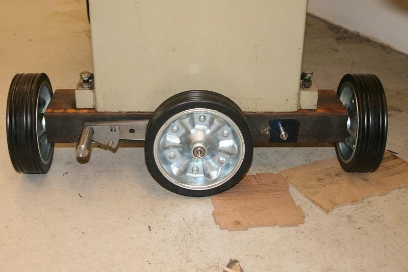

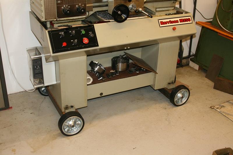

« Reply #39 on: October 28, 2020, 06:15:54 PM »
My lathe was a little low, (I'm 6'3"), so mounted it on 5 wheels, which makes it easy to move about single handed. Ideally it could have been a little higher. :)
