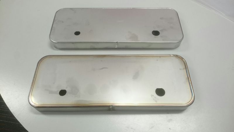

We've been buffing some TIG welded stainless assemblies for a few years now and it's a bit of a pain:
   1.You get a shiny weld which contrasts the satin finish on the rest of it.
   2.You have to get the wax off.
   3.Then you have to get the stuff you used to get the wax off, off.
We could just use pickling paste, but all the ones that work have HF acid in them and that's nasty even by my lax workplace safety standards.

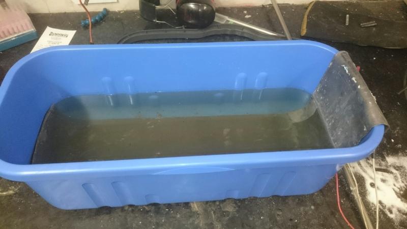

I decided to look into electro-polishing and a quick search turned up a candidate solution of Citric and Sulfuric acids, neither at nasty concentrations... This looked promising as I'd assumed we would have to use hot phosphoric/sulfuric acid. Out came an old mop bucket, in went some lead flashing for a cathode, and 7 minutes at 10A later out came the part. All it needed was a quick wipe under running water and presto!

« Reply #7 on: August 28, 2017, 11:30:35 PM »
Interesting. This process is a complete stranger to me.
What sort of concentrations we are talking here? Few %?
I just made up 4L of a saturated solution from dry acetic acid (150ish g/l) and added about 1L of battery acid. It sounds a lot worse than it is. I'll be telling the guys to wear gloves, but I didn't. It's certainly no nastier than an anodising tank.
Another question is about lead cathode....Does it has to be lead?
Nope, anything that lasts will do. You could even try stainless steel. Graphite would work and titanium would be perfect.  Just make sure it has a large area WRT the job.
So, yo need a "tank" that works same priciple than ultrasonic cleaner - drop parts in basket, clse the lid, press "start" and it chime when process is over? Wih pre/post rinse buckets? Not the fullyautomatic conveyor system like in metal plating lines.
would be nice, but it'll probably be a small rack with Ti fingers that clip into the part. Push the button and the rack lowers into the tank, a few minutes later the power is turned off and the rack rises out of the tank and the unit starts making some irritating noise.   Add in some fume extraction and call it done.  We only do batches of 100 of these parts so there's no need to go too stupid with it...

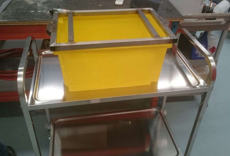

« Reply #11 on: September 05, 2017, 02:50:43 AM »
 :update: Some progress.
The trolley for the thing arrived.
I welded up the frame that will hold the carrier hooks and get lifted in and out of the tank by an , as yet, unspecified mechanism.

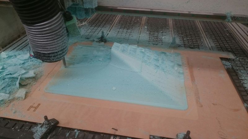

Today we made the foam plug for the fume catching lid...
