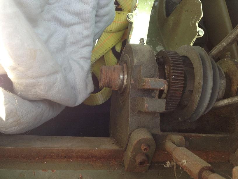

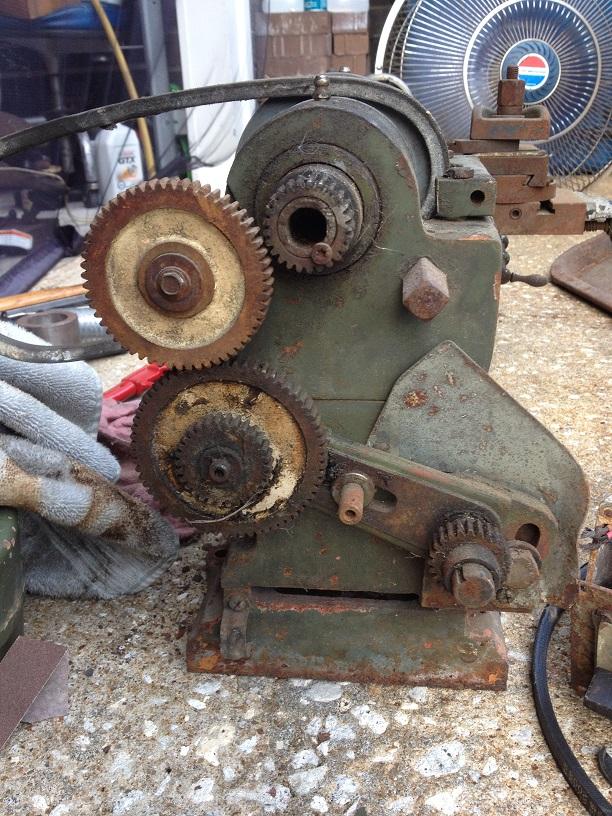

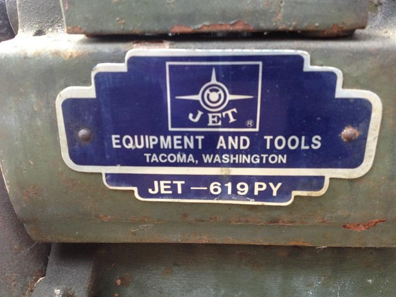

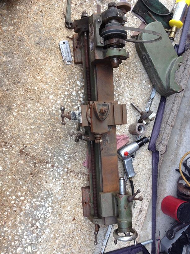

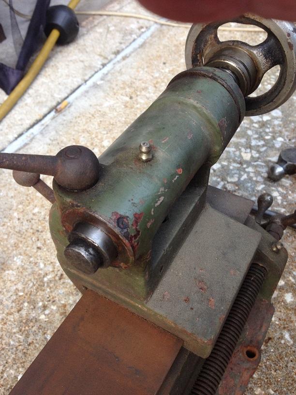

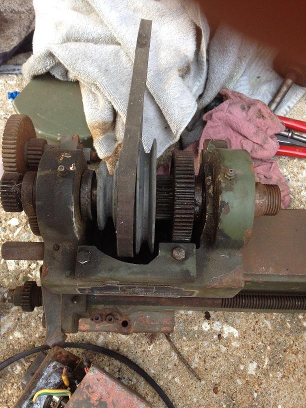

I recently acquired a Jet 619PY lathe that has been in a warehouse for 18 years.
The owner (a friend) has incurable cancer and didn't want the lathe to be trashed.
Many say Jet never made a 6x19" Lathe, so here is the nonexistent photos.
This little lathe is very similar to both the Myford ML10 & Speed 10 Lathe.  It has some features of each.
Just not sure if the parts are interchanable because this lathe is not just longer then the ML/Speed 10 Myfords but appears wider too.
A few old Magazines online shows these Jet's were Mfr'd from 1986 to 88.  It was Boeing's very first attempt at selling tools and hobby lathes in America called JET.
Well Jet lahes sunk like anchors on sales, selling only a few thousand I discovered.
The lathe was covered in a haze of rust which comes off quite easily with a 45 minute soak in Apple Cider Vinegar and a light scrubbing with a S/S I/2" Wirebrush.
It was made in Taiwan and appears to be more well machined then the current Chinese line today.  No doubt Warco was probably popping these out.
If someone has a Myford ML10 / Speed 10 lathe manual in PDF, I sure could use it.
I will post Pic's as I clean it up.

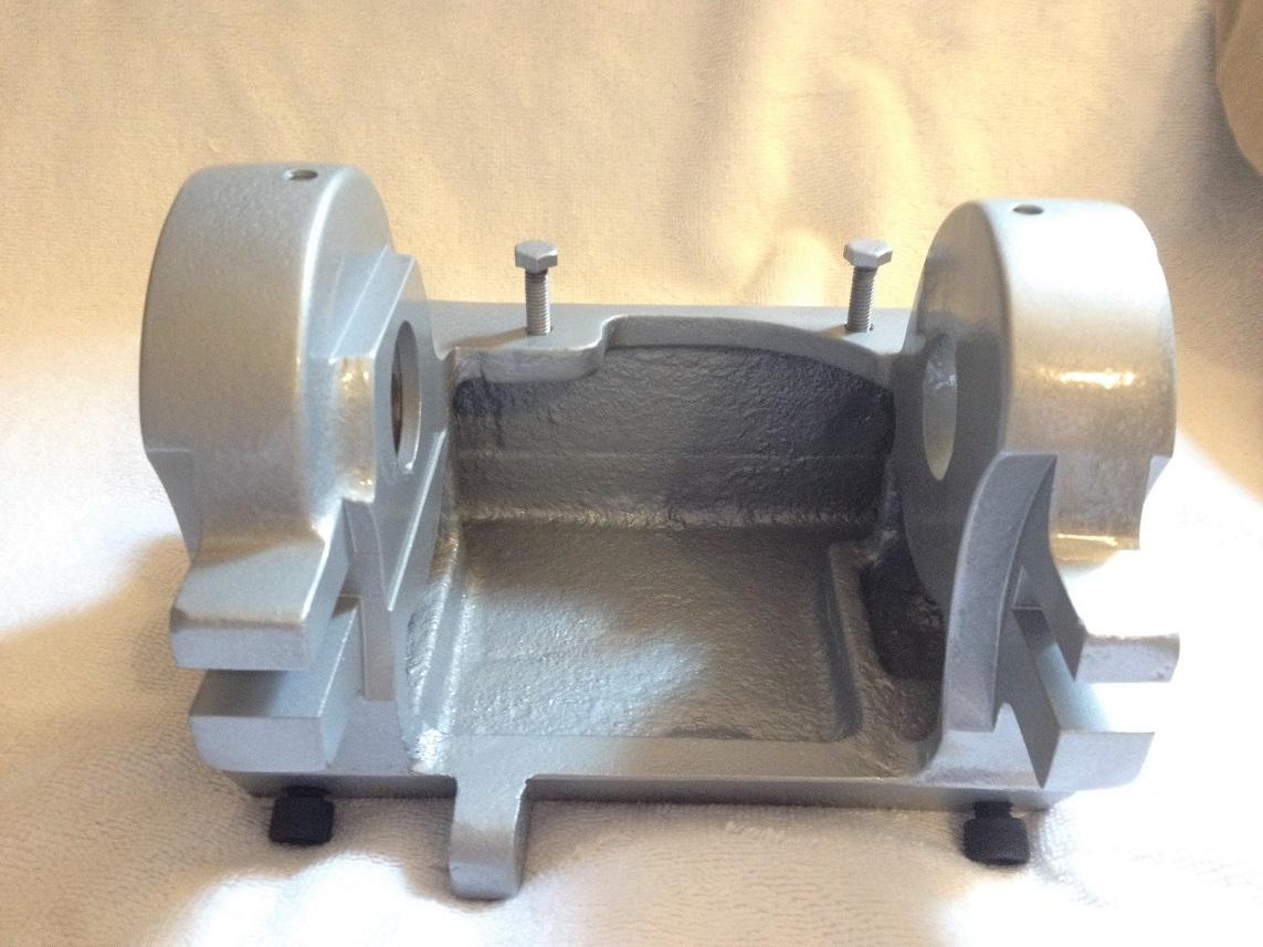

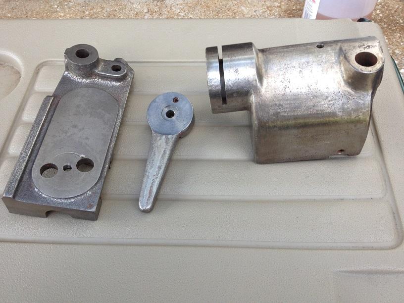

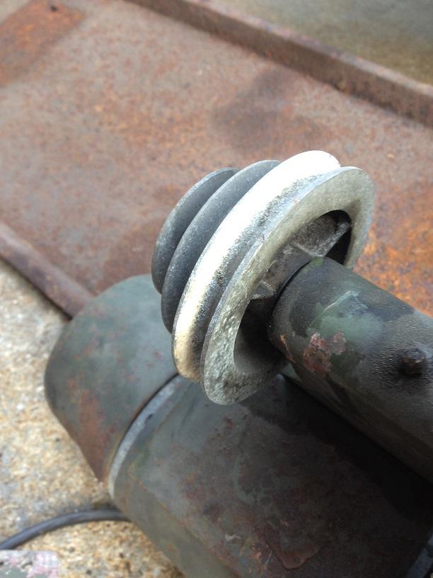

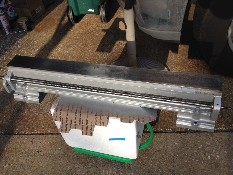

Here are some updates of the Apple Cider parts cleaning  :drool:
The leadscrew was placed in a PVC pipe and soaked for 45min twice.

Your de-rusting exercise looks to have given excellent results.  Did you have any problem with flash rusting after you dry off the parts?  I've had reasonably good results with citric acid.  I like to finish with a methylated spirits rinse to remove the final rinsing water.  (Do I need to explain what 'methylated sprits' is?)

I don't have any problems with flash rusting at all.
I scrub the parts off with a stainless steel wire brush and keep them submerged in a bucket of water which contains Dawn dishwashing detergent.
I wear nitrile rubber gloves to keep the rust and Cider from tinting my skin orange.
As soon as the parts come out of the Dawn water, I rinse them off with freshwater and dry them off with an old clean towel.
Instead Isopropyl Alcohol I use acetone and wear nitrile rubber gloves to clean off the metal prior to painting.
The shiny metal parts you see in the photo were left out for seven days in the garage with zero rust on them.
If I were you, I'd send back Evaporust and just use apple cider vinegar it works far better.
If you do use the of Evaporust make sure you're in a ventilated space.
If you decide to use apple cider vinegar make sure you can seal it off because it will attract bees, flies and any other creature that will eat rotten matter.
Evaporust is a one time use product. Apple cider vinegar can be filtered using coffee filter liners in a funnel and you can recycle it is many times as you like.
Oh yeah and the price is cheaper too.

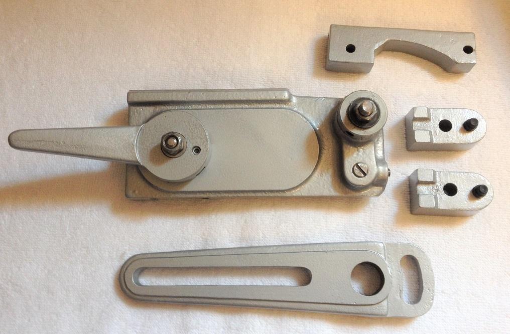

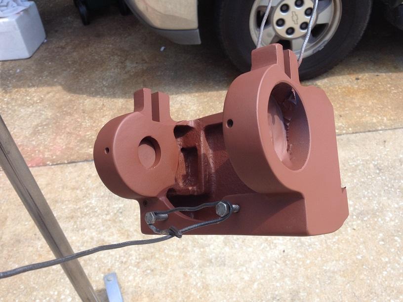

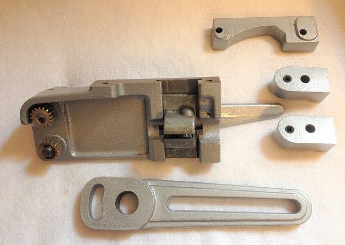

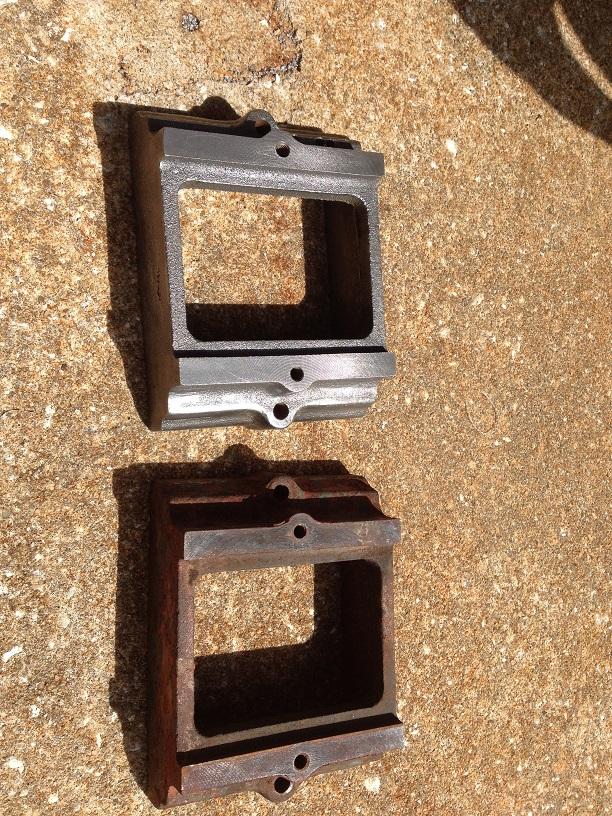

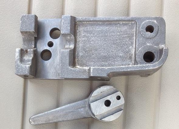

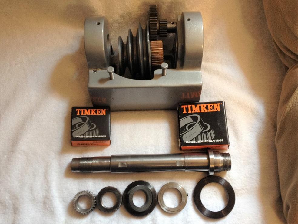

Some progress on clean up, painting and partial assembly

« Reply #8 on: October 09, 2017, 02:21:49 PM »
From the added photos, it would appear to be a version of the Myford Speed 10 rather than mine which has plain bearings of cast iron.
My additional information( such as it is) is in French but my '10' has been extensively modified by the previous owner(s) and the feed dials bear no relation to the ones fitted in both sets of information.
Looking at the lathe, it obviously never was capable of Screwcutting left hand threads but I have to re-fabricate the left hand tumbler arrangement.
Of course, I don't know what your intentions are with your 'variant'
Norm

I've thought of a reverse tumbler and even looked at Graham Meek Dog Clutch design.
