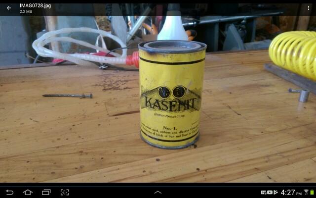

Re: Quick and dirty die-nut.
« Reply #14 on: July 21, 2017, 06:21:02 PM »
will have to put a pic of my tin kasenit its got no dents

  • Posts: 6870
« Reply #16 on: July 21, 2017, 07:08:40 PM »
Bob, are you sure you didn't take a buck and body hammer to it?  :poke:

  • Posts: 1294
« Reply #18 on: August 24, 2017, 06:28:04 PM »
Mines yellowed :poke:
