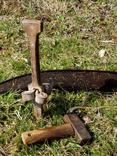

Part of the process of sharpening a scythe is known as peening - the term relates no doubt to ball pein hammer etc. It's quite an art as you might expect. https://scythecymru.co.uk/scythes-for-sale/peening/
Peening has several uses, apart from drawing out and straightening blades, it is also used on welds to relieve stresses and to straighten bent bars. Peening can be done with a hammer or a needle gun. The pein refers to the "other" side of a hammer eg cross pein straight pein are peins, as much as ball peins!
