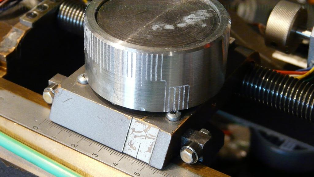

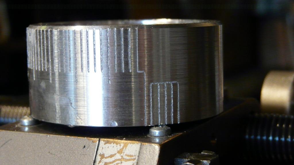

Out of over 300 lines of G code I put a C insted of an X , turn it off and start again .

100 lines on the dial x+ x- e+3.6 three moves per line on the dial , very first job on the mini mill still learning big time .

This is Arduino running Marlin and does not support M98 call macro , wrote it with word pad copy and paste a block at a time , if I knew how to put the numbers I would do that but will have to stamp them .

I have no idea of the cutting caperbilities of the machine , and have tried to finish at the start point , that way I can increse the cut a bit at a time , first cut was 0.2mm and it souinded ok with that .
