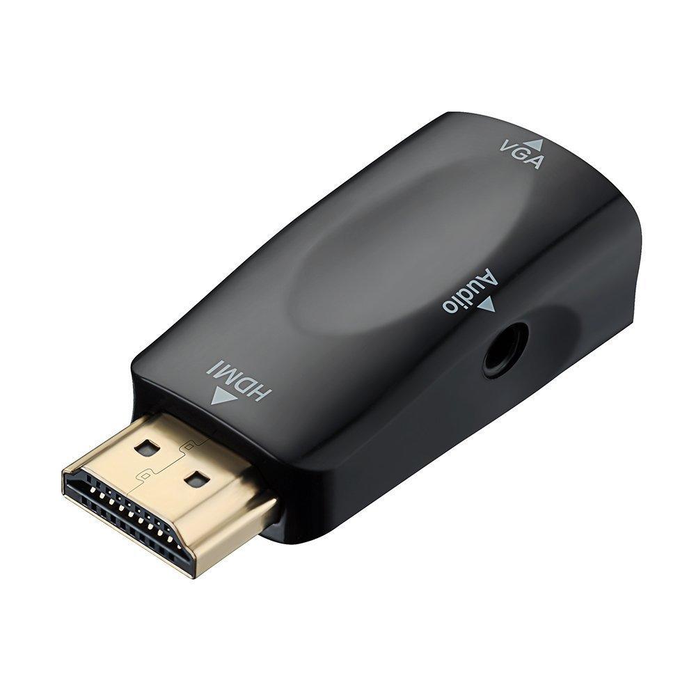

Offline John Swift
  • Posts: 344
Re: Any HDMI experts on the Forum?
« Reply #8 on: June 26, 2017, 03:35:56 PM »
Hi Andrew
a search for HDMI headphone adaptor
my first result was this from amazon
https://www.amazon.co.uk/Adapter-Upgraded-VicTsing-Gold-Plated-Converter/dp/B016I34422/ref=sr_1_1?ie=UTF8&qid=1498505426&sr=8-1&keywords=hdmi+to+headphone
it gives you both audio and VGA outputs for £6.59

  • Posts: 9071
« Reply #10 on: June 26, 2017, 03:54:58 PM »
Thanks John - ordered  :thumbup:
David, the drivers for the on board audio and speaker are from HP (it's an HP Z800)  :med:

  • Posts: 9071
« Reply #17 on: July 01, 2017, 09:23:55 AM »
Well Amazon delivered that little gizmo:
Sadly when plugged in it blanks the two monitors and I can only recover by rebooting without the adaptor  :bang:
So as an experiment, having got myself an HDMI cable, I temporarily stole the small TV from my wife's motor home (Shush ..... ) which has HDMI input, and successfully plugged it into the same HDMI port the the  gizmo failed in, and ended up with it as a third monitor AND SOUND  :ddb:
Thus proving not only that the HDMI port on the graphics card is OK, but also that the audio output from it works.
I think that the correct solution is to try and source an HDMI equipped 24" monitor with internal speakers, meanwhile the motorhome Telly has been snuck back  :lol:
