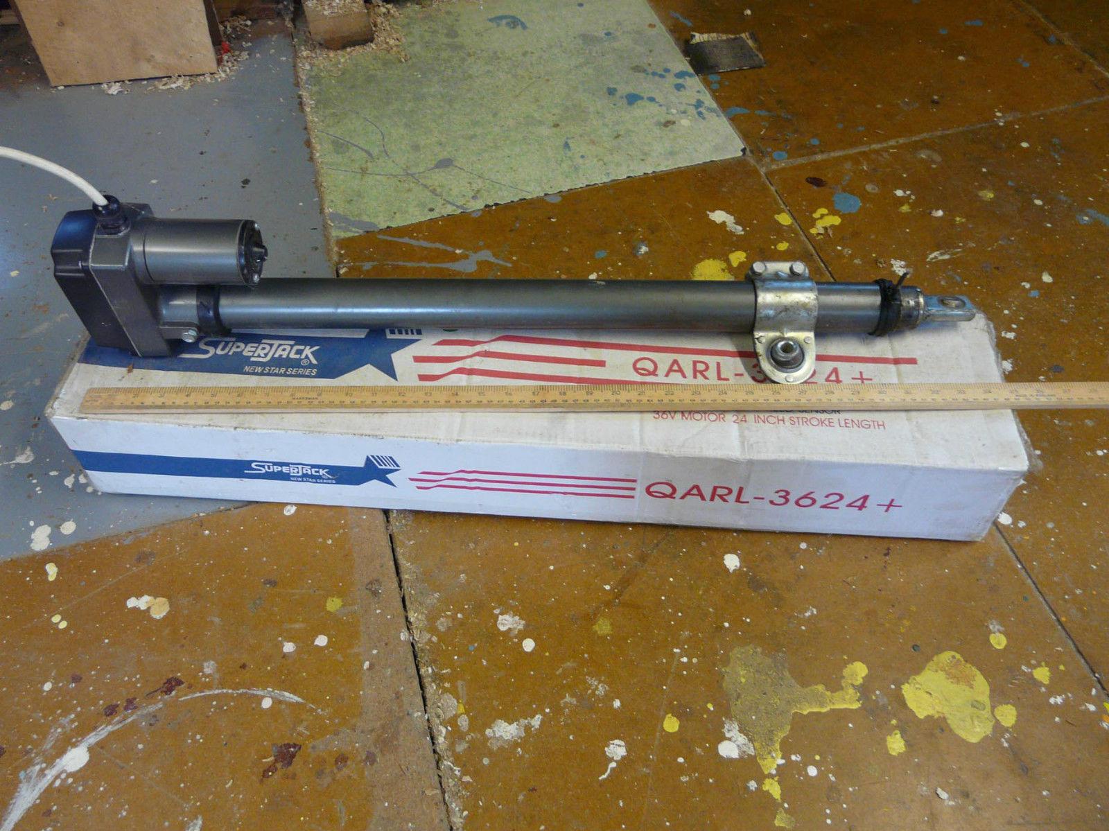

This sort of thing:
http://www.ebay.co.uk/itm/linear-actuator-heavy-duty-screw-jack-24-inch-travel-/182630112771?hash=item2a859a5e03:g:HskAAOSw1WJZM9bx
Seconded, these are neat and can produce prodigious force.  The ebay ones tend to wear quite quickly in  gate opening applications (YMMV) but for raising a bench every now and then they should last forever.  You need two DPDT relays to drive them and they often have limit switches built in.
PK

Linear actuators - very interesting indeed! They'd make the mechanism much simpler, that's for sure. The only downside is, I reckon I'd need 3 or 4 of them, one per leg, and getting them perfectly synchronised might be tricky? Don't want the bench going up wonky, all my stuff might roll off!

I don't think it's a worm drive. It does not work well as wheelchair motor. To acheive the 90° setup they usually use bevel gears.
OK, so I finally got around to looking inside the gearbox last night. It's still not 100% certain, because the thing was so full of black grease that I couldn't easily find the input shaft, without washing the grease out... however, the fact that there's a large gear with "throated" teeth suggests strongly to me that it is worm drive. The large worm-driven gear is attached to the same shaft as a small spur gear, which is then transmitted to a larger cog which is on the output shaft. The gear can be slid along the output shaft to disconnect it from the drive spur, a spring pushes it back into mesh when required.
I didn't power up with the lid off, as I didn't fancy getting sprayed with grease!
