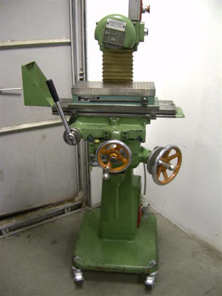

Hi Andrew,
I've seen a couple of Alfred Herbert Jr. machines in the past and liked the simple design. A couple of months ago in April I found a later model unit with the larger knee & oiler for sale. It appeared to be in very good condition, so I bought it. There won't be a chance to try it until my new garage / workshop is built, and a rotary phase converter installed. Thank you for posting this topic, I am looking forward to your rebuild with great interest !
Here is a photo of the machine I acquired.
Mike

Mike,
Mine is the same model with the oiler.  the rest of the ways seem in ok condition.  I think the bellows failed on the column and grit go in.
