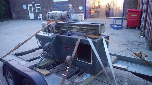

I started out in the world of machine tools with a Myford Super 7, lovely machine, but I soon realised it wasn't man enough for what I wanted to do, so I started looking around for an old, preferably English toolroom lathe. Almost by accident, I acquired a smart and Brown Model A, which is fantastic - a far better lathe than I am a machinist... But I've kinda been hankering after its big brother so when one appeared on the Yahoo group for a very acceptable price I couldn't really say no...
The good news is it was cheap, local and almost complete... The not so good news is it's in bits, there's no toolpost, it was taken out of use in its former life because the power feed wouldn't engage/disengage reliably, and its 3 phase.

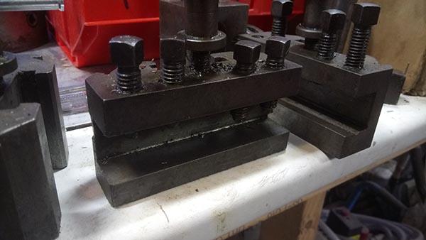

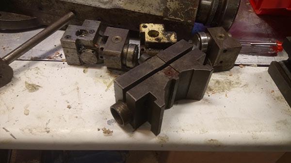

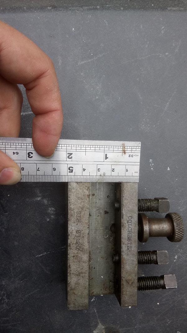

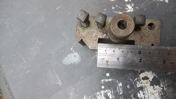

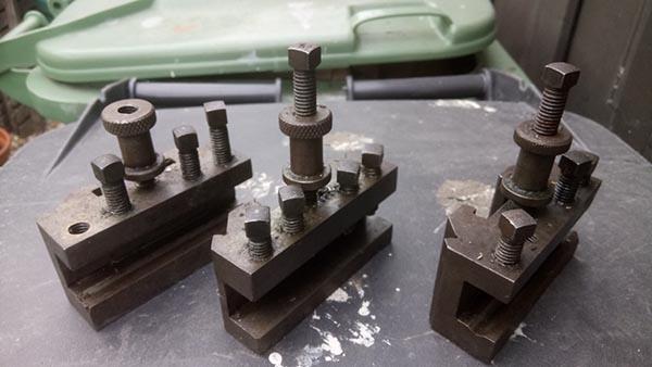

can anyone identify the mystery tool holder? could be yours if you can use it...
The lathe came with some tool holder's, I believe they fit a T2 QCTP, they are stamped Colchester. does anyone has a toolpost to fit that they could be parted from, or would they like to acquire them?

How may of the toolholders do you have? a size 2 (I think) Dickson but only two holders came with my Holbrook and I'd be keen to get a few more - where in Hampshire are you (I'm near M3 Junction 3), if you want a hand with the VFD conversion I've had a bit of practice!

I have three tool holders, I'll wave a tape measure at them tomorrow and you can check against your tool post. I'm in Eastleigh - J13 M3 I set up the VFD on my milling machine, so have had a bit of practice, but I will let you know if I get stuck. I believe the 1024 has a 3 speed motor which makes things a little more challenging

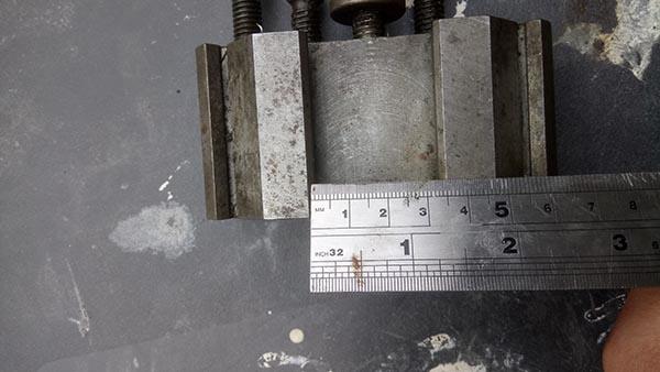

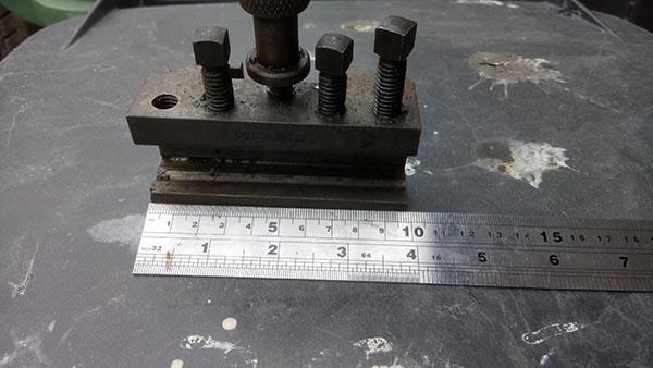

Toolholders certainly look like T2 size, There are three of them. as you can see they are missing a couple of screws, but that should be no big deal for your Holbrook to rectify :ddb:
Looks like new ones are about £35, so how does £20 each sound? Assuming they would be of use to you...

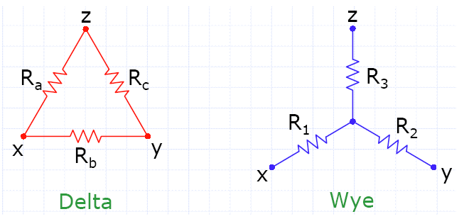

« Reply #7 on: June 26, 2017, 05:27:42 PM »
3-Ph. star connected motors don't use a neutral.
The star point is not generally brought out as such. It's just the ends of the three windings that get connected together.
Pic. gives the general idea,  just swiped off the net.
Delta = Mesh, Star = Wye. Different names for the same thing.
D.

« Reply #8 on: June 27, 2017, 07:35:33 AM »
Bluechip - thanks that makes sense, i guess a motor is inherently a balanced load, so doesn't need a neutral..

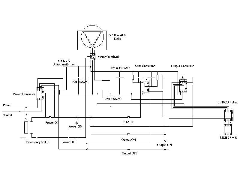

The RPC is currently coming together (slowly, waiting on the proverbial Slow Boat from...), built on a budget:
5.5 KW (7.5HP) 3-phase 415v 4-pole motor off EvilBay for £70;
Oxford 180A oil-cooled welder (ancient, 240 and 415 tapped primary, 6.5 KVA *continuous* rating, peak 11 KVA - should do the job!) £19 off EvilBay;
32A type-C MCB for 240v input, assorted contactors, 9-13A motor overload (plugs into motor contactor),16A 3-phase MCB, 40A 3-phase RCD (EvilBay) between £5 and £15 each;
Handful of "RUN" rated capacitors for the motor start circuit (50, 100, 200, 300 uF 460 acv - to mix and match) £5-£8 each on EvilBay;
3 off on/off/lamp pushbuttons £1.99 each on EvilBay;
24v control transformer (for contactors and lamps) from my junk pile;
pair of 16A 3-phase sockets (junk pile);
small electrical cabinet with the door cut out and replaced with some Alupanel to take meters, sockets, switches etc., 2.5mm/4mm SY braid-covered cabling to hook bits up, all skip-dived at work :);
lily-gilding: 3 off 500vac meters for phase-to-phase; 3 off 20Aac meters for the phases and a 50Aac meter for the input, £5 - £8 each, guess where; 24v panel lamps for fault indication £1.29 each....
Soooo - a couple of hundred quid, with careful shopping?
The motor and transformer are both a little bigger than I was expecting so they'll be living outside in a kennel built from some leftover Dexion shelves and angle!
The RPC is probably needlessly complicated, but not a patch on the VFD implementation on the lathe...

« Reply #11 on: June 29, 2017, 07:38:08 PM »
Not the final wiring diagram, I keep revising it, but a starting point:

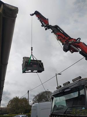

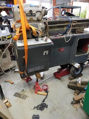

So, after much delay, the lathe rebuild is inching forwards again.
New house, new workshop, new baby, and my wife suffering from some health problems have pushed this to the back of the pile. but it's now in the new workshop, with the help of a crane over the house as it is too wide for the alleyway  :doh:
Once into the workshop, it was lifted off the trolley with a chain hoist & truck on the steel beam in the roof. slid across the steel beam, and then stuck - cheap Chineseium chain hoist refused to lower! Lifted the lathe of the hoist with a precarious arrangement of jacks, stands, and wooden blocks.
Strip and rebuild the hoist, lower the lathe about a foot and the hoist jammed again. so, the lathe is now on blocks, about 200mm off the floor waiting for this weekend and a game of workshop Tetris so that I can get the engine crane behind it and finally move it into place...

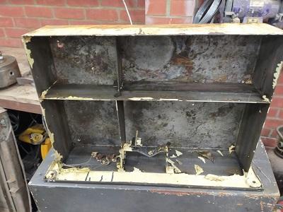

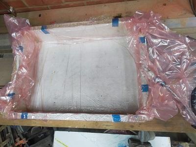

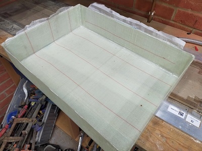

Meanwhile, I have managed to make a new glass fibre sump - I counted 18 separate holes in the steel one from 50p size down to pinprick. Much as I need the welding practice, I think I would have spent a very long time getting those watertight.
Old corroded tray, biggest hole top left, others scattered evenly about the place.
Melamine faced chipboard mold, e-glass / epoxy prepreg, under vacuum and ready for cure
finished tray, ill add the baffles and motor mount later when I've decided on which coolant pump to use.
