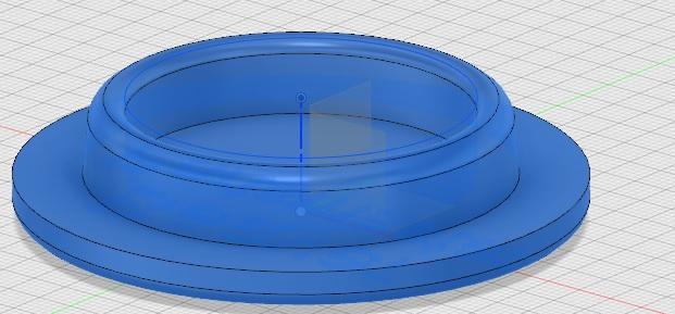

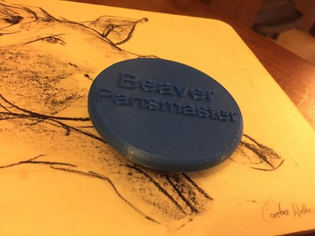

My bits I've been making on my Cetus 3D printer have all been drawn in Fusion 360, which is free to the hobbyist. I have also made bits on my CNC mill with it.
It is very comprehensive, and when you learn it it will do most things, but I am still getting to grips with it and it is rather a struggle, but I am getting there - made this bung to block up a hole in my Beaver Partsmaster CNC mill that I bored years ago to facilitate wiring up my Servo Driven 4th Axis
It came out quite nicely in a blue plastic  :clap:

The only downside with Fusion360 is that it demands a 64 bit machine - I had to source one specially as all my others are 32 bit  :scratch:
The bung turned out ok as per picture below

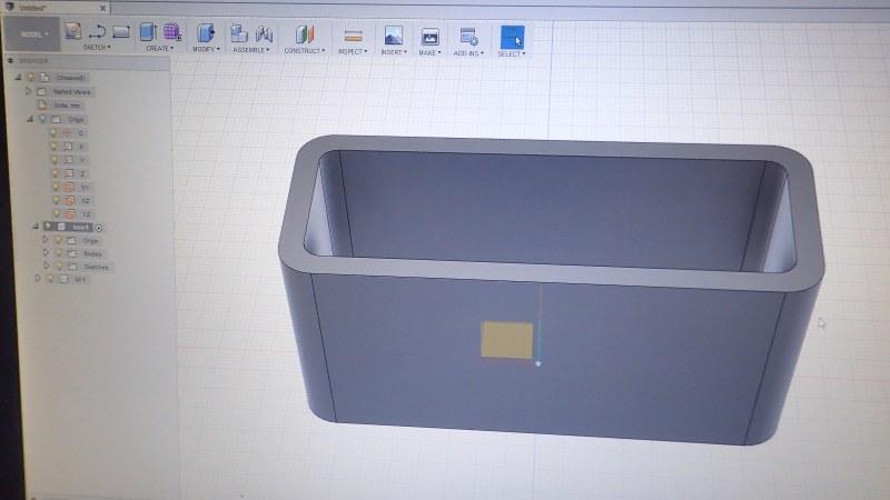

Installation was easy. Working is pretty fast - least on mys simple sandbox :lol:
But my learning is slow.
Another thing I that my screen says "Term ends in 30" days .... bit worrying. I have to google a little to find out if I can downgrade licence to hobby use.

« Reply #36 on: June 04, 2017, 04:55:15 PM »
Nver used 3D program before and it shows...I'm on absolute beginner tutorial #3 and got stuck on middel of it.
https://youtu.be/zS8dYA_Iluc?t=608
There are gour locating ribs on the lid....his version is a little diferent on tutorial than I have and some stuff comes out a little difrerently...but today I gost stupped. Made extra plane for sketch drafiting, made the sketch - on wrong plane, probably on origo insted of the offsetted plane and when I tried to assign the sketch onto this auxiliary plane, fusion crashed.
Gave up for tonight....ast hinkking of making an extrusion offset from the box innards, instead of four different ribby things.
Anyways, should make actually something usefull, but I want to follow tutorials first least until I'll get into constraints.
