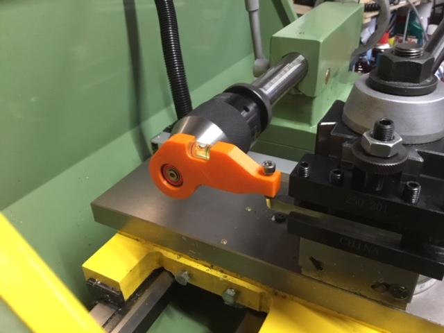

It's been a while since I posted any 3D prints, so heres something I squirted earlier...
I was looking at the lathe tool setting devices from Edge Technology and of course, anything that can be machined in alloy can be printed in plastic  :ddb:
Before making a start I did a search to see if anyone else had done one.  This popped up on Thingyverse, it's a useful starting point.
https://www.thingiverse.com/thing:1010033
I loaded the IGS file and looked round to see what parts I had to hand.   Inline skate bearings, a cheap plastic level that came with a set of Bosch drills.  I actually scored 3 vials in the level, but opted to use the 25mm x 10mm one.   This didn't match the one used in the 3D model I just downloaded.  A bit of time in Rhino got me a useable model that would also make use of my bearing.
I output the model as an STL file to Simplfy3D (use whatever slicer) to configure the print as i wanted it and orient parts.  The slicer also added some internal support for the print, shown in grey.
Off to the printer for a couple of hours, whilst the dog gets a walk and we make tea.
The printed parts and other bits ready for assembly, well... just push them together really.  The body needed the 5mm hole tapping to take a bolt I had earlier polished flat on a diamond stone.
Here is the first test of the components together, I need to set the screw with nail varnish and probably glue the plug in too with varnish.  The vial is a firm push fit so no worries over that falling out or getting out of alignment.  It's just resting on the shank of an 8mm drill for now, I will make a proper shaft for it to go on later.  Other than the print time it was pretty much a couple of hours work and hopefully a useful tool for the lathes.

How do you calibrate this when the lathe is not level, for example, sitting on a sloped garage floor?
  • Posts: 1321
Re: A useful 3D print
« Reply #8 on: April 30, 2017, 12:43:13 AM »
Use a second level across the bed and initially match the bubble positions.  Once the tool height is correct you can then adjust the setting tool bubble to centre.  It means the level tool can only be used on this machine accurately.  But they are cheap enough to make one level per machine.
Lock the adjusting bolt with nail varnish.
The flat area along the bottom of the tool is the centre line of the bearing, so a set square base pressed against it allows the bolt position to be initially set. Do a test cut and see if you still get a pip, adjust the cutter as required.  That way you don't need a second level, as above zero the bubble once calibrated.

« Reply #9 on: April 30, 2017, 02:20:18 AM »
Example...
This is how I do the initial setup for the bolt position, it gets you pretty close.
Now setup a level on the bed and get the bubbles roughly in the same locations.  You really are going to be out by a tiny amount unless the ship your lathe is on is in heavy seas.  :lol:
Saying that, the old workshop in Christchurch was very much rock and roll.   :headbang:
The above photo was staged using a washer under the tool and under the level, but you get the idea.
The workshop floor isn't level and the lathe is really out this much, but as mentioned before, a test cut confirms if your on centre, then adjust as needed.  Once setup all the following tools can be set.
It sure makes swapping tools out in my limited number of quick change holders a lot simpler and quicker.

I must admit that despite having the Edge tool on a rack by the lathe I still tend to use the 'trapped six inch ruler' method, then maybe a tweak after a test cut.
The ruler method works on the actual contact point of the tool, whereas the Edge tool rests on the top, so if there is a chip breaker groove for instance, or the tool has negative rake it's not strictly measuring the correct place.
  • Posts: 1321
« Reply #11 on: April 30, 2017, 02:43:09 AM »
Good point on insert tools.  However if you're a mere mortal like me using HSS and key steel on an off day  :doh:
This setup works fine, you could always add an extra line to the vial for your insert tools  :med:

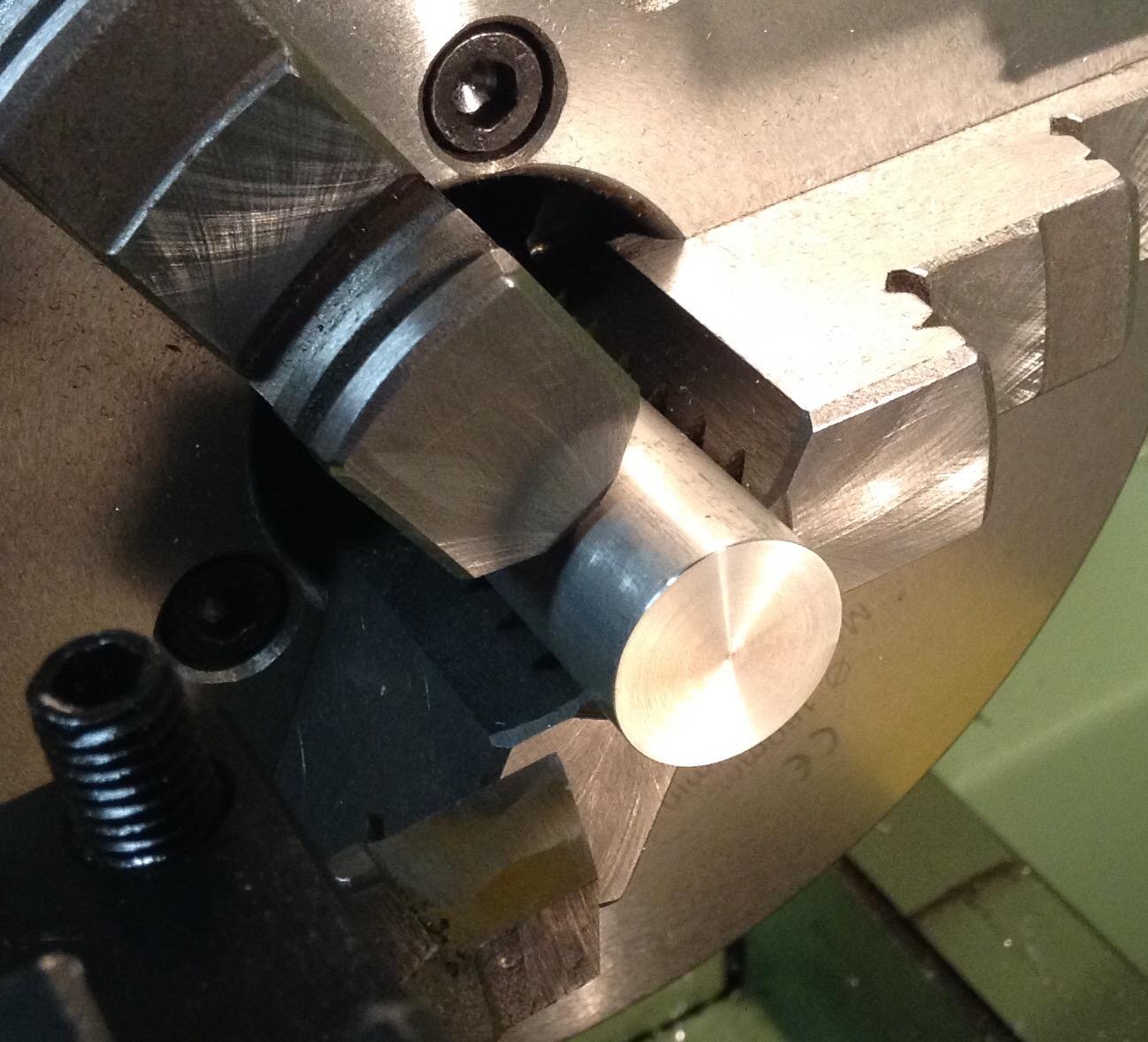

Finally, some workshop time.   Here's proof the level works...  No pip
