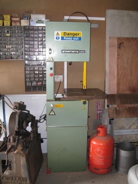

Startrite 352 Bandsaw mods
« on: April 10, 2017, 03:12:59 AM »
I have been trying to pick up a nice metal working bandsaw for a while but they are all huge and expensive  :bugeye:
At the weekend I was dragged over to look at pricing up some WOOD  :palm: machine tools for a friend. Honestly I would not have touched them but the Startrite bandsaw under all that saw dust has potential. The deal went: I could not have one I had to have all of them and they will be delivered next Saturday. What have I done all I wanted was the bandsaw and I have been conned into taking a big wood lathe, a planer and yet another pillar drill, wood tools are not allowed in my workshop so they will have to go. In the meantime they can sit outside so that my boys don't think I have gone over to the dark side.
Leaving me with the 352 bandsaw....
I have no idea on the speeds all it says is low and high on the back  :( It does mention cutting brass but I will want to cut steel as well. I was thinking whip out the 240 volt electrics and fit it with a three phase motor and a VFD. The other option is to fit an additional pulley set to drop the speed. Has any one done this to one of these?
There is also an issue of blade guides: It seems to have a couple of pieces of plastic acting as blade guides... I thought most decent machines had ball bearing guides, or would bronze work....
Jo

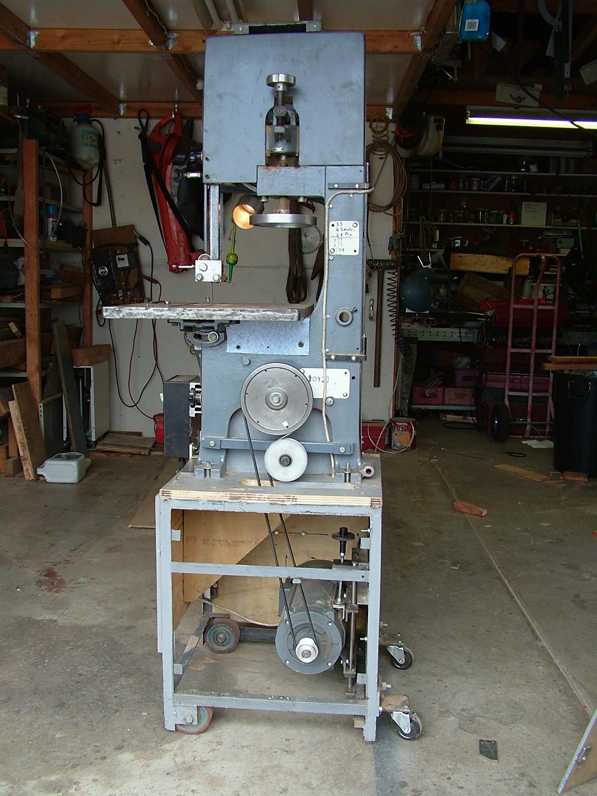

Offline Jasonb
  • Posts: 451
Re: Startrite 352 Bandsaw mods
« Reply #8 on: April 12, 2017, 12:07:14 PM »
Nothing wrong with the solid guides Jo so I would leave them as is for now. As you know I use my old small vertical bandsaw for metal cutting and that had graphite impregnated plastic guides though a good oily hardwood also works well too.
Can't really complain about the cut it gives and very straight too, this is 3" sq 6082

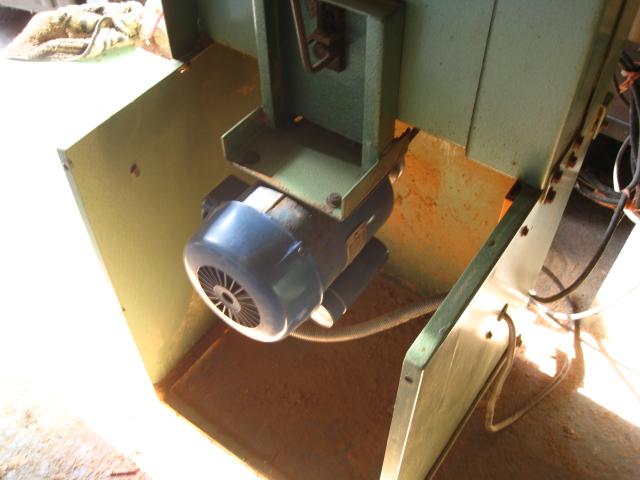

Offline Jo
  • Posts: 160
« Reply #12 on: April 12, 2017, 02:55:47 PM »
Thanks Pekka,
The first stage is to fit a 1425 motor, that will halve the speed to start with and should be an easy swop with another 220V mains one. The items that use the higher speed setting I don't need it to cut..
I am trying to avoid fitting the second shaft. It still may be the way to go.
