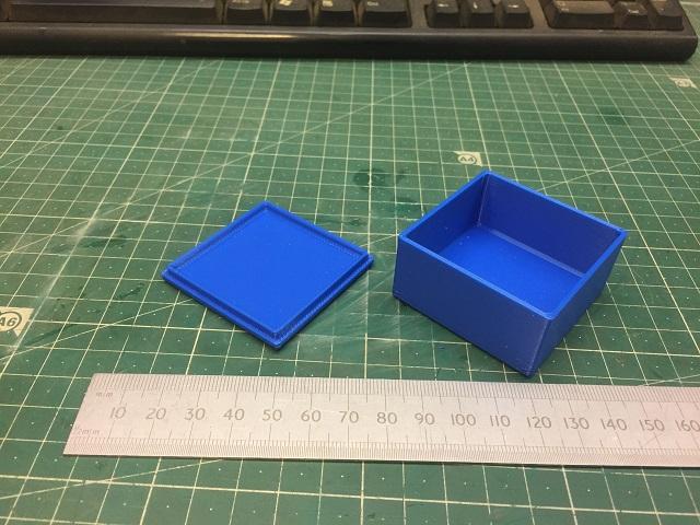

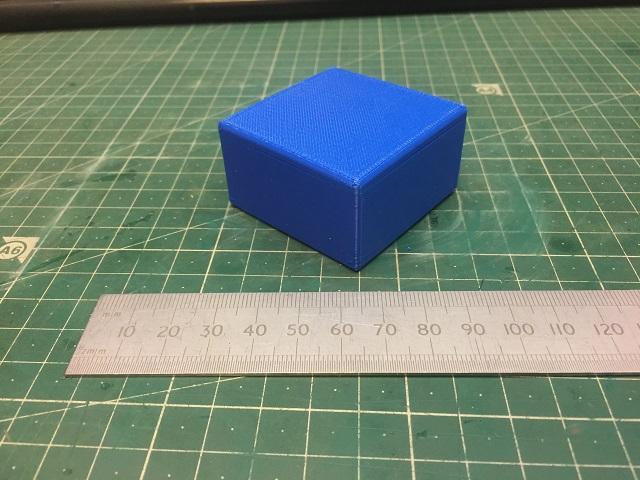

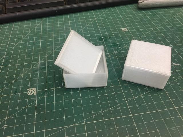

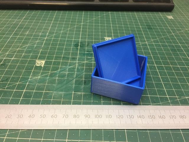

Today I made a little box - nothing very exciting, but it was a Autodesk Fusion 360 learning exercise for me. I wanted to make a drawing where the walls and base of the box are a defined thickness, but the other dimensions can be stretched or shrunk - a sort of parametric model. In this case I just concentrated on the base, and it nicely stays at 3 mm thick as I stretch or shrink the height  :thumbup:
It has also proved to be a useful calibration check for X & Y accuracy, as the lid (a deliberately tight fit) fits just as well both ways round  :ddb:
Altogether a handy exercise. Printed in cheap eBay £10 / kg PLA filament, which is definitely not as strong as the stuff you get from e3d but about 1/3rd the price  :bugeye:
The Z axis spring balancer is slated to arrive tomorrow, so if it does I'll follow up with a few pictures

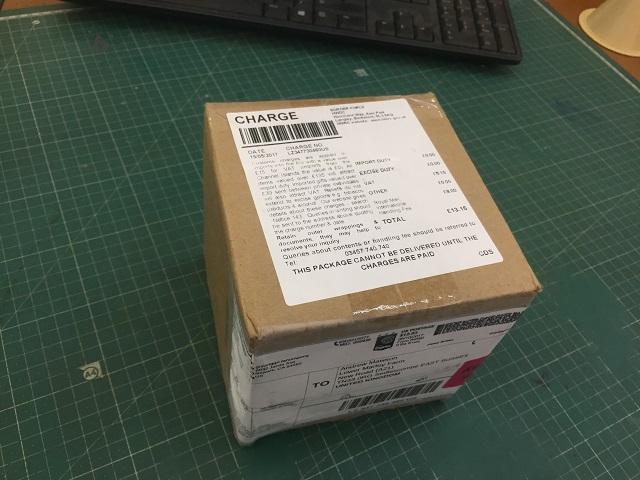

« Reply #83 on: May 23, 2017, 05:16:26 AM »

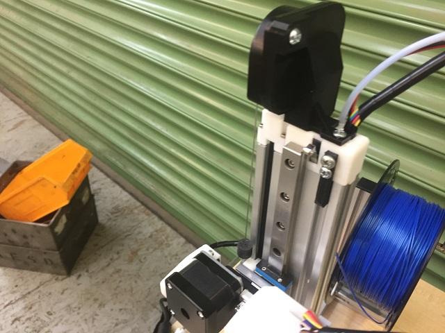

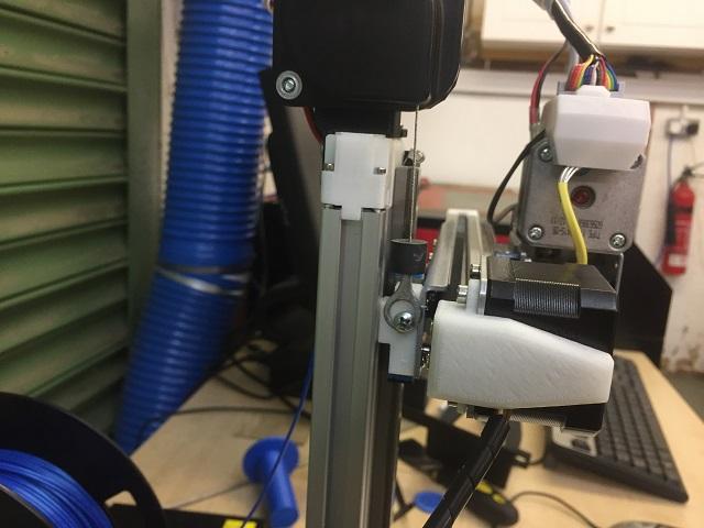

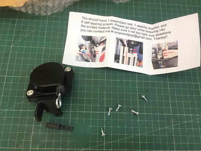

The Cetus3D has an inherent problem, in that when the power is turned off, the Z axis rail having little friction allows the Y motor and assembly to come crashing down onto the bed if you don't remember to hold it  :bugeye:
Several people have devised different solutions but I decided to use one based on a counter balance reel sping as it seemed a neat idea. No point in re-inventing the wheel so I ordered a kit.

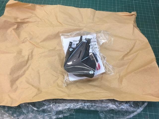

As promised today Steve the Post Man brought the Z Balancer modification kit. This is a  kit put together by an enterprising user in the USA who solved the problem on his Cetus3D by finding a suitably small coiled wire spring balancer (rated at 2 lbs) to just give the assembly neutral buoyancy  and drawing up and printing some bits to allow it to fit on the upright extrusion and take the weight of the Y axis and motor in the Z plane.
Fitting was pretty straight forward - slightly unnerving screwing self tapping screws into the printed bit of the Cetus, but all went well (apart from the inevitable disappearing screw  :bang:)
Works well and to prove that it doesn't inhibit anything else the machine is currently churning out another box  :thumbup:

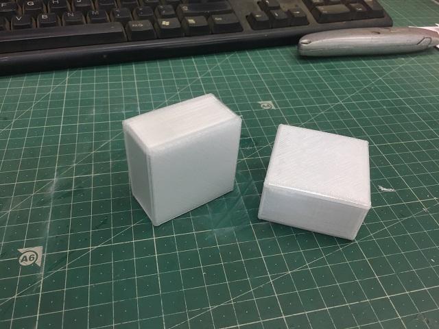

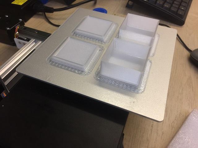

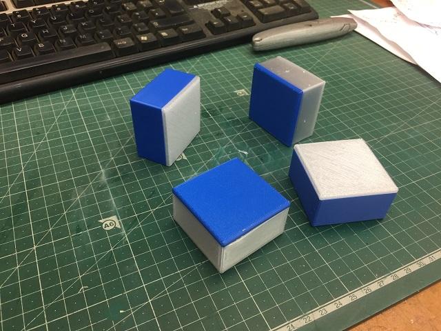

The Pet-G printing tests were a success  :thumbup:
I printed a pair of the boxes and lids at exactly the same settings as previously when printing in PLA, except that I upped the nozzle temperature to 240 deg C. No heated bed (not turned up yet!) but it seemed to cope OK.
I did notice that the raft was markedly more difficult to peel from the model. To test the size compatibility I tried PLA lids on Pet-G boxes and vice versa and they fitted fine. Subjectively the Pet-G in more flexible.
Re: Cetus3D 3D Printer
« Reply #90 on: May 24, 2017, 04:41:41 PM »
Those look good. You printed the same design out of PLA and Pet-G? Are they same size?
« Reply #91 on: May 24, 2017, 04:59:26 PM »
I've not actually measured them, but as the lids and boxes are interchangeable I'd be very surprised if they were not essentially identical

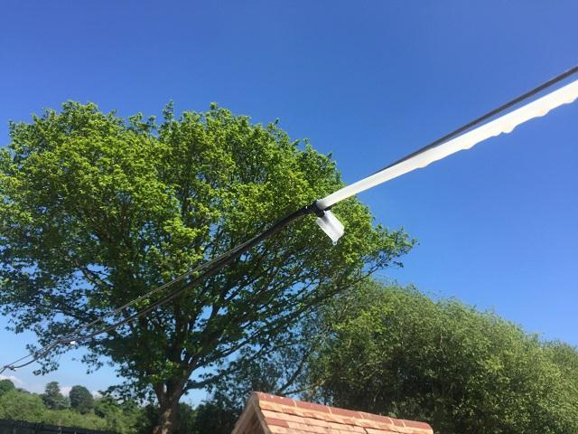

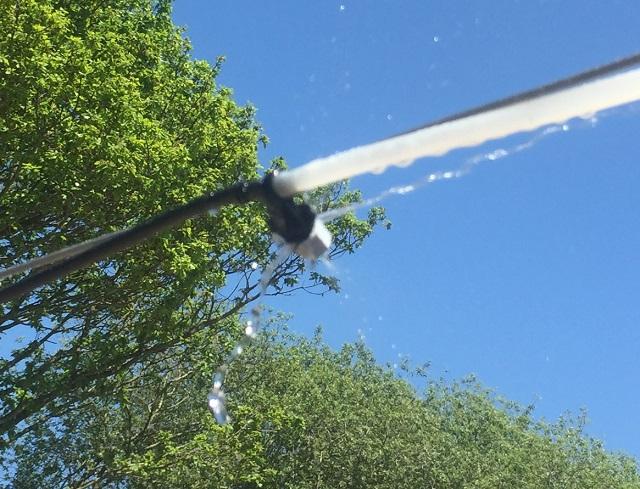

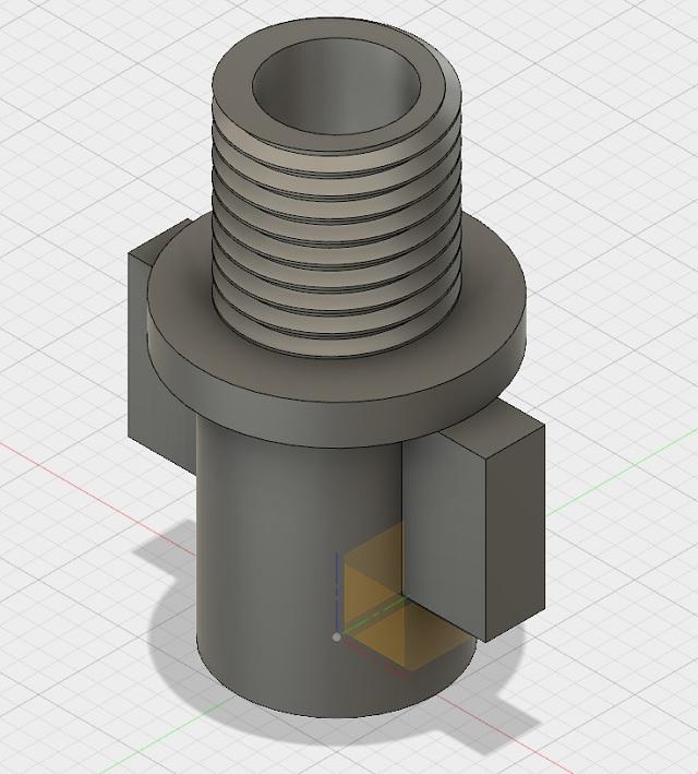

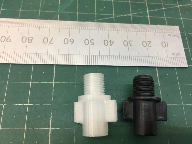

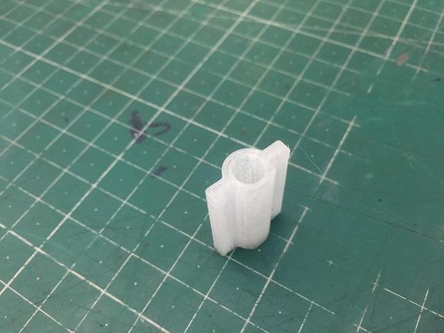

Last year I rigged up a 'Hydroponic Pig Cooler', and had occasion to use it yesterday and today:
http://madmodder.net/index.php/topic,11459.msg134238.html#msg134238
Trouble is, one of the fittings was badly cracked and instead of a mist was giving a spout of water - probably frost over the winter.
So what do you do if you have a 3D printer - print one of course  :lol:
Initially I drew up and printed just a simple end cap to block off the offending outlet while I was drawing up the proper fitting, and this went quite well
« Reply #93 on: May 25, 2017, 11:25:59 AM »

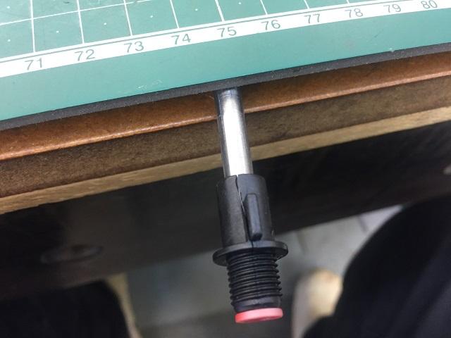

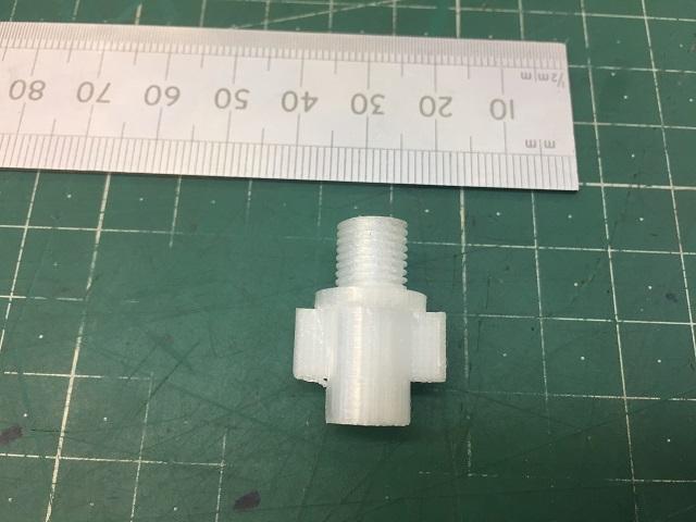

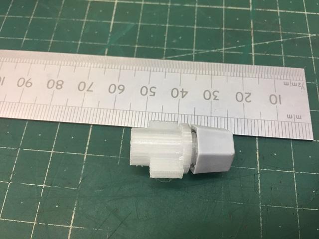

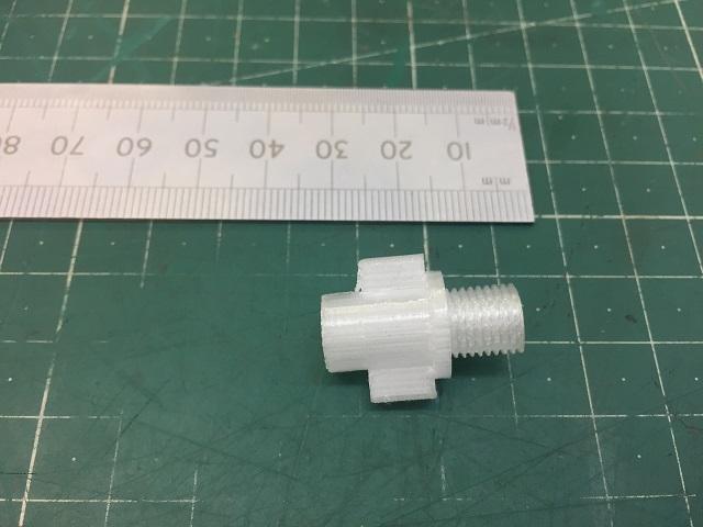

Then I drew up the proper thing, but the spray orifice screws on with a M9 x 1mm pitch thread - rather fine to print and I have no die that size.
Having printed a 'threadless' one I thought that I'd have a go at the thread setting the printer to its finest resolution but still the 0.4 mm nozzle, and to my amazement it produced a working thread  :ddb:
I'm VERY impressed with this printer  :thumbup:
« Reply #94 on: May 25, 2017, 12:17:23 PM »
Not surprised, that's bloody good.

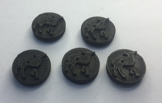

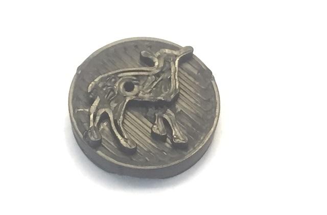

The uses for this little toy are endless  :ddb:
Wife is knitting a cardigan for very young offspring of a farmer friend - Ba Ba Blacksheep theme complete with picture but bemoaned the fact she couldn't find any suitable buttons - well print some  :lol:
These are 15 mm in diameter - sorry - forgot to include the ruler  :hammer:
