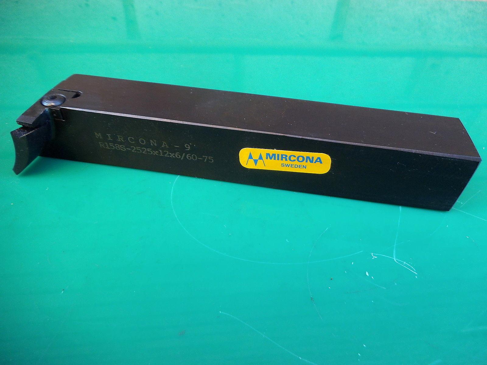

You need one of these Brian:
http://www.ebay.com/itm/391730204091
See attached (large) pic for details. It takes a V-bottomed insert, so you can plunge AND cut sideways with it. SO with that particular tool, you'd plunge at between 60-75mm diameter, then cut inwards/outwards as required. That particular one is a bit of a fat one - requires a 6mm wide insert - they come in anything from 3mm upward (insert width).
I have several of these tools, but never actually found a use for them... maybe I need to set up a flywheel relieving service  :D

Brian, could you not have machined it on the vertical milling machine on a rotary table with less strain on your nerves?
Awemawson--The thought did cross my mind. I opted for the lathe because it is marginally quicker. I have a 3 jaw chuck mounted on my rotary table, and I think that with the reverse jaws it could hold the part. Even so, considering a .010" depth of cut and a 3/4" endmill, that's a lot of cranking to put in a recess 1/4" deep.
