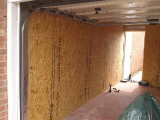

I used the thinnest stuff I could get my hands on, which was (I think) 11mm. I used 600mm stud spacings. I did put noggins between them all, but had to knock most of them out as I managed to set them at the exact height I needed my electrical sockets... (oops).
The 11mm thick wall with 600mm stud (2x3 planed) is plenty strong enough, and my walls are all free-standing, not attached to existing walls like yours will be.
I haven't used any insulation on the outsides (too difficult to get to), I will use rockwool on the roof & the one wall I do have good access to.

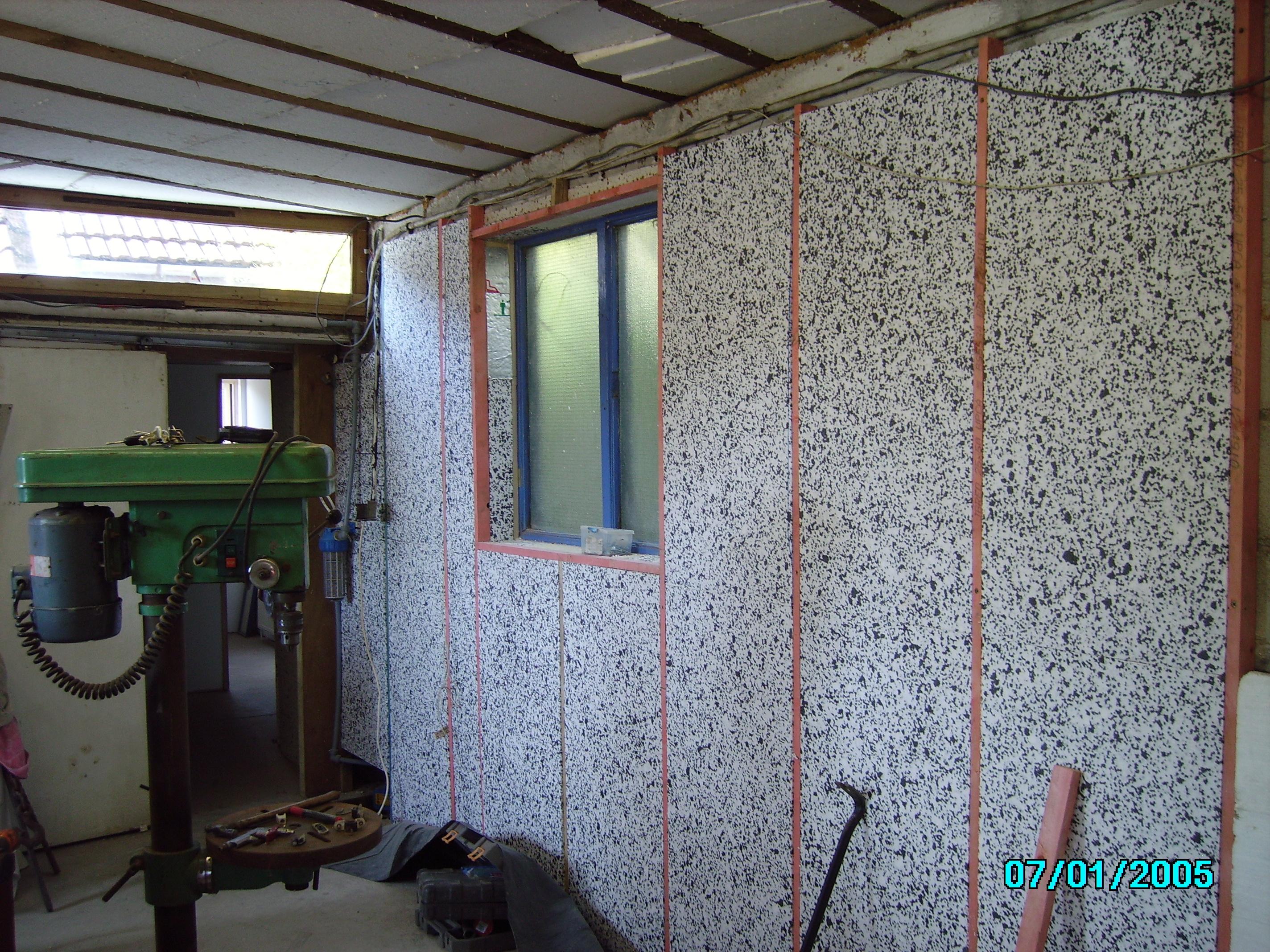

When I did mine I used loft insulation. The government were forcing the heating companies to help insulate people's houses and for £3 a huge triple roll of 6" thick stuff, they would deliver it and let you fit it yourself, minimum order was about 8 rolls.... The Insulation was secured to make sure it did not sag and spaced off with 2 by 4s, so 6" of insulation is in a 2" gap.
On the inside I have use the thick flooring grade (= waterproof) chip board. Slides nicely together with out any gaps and also works for ceilings and has the advantage you can stand on it if you must :thumbup:
And for some reason I ordered enough extra insulation so that I could do double layers of insulation above the workshop as well   :coffee:
The only failure in the design is the builder who put the garage up for me did not insulate under the concrete flooring, He thought the tools would bee too heavy :bang:.
Jo

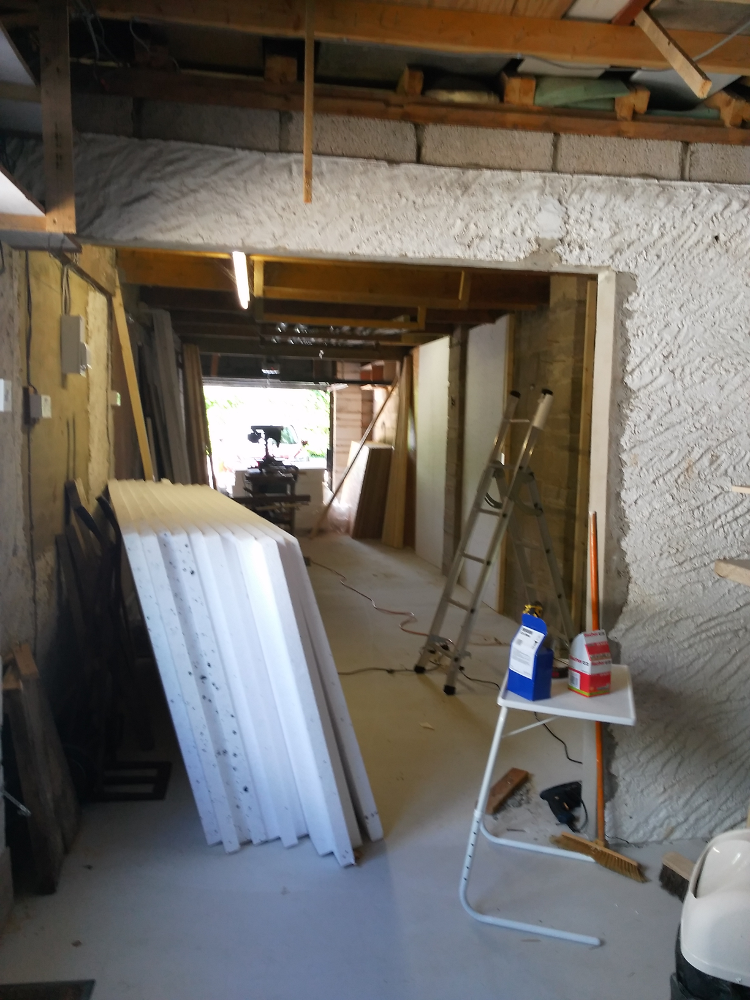

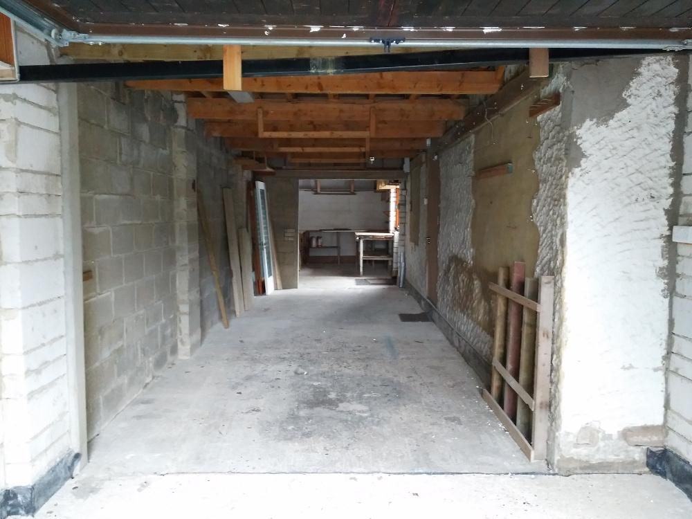

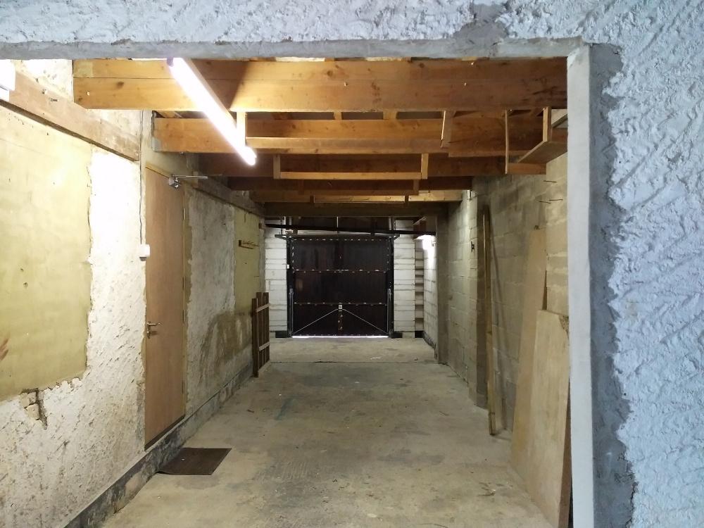

« Reply #12 on: April 21, 2017, 05:47:45 PM »

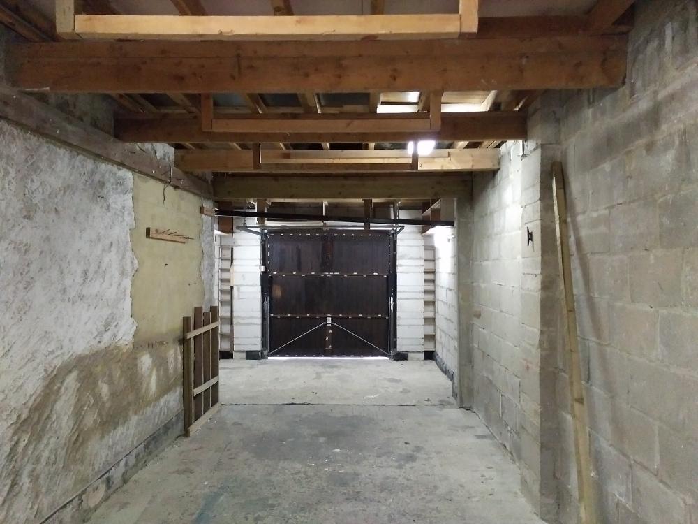

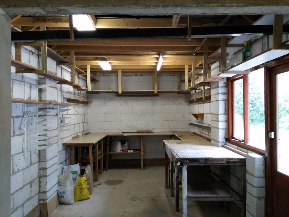

Pictures of interior. Ceiling is 2.4M high. 16M long and 3M wide on average. Should make a good shop :thumbup:
Thanks for the info
Best Regards
picclock

The exterior walls are solid concrete blocks - no cavities. My current thinking is 12mm osb with 30 or 40mm celotex on 50mm battens which will leave a small air gap behind, supposedly for a vapor barrier - which I don't understand. :scratch:
Not sure what to do about the floor which is a concrete slab. Because the building has been extended the slab has been cast in two parts. Looking at the planning permission info this was done in around 1986, so I,m not sure if planning regs. stipulated foam under the concrete back then for insulation. On the plus side there appears to be no damp at all so it likely works however it was done. Initial thoughts are to just paint the floor with garage floor paint then cover with lino - as I currently have. Any other ideas most welcome.
Best Regards
picclock

Thanks for the feedback and further assistance.
I finally got someone whose been doing it for 13 Years. I tend to use checkertrade or mybuilder.com as they have customer feedback, and can supply local artisans. Problem was despite contacting three lots on checkertade with two no replies and one request to visit and assess who didn't turn up, and then trying on mybuilder with no results I was getting a bit desperate, but mybuilder came through. The chap does car showrooms and similar and has some good pictures on Facebook. After a visit he reckons it will take about 30 bags of latex self levelling compound. He is round Friday to seal it and fill in the deep areas, then him and a mate will do it Saturday morning.
Will try and post before and after pictures. Its a very deceptive floor in that its only when you put a straightedge and level on it you can see how bad it is. There are very few places where my ladder will sit with all four feet touching.

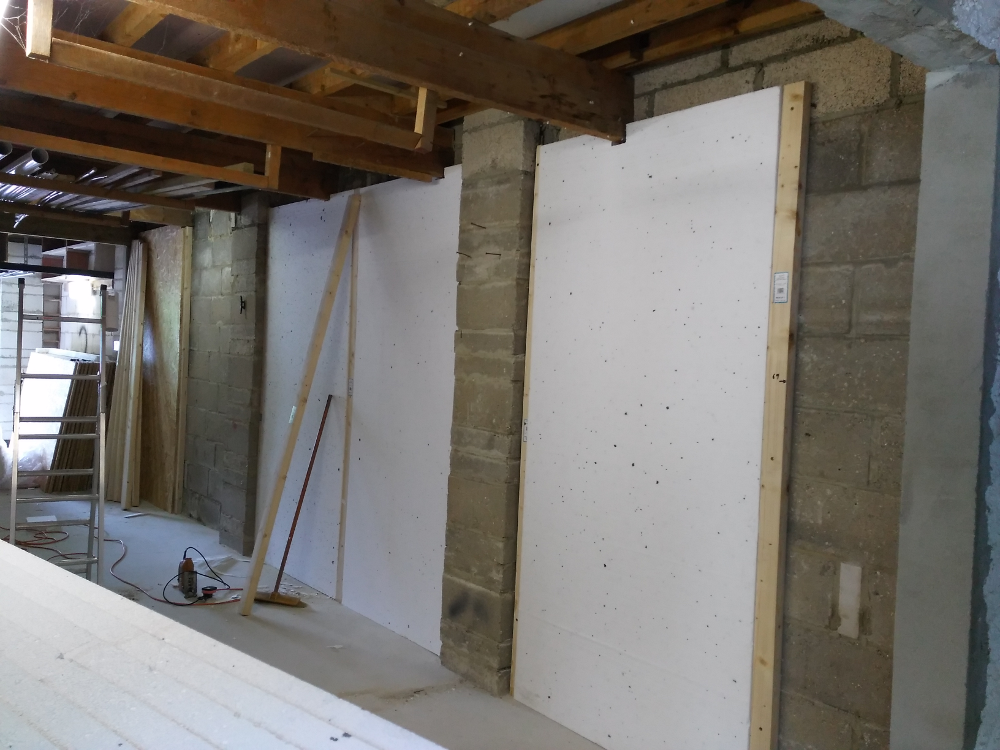

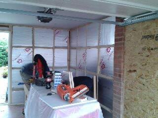

The floor is latexed  :thumbup:, but the finish is not as good as it should be. The chap doing had cut his knee with a hooked stanley blade and it was stitched up by hospital, which along with the painkillers may have contributed to the issues. However, its adequate and miles better than the crumbly concrete that was there before.
I have just started putting up the battens and insulation which is going well on the whole. Although I have fitted one OSB sheet its too heavy for me to handle on my own so I am getting some help in for that. For the ceiling I have decided to go with a suspended one with insulation on top. Have done quite a few tests on LED bulbs and the two winners are Integral 12.5W for 1521 Lumens and the philips corepro 13.5W @1521 Lumens. They are both about £5 or less depending on quantity, but the Integral lamp has, to my eyes a higher CRI, and uses 8% less power. The supposedly high output junk on ebay is a shadow of the winners. Used a light meter to measure.
I do have a problem with fitting the cut down sheets of polystyrene. The full size sheets work OK but when it comes to the ends of the wall next to the piers they are never square or straight, often waisted in the centre. Its no problem cutting to the shape, but transferring the required size to the sheets is proving very difficult. I am getting by by hand cutting in the last few mm with a stanly knife, but I am sure there must be a better way. Any thoughts or ideas in this area much appreciated.
Best Regards
picclock
