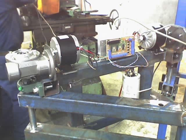

I've used mach3 to control a mates scara arm with a grab on the end. You can key in formula that compute output positions for real axii (usually the rotary ones) based on X and Y.
Might have a pic somewhere....

Offline PK
  • Posts: 369
Re: How does CNC _actually_ work?
« Reply #6 on: April 14, 2017, 06:16:14 PM »
I thought Mach 3 had limitations on what it could do?
I admit it was some time ago, so I just went out to the shed and checked.
Function Cfgs->Formulas, whilst notionally for screw pitch error correction and bed leveling, allows you to implement arbitrary kinematics..
