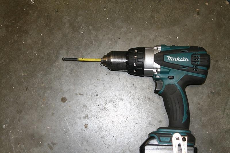

Saw a glance of one of these on a Youtube video, a three-lever vice handle, and thought it would be interesting to make.

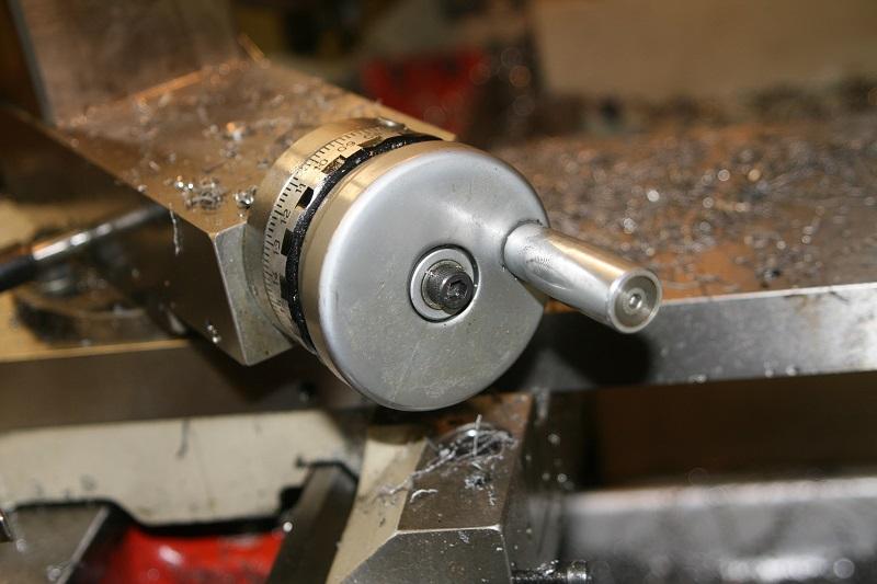

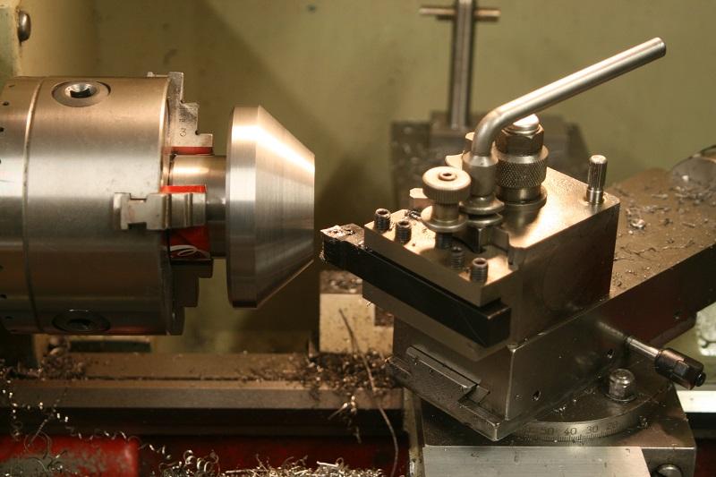

Having made the square hole for the vice shaft by using the lathe as a shaper, next job was the angled section. Not sure if everyone knows the dodge of a power top slide.
I replaced the small countersunk-head allen bolt, with a full-headed one. Chopped the end off a ball drive hex key and popped it in the drill.
This makes it a doddle to get a consistent speed across the whole of the angle, made more awkward with the top-slide handle being at the rear.

Must admit Pete i hadnt thought of that one, nicely filed away for future reference.

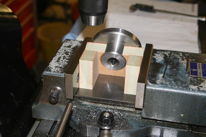

Next job, to drill the three handle holes. There was a handy bit of 25mm WR mdf just waiting to be used for a little fixture.
Drew it up, then cut it out on the router. The two angled pieces hold the main piece at 18° off the vertical.
Prior to removing from the lathe 3 Jaw, I scribed a line across the angled face using a pointy-piece in the toolpost, and positioning a short length of bar under each chuck jaw in turn.

By the way, you did not need to have the compound slide handle at the rear. You could have spun the lathe in part in reverse, cut on the far side of the piece and feed from the front.
I hope you understand what I mean.
Jacques
Sent from my SM-N900V using Tapatalk
Offline Spurry
  • Posts: 348
  • Norfolk, UK
Re: Vice speed? handle
« Reply #8 on: November 24, 2016, 04:45:19 AM »
Thanks for the comment Rob.
Jacques - that was my first thought too. But the cross slide ran out of travel, as well as exposing the cross-slide screw to the anticipated swarf. If enough time had been spent experimenting, with tool reversal, spinning the tool post etc., it is possible there would have been a method. The easiest for me, was to spin the cross-slide backwards (for want of a better expression).
Graham - lest I forget. I did not give the reversal a second thought until I read your post. The cut was carried out with the screw moving clockwise, and only dragging when in reverse. I have been using this stunt for some years, and it could well be that the screw is secured with a little Loctite. :-)
Your interest is appreciated.
« Reply #9 on: November 24, 2016, 05:07:53 AM »
By the way, you did not need to have the compound slide handle at the rear. You could have spun the lathe in part in reverse, cut on the far side of the piece and feed from the front........
Jacques - it also depends on how the chuck is mounted on Pete's lathe, whether it would unscrew when run in reverse.

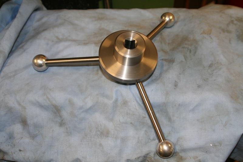

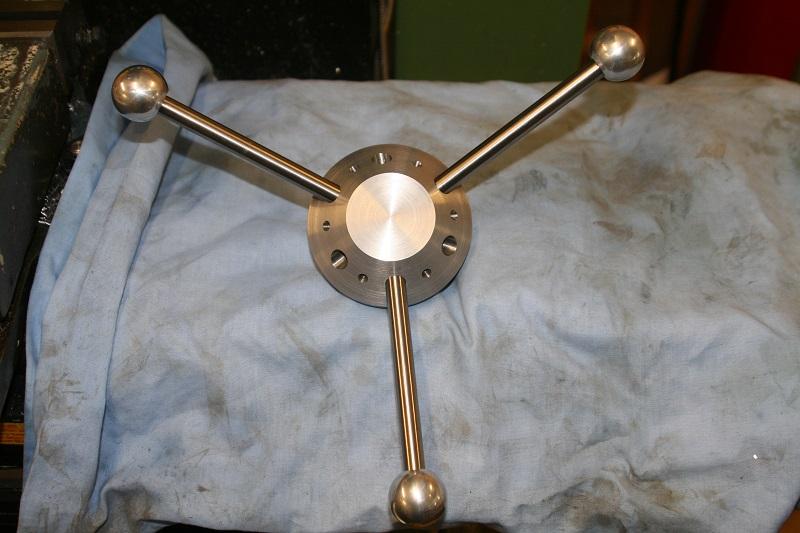

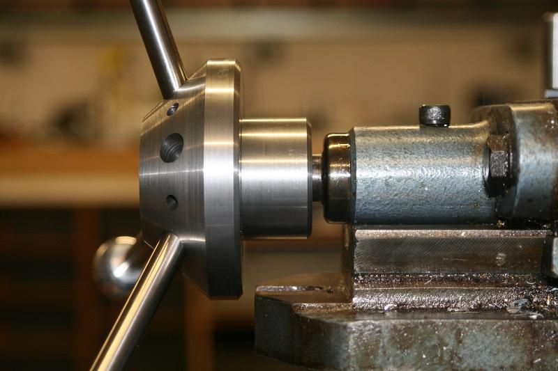

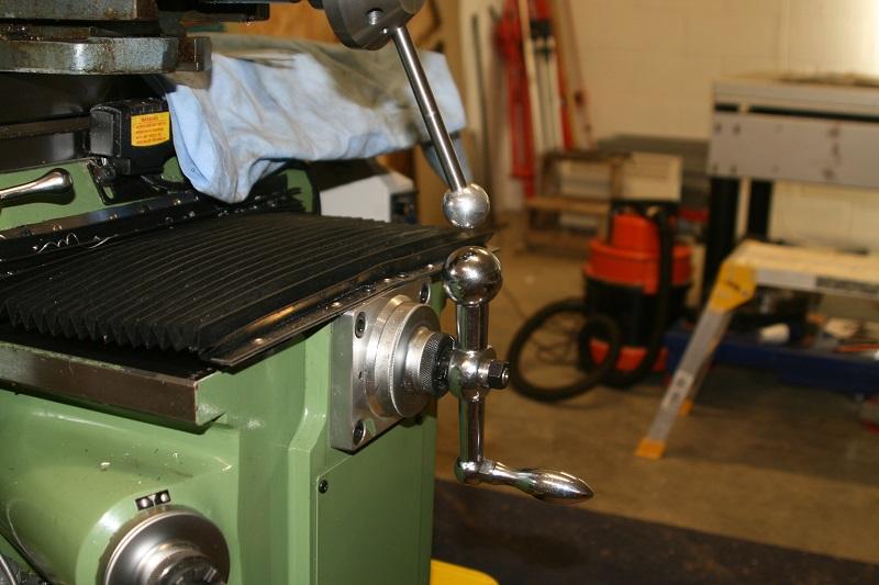

Handle finally finished. Main problem was trying to decide on the length of the bars. In the end, I decided on the maximum they could be, without interfering with the Y feed. It works really well to move the jaws from fully open to closed. Only downside is the weight, (but that might assist with the inertia to spin.) I was going to drill a complete set of 12mm holes, but could not calculate the angles and depth when they would start to break into each other , so interspersed the 12mm's with 6mm holes.
As I have yet to work out how to put words between photos, here's the list:
1. position of handle when jaws fully closed
2. back view
3. front.
4. clearance shown dictated max length of bars.
As yet, there is no sprung-ball retainer, (as advised) but will try without, and hope the experience is not too painful.  :palm:

 :thumbup: Mighty fine looking  :clap: :clap: :clap:

Looks to be a fine piece of machining and very functional too....  :bow:
