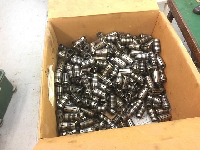

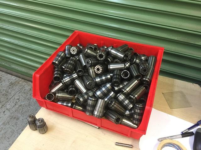

Recently I was looking for TG100 collets, and a kind fellow Mad Modder (thanks Dave!) put me in touch with rather a lot. Trying to sort them out in rows on a table proved impossible  :bang:

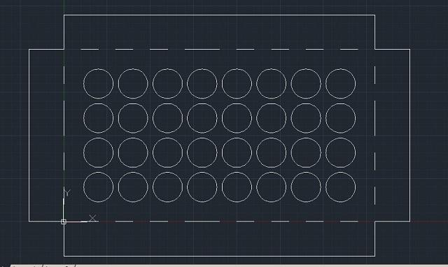

Now TG100 collets span 3mm to 25.5 mm in 0.25 mm increments (some makes cover 0.25 mm others cover 0.5 mm) so this means rather a lot of categories to sort them into - I need some collet racks  :clap:

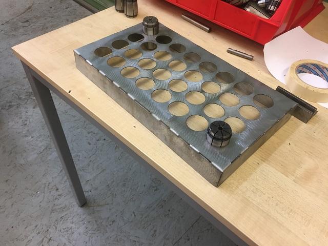

Now my best current workshop friend (My CNC Plasma Table) volunteered willingly to make me some
So , the usual thing - a quick drawing in Autocad, save as a .DXF - import into Sheetcam, port over into MACH3 running the CNC Plasma and press to go button.
I laid them out with 'upstands' so four bends in the Edwards Box Pan folder and out they popped
The results were very good considering the ten minutes from concept to finished article  :ddb:
  • Posts: 9048
Re: I Needed Some Collet Racks
« Reply #2 on: April 12, 2017, 03:37:21 PM »

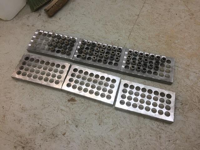

Now of course that hasn't actually sorted them - but at least I now have the tools to do the job  :thumbup:

When I sat down to draw the rack I had initially intended to cut them in plastic using my CNC laser engraver, but then realised that I didn't have enough suitable plastic in stock, but I did have a full 2.5 x 1.25 metre sheet of 1.2 mm Zintec mild steel. Actually I think the steel is probably a better choice as the plastic is too flimsy.
4 mm plywood flitted though my mind briefly, but I've had bad experience of tools in wooden racks rusting where contacting the wood - presumably it retains moisture.

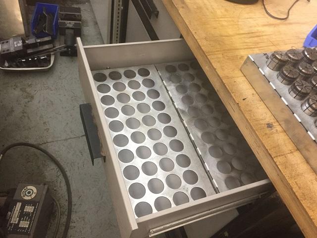

Now when I started out making these racks, it was purely to have something to use sorting out the collets, but now I need somewhere to keep the set that I'll retain for my own use. Conveniently I have a two drawer cupboard / worktop unit that lives just where my CAT40 / DIN 69871 tool holders live, and the drawer contents could be put elsewhere.
Less conveniently the drawers were an inch too narrow  :bang:
« Last Edit: April 20, 2017, 04:07:30 PM by awemawson »
  • Posts: 9048
« Reply #20 on: April 20, 2017, 09:06:12 AM »
Never mind - tweak the Autocad drawing, trim a bit off each side and make a bespoke set for the drawers. This does rather reduce the area for labelling, but I'm sure I'll get over that  :ddb:

Believe me, with 0.25 mm increments so 80 of them, and some of the marking being very faint, they NEED to be organised  :clap:
