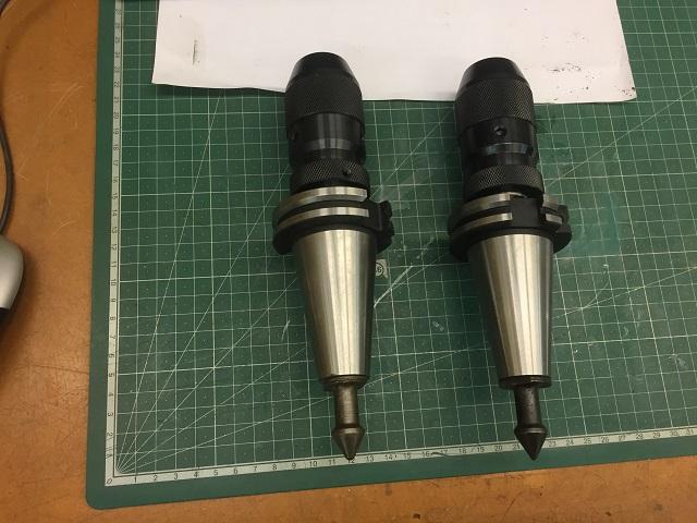

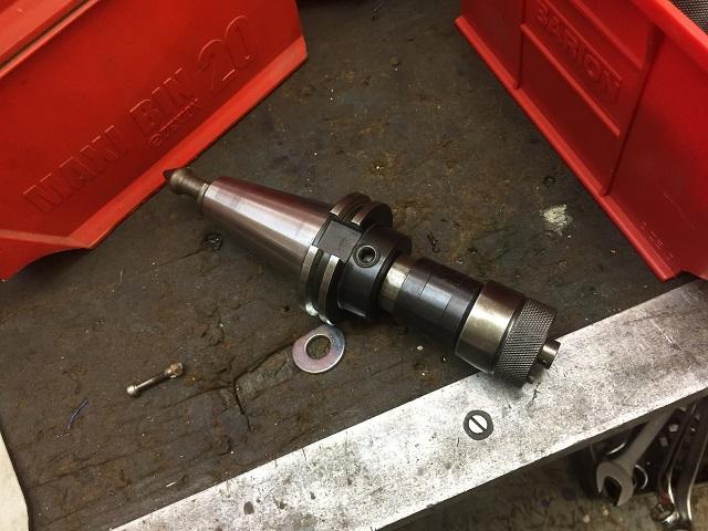

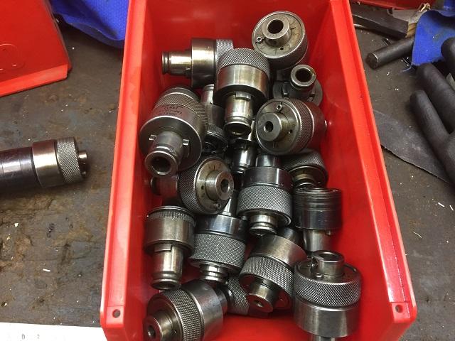

Doing the machining on my Z axis for the CNC Plasma Table involved numerous threads all of which I did on the Beaver Partsmaster using floating tapping heads, but it brought it home to me how limited my range of holders, and also drill chucks was.
So I went out on a spending spree and have invested in a second Bilz floating head and a whole bunch of collets, most of which are also 'clutch limited torque' versions - they were in a filthy condition, and only yesterday I spent a few hours cleaning them up.
It also brought home the need for several mounted chucks in the 16 way carousel for different sizes of tapping size drills - so a couple of them were added to the shopping list.
It means that the Z axis has proved blooming expensive, but I've used it as an excuse to tool up the CNC Mill  :ddb:

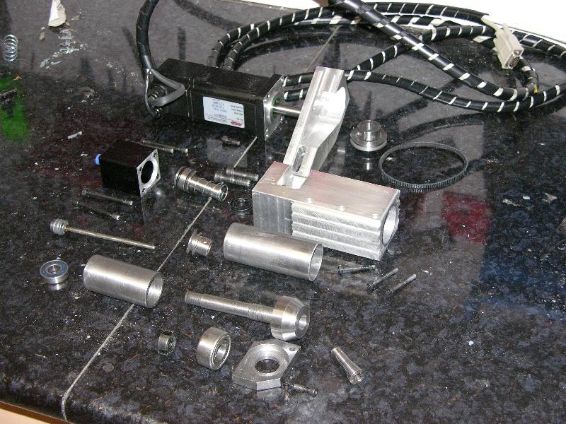

Meh! Tool changers are so yesterday! Here's one I whipped up one rainy weekend.
More here http://www.caswa.com/cncathome/spindles.html
(Welcome to troll fest folks! :beer:)
