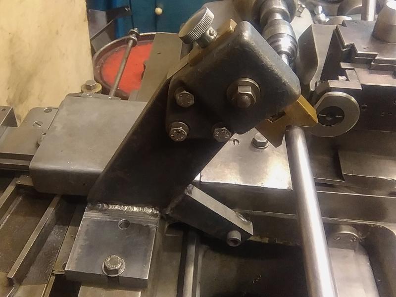

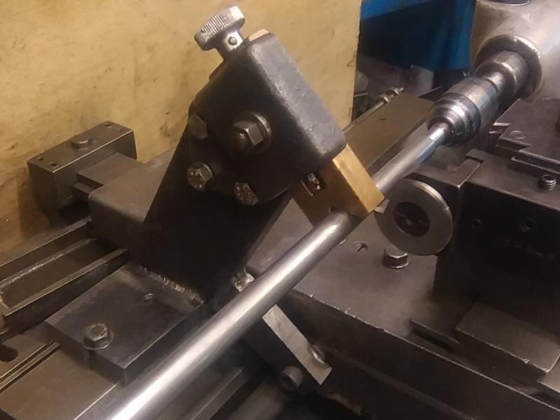

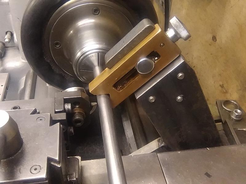

I designed and built two follow rests for my hardinge.  The first one I didn't really understand what it was supposed to do... really bodged it.  The second try rocked; I was able to extend the thread on a 1/4"-28 bolt 4" long!
The three leg trap in two planes was a huge step forward.  That let me completely control the work.
Fyi, don't use rollers for a steady.  You want the scraping/sliding action to move chips out of the way.
If you want the design files, head over to thingiverse and search for "Weldingrod".
