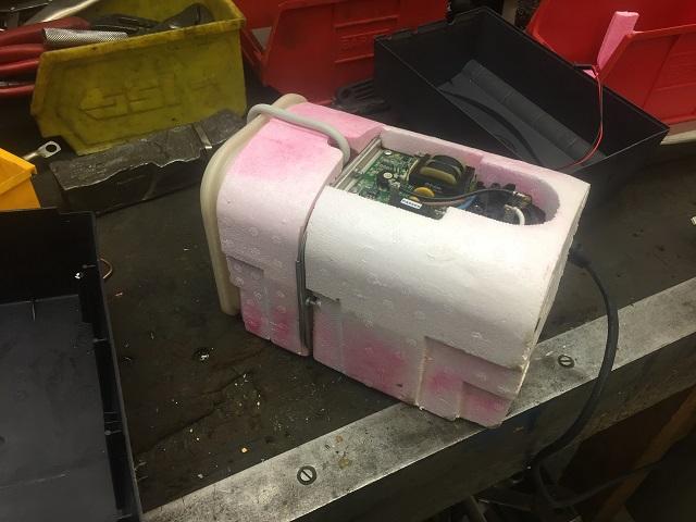

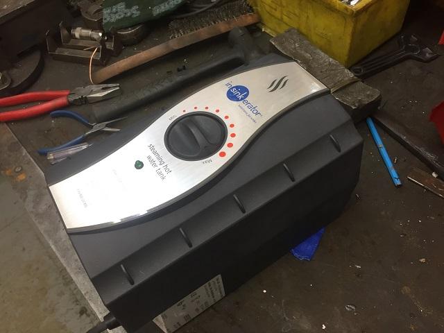

When we had the recent water main burst and the ensuing high pressure surge when they fixed it, one of the many things that failed was our 'Magic Tap' at the kitchen sink that delivers boiling water ready for a cup of tea or coffee - a WONDERFUL device  :ddb:
Now the failure timing may have been co-incidental as these work by having a small well insulated tank whose output is always vented to the tap spout, and when you operate the lever cold water enters and displaces the hot. So in theory the tank is never under mains water pressure.
I pulled it apart, found that the tank is two stainless pressings bolted together, with a special odd shaped seal between them retained in a groove. This had failed, and I was able to replace it with one I made up from 'O ring' cord. The repair was a complete success in that the leak was fixed, but in either dismantling or re-assembly the centre of the temperature setting potentiometer disintegrated leaving it fixed at 90 deg C. OK for coffee but very marginal for tea. No markings on the pot and measuring it in circuit was inconclusive  :bang:
No pictures taken at the time as  things were a bit fraught however a few days later one popped up on eBay "Spares or Repairs" and declared leaking and limescaled up - all for £9.99 plus postage. I thought even if it's not repairable it's worth getting to be able to positively identify the value of the pot, or maybe use the pcb.
Well it duly arrived and the following dismantling, repairing and reassembly pictures are all of this second device.

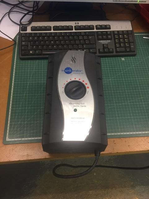

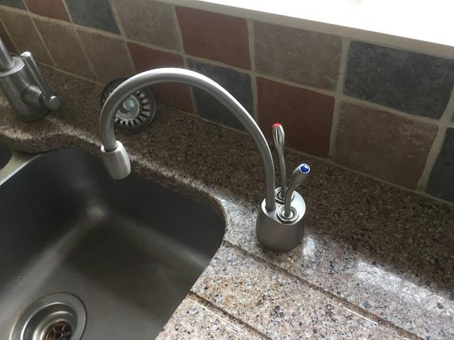

But first, to set the scene, here is the original and it's tap:

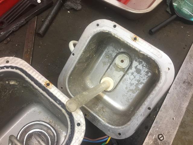

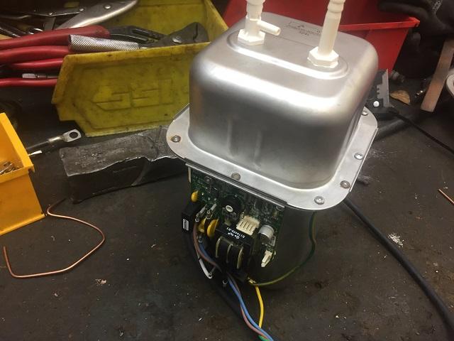

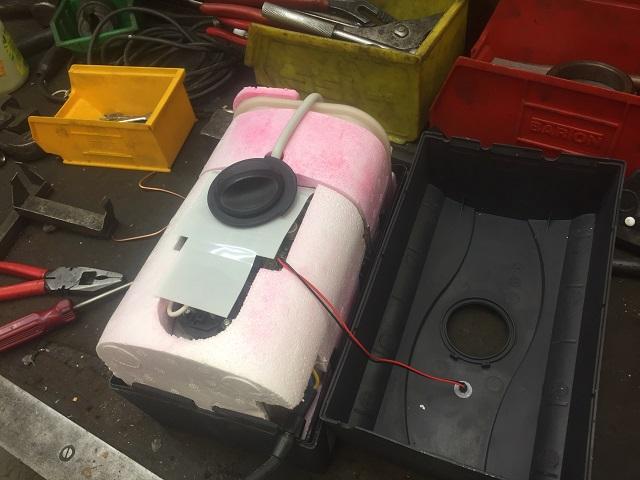

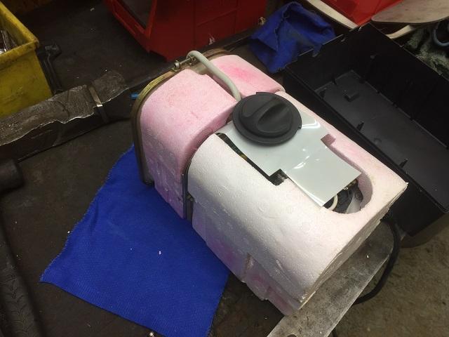

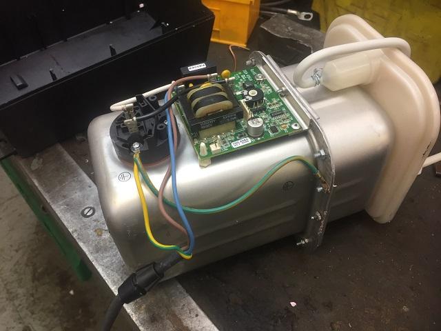

It was immediately apparent to me that the faulty In-Sink-erator had been opened up, as normally there is a small rivet holding the two halves of the case together - this had been replaced by a self tapping screw.
« Last Edit: April 04, 2017, 07:30:20 AM by awemawson »
Re: In-Sink-Erator resurrection
« Reply #2 on: April 03, 2017, 07:01:03 AM »

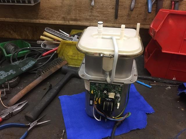

Now a quick 'blow test' on this one implied that the main tank was OK but the plastic balance tank on top was leaking at it's seam - but I needed to open up the main tank anyway to de-fur it with citric acid (marvellous stuff!)
« Last Edit: April 04, 2017, 07:30:42 AM by awemawson »

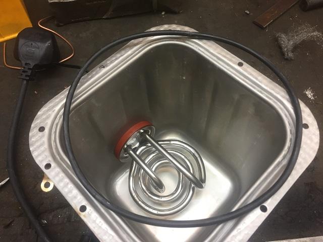

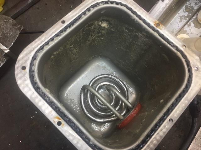

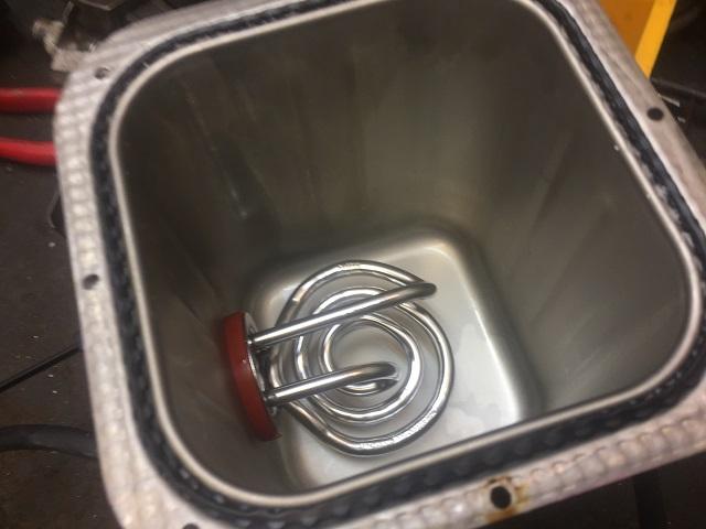

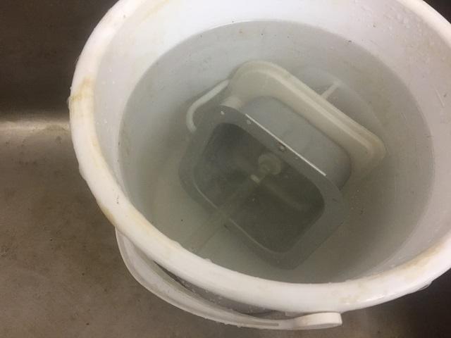

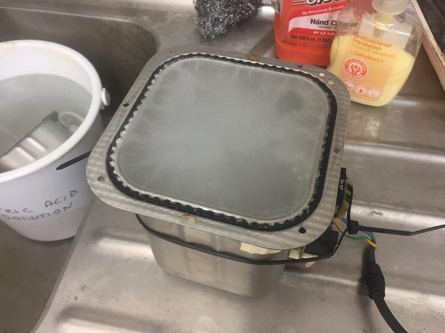

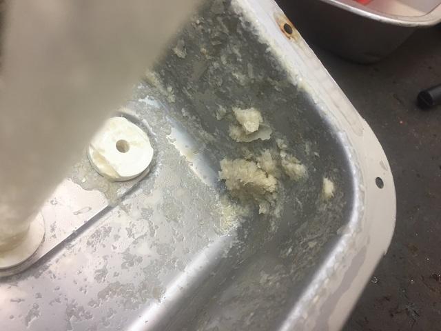

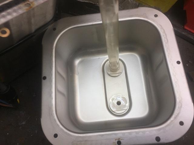

Now the furring was not the usual hard scale that I'm used to, but quite soft and could be wiped away. I do wonder if it had been used in a house equipped with a 'magnetic de-scaler' as I understand that these keep the lime stone suspended rather than let it deposit - just a theory - no proof  :scratch:
However with citric acid it came off beautifully, leaving the tank and heating element sparkling  :thumbup:

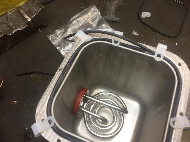

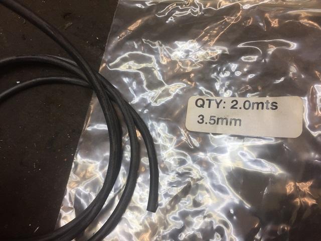

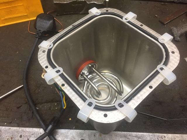

So next make a new gasket - well I'd done this previously and developed a technique so that presented no real concerns  :thumbup:
The main problem is accurately measuring the O ring cord to have the same length as the original squarish gasket, and keeping it in place as the two flanges were bolted back together.
.... but I had a cunning plan ....  :ddb:
It turns out that cable mounting 'P-Clips' are just the job  :lol:

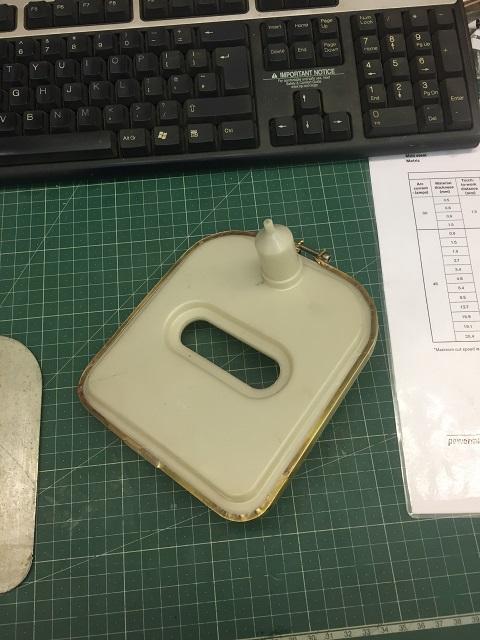

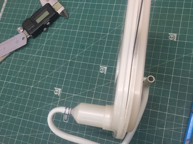

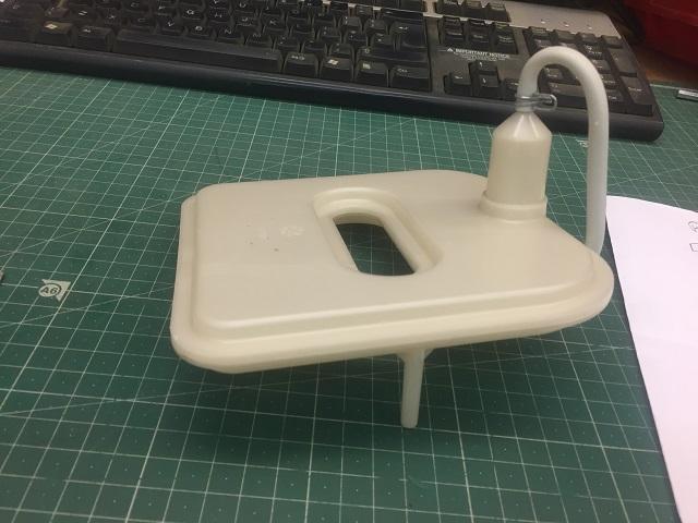

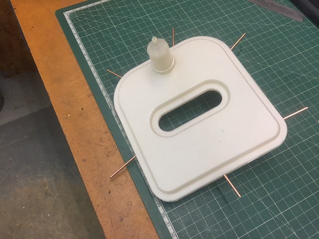

So now to turn my attention to the plastic pressure balance chamber.
Again this has been made in two halves - but instead of being bolted it is glued. As there is an aperture though the tank for the inlet and outlet pipes, there are two glue lines. The inner one had survived and was still strong, but the outer had failed leaving a big leak.
« Last Edit: April 04, 2017, 07:31:37 AM by awemawson »
« Reply #6 on: April 03, 2017, 07:24:10 AM »
At first I didn't think that it was going to be much of a problem, just gluing it back together, so I started by opening it up all round, and pegging it open to allow me to scrape off the old glue.
OK what glue to use. Well the obvious thing I initially thought would be the solvent weld glue used on plastic plumbing - it's ok for drinking water, and ok for boiling water so that's what I used.
 . . . . . . . silly boy  :bang:

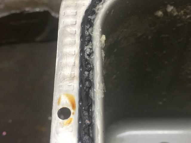

Leaving it to dry / evaporate / set or whatever for a good 24 hours it was immediately obvious that it hadn't worked - this plastic isn't soluble in this glue  :bang:
A lot of opening up, re-pegging, scrapping and cleaning ensued - this also pulled off the remnants of the original glue, which (ok with a bit of force) just peeled off the plastic.

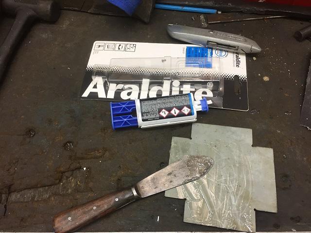

Time to do some testing. I had several glues to hand, including Normal Araldite, Rapid Araldite, a speciality 'hard plastics' glue and various silicone squeezy tubes of sealant.
On the flat, smooth upper surface of the tank (which I cleaned scrupulously with acetone) I put dabs of each of the glues and left them for 24 hours before trying to dislodge them with a sharp blade.
All of them came off, but by far the hardest to dislodge was Normal Araldite - it would come off but clung on reasonably well. Where the halves of the tank go together there is a moulded shape that increases the surface area, and I reasoned that if I gave this a rough finish it would give the glue a better chance - so Normal Araldite it was to be  :clap:

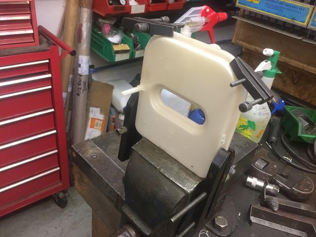

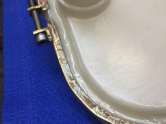

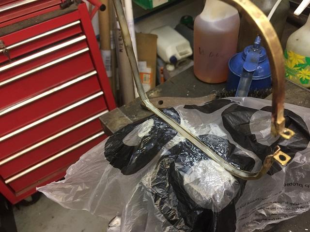

Now I was fairly certain that the Araldite was going to make the tank waterproof, but I wasn't too happy with the fact that in tension, as the two halves are pressed apart, it would take the strain over many years  :scratch:
... time for another cunning plan  :lol:

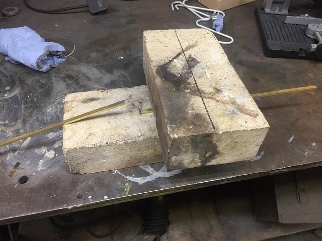

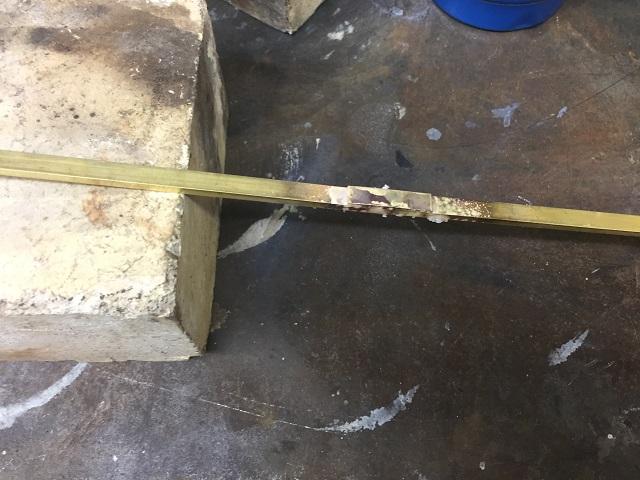

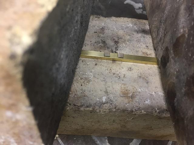

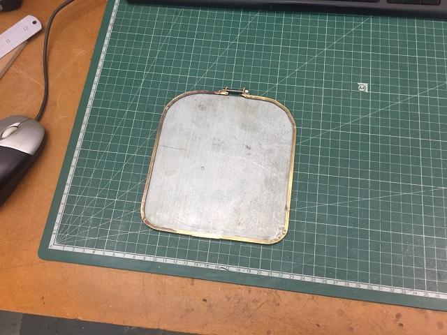

I reasoned that, if I formed a channel that effectively clamped the two halves together, the Araldite would no longer be taking the tension and I might sleep easier  :ddb:
A quick measure up found me some lengths of brass channel, 1/4" external, with 1/8" legs that just nicely fitted the flange. Only problem was it was only available in 1 foot lengths  :bang:
OK two of them ordered, and when they arrived I set to to make them one
« Last Edit: April 04, 2017, 07:32:33 AM by awemawson »
« Reply #9 on: April 03, 2017, 07:46:45 AM »

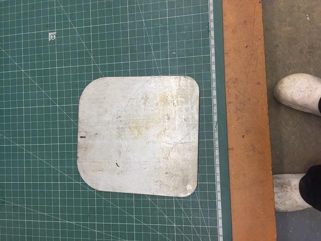

Now forming this channel round the tank flange was going to involve heat and hammering - not sensible to do it on the tank itself - so time to make up a template out of steel plate.
To the rescue came my CNC Plasma Table that kindly turned an Autocad DXF into tangible form - did I ever tell you - I love my CNC Plasma Table  :ddb: :ddb:
« Last Edit: April 04, 2017, 07:32:57 AM by awemawson »
« Reply #10 on: April 03, 2017, 07:50:10 AM »

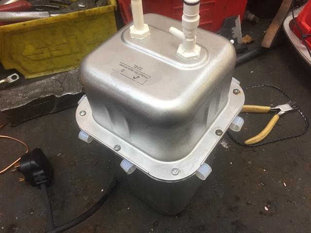

So after a bit more fettling and furtling it was just a case of filling the channel with more Araldite fitting it, tightening it up and then getting the mess off my hands  :clap:
« Last Edit: April 04, 2017, 07:33:20 AM by awemawson »
« Reply #11 on: April 03, 2017, 07:54:12 AM »
I then left it for another 24 hours before re-assembling the unit.
I'll give it another while before trying it, just to make sure that the Araldite has fully cured.
.Now the big question - can Araldite take the heat. The packet say it's good for 80 deg C this will get close to (but not) 100 deg C - time only will tell  :bugeye:
« Last Edit: April 04, 2017, 07:33:39 AM by awemawson »

I resurrected the original, and as mentioned in the first post took no pictures - this details the re-build of the eBay one. The woman I bought it from assured me that it heats up but leaks - I've no reason to doubt her honesty as she declared the other faults, but you are right, I should have at least put a meter on the heating element - but I didn't !
The brass clamp is a tight fit on the flange, and the Araldite packed into it was just to ensure it bedded down firmly.

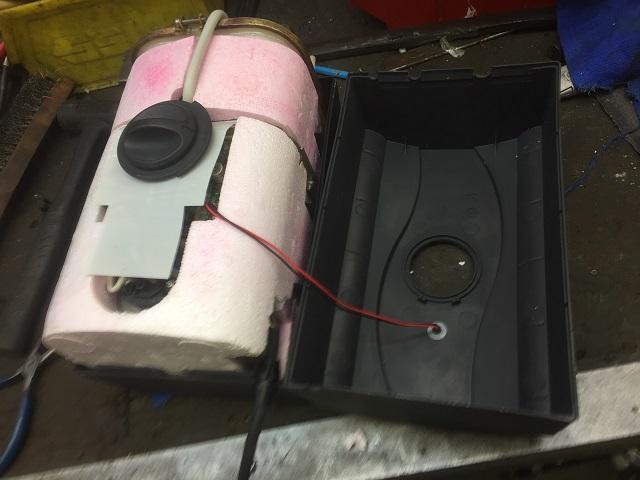

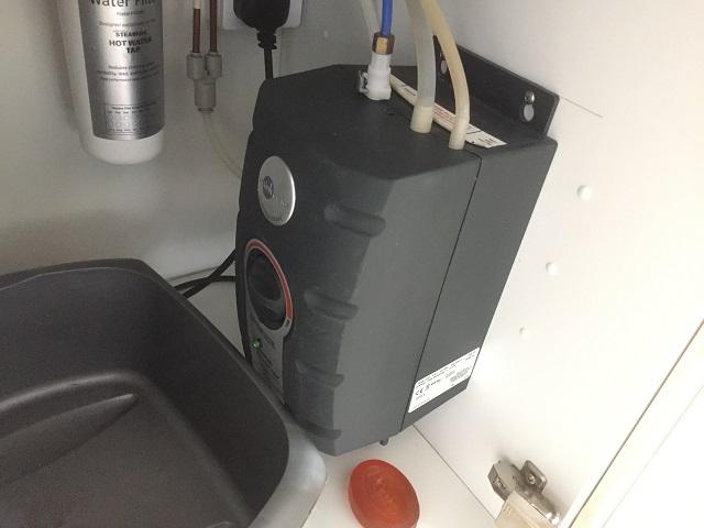

Well so far so good. I've installed the repaired unit:
Tried for leaks cold - none  :ddb:
Then set it's control 2/3rds up its uncalibrated scale and let it heat up, and proved that the controller turns off at set point - which it does  :ddb:
Then measured it's output temperature - 92.5 deg C  :ddb:
Then turned it up to pretty well maximum on the scale, let it get to set point and measured again - 97.6 deg C  :ddb:
Now I need to give it a good flush and check that the water tastes ok.
I suspect any glue issues if any will be revealed over the next few days  :bugeye:

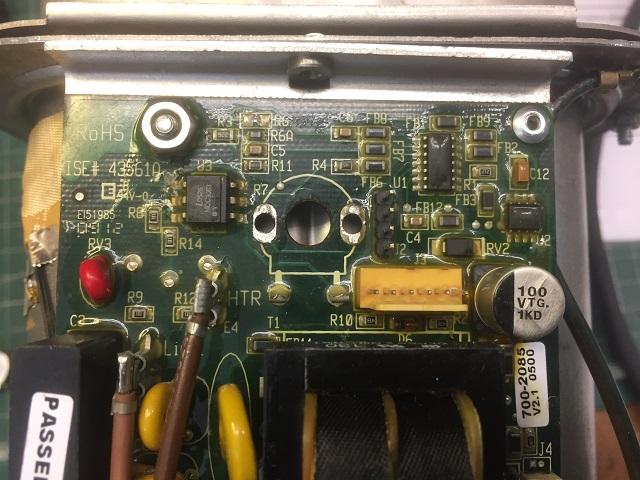

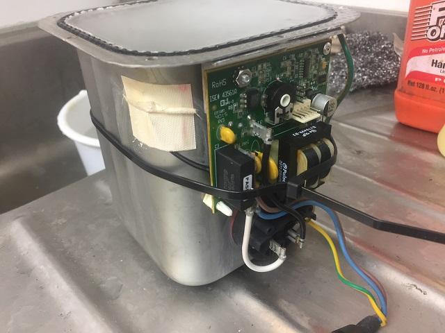

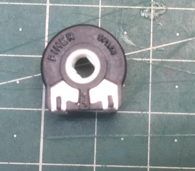

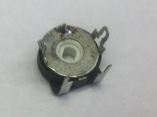

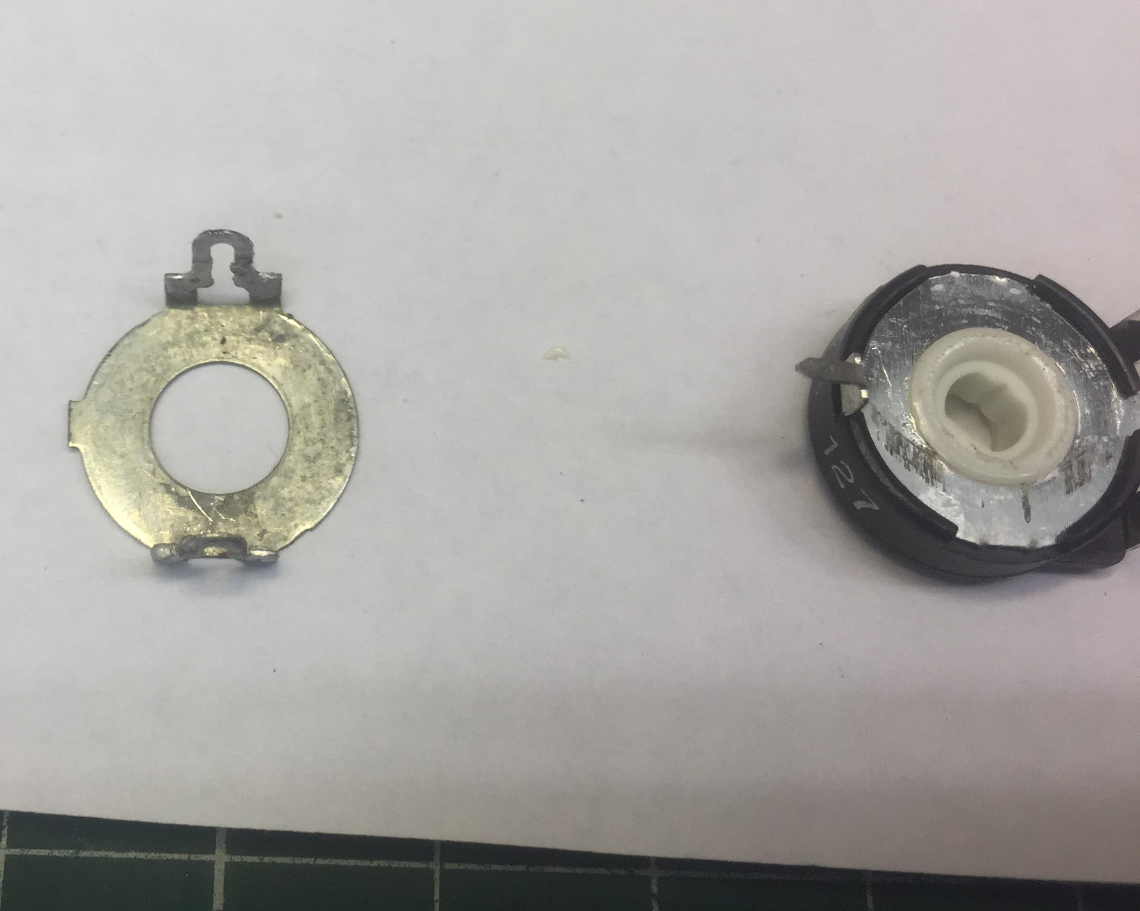

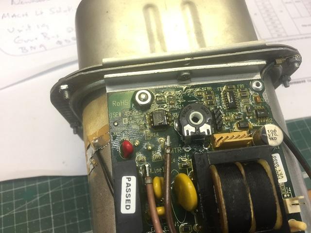

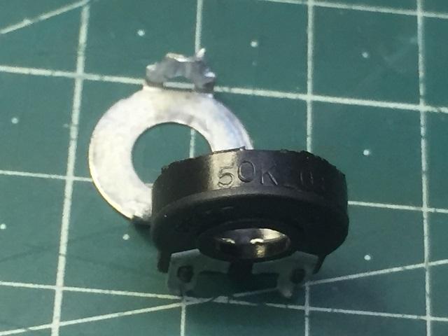

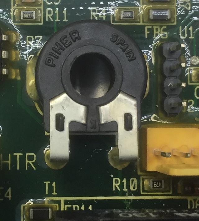

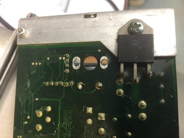

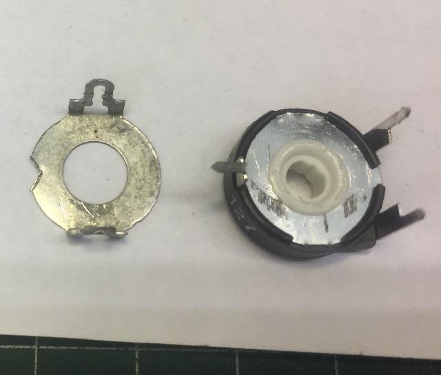

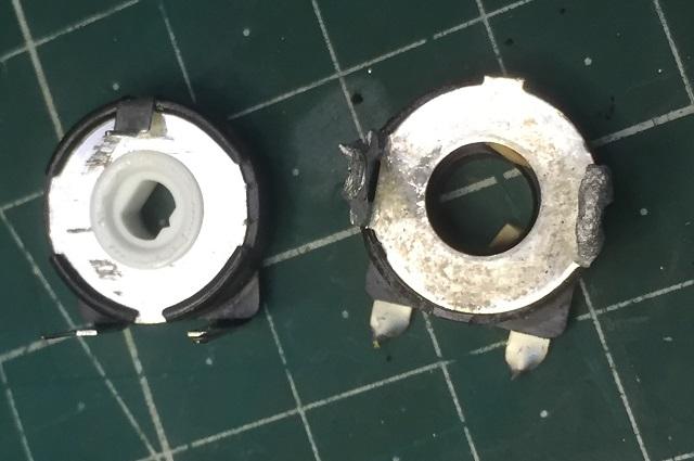

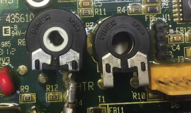

Opened it up, exposed the PCB, decided as the mounts for the new pot are slightly different, to cut the legs that are the ends of the track and leave them in the PCB for possible use to solder the new one to. Then I un-soldered the third connection that is the wiper - this is in fact two common connections presumably to give better mechanical strength  :scratch:
Having got the Pot off the PCB I measured it's resistance - 28.3 kOhm . Argh - the replacement is 50k (well 47k being a standard value) BUT THE ORIGINAL SAYS 50K on it's body  :bang:
Now as the wiper mechanism had collapsed I thought that part of it might be shorting out the track and giving the low reading. A careful bit of dissection with a scalpel exposed the bare track releasing the remains of the wiper - it measures 28.3 kOhms  :bang:
So I'm in a bit of a quandary now - do I put the 47k pot in, or try and get a 28k - well 27k is the nearest preferred value - or has the original track gone low resistance. If it has I've never come across such a failure mode before, they always go high resistance  :scratch:
  • Posts: 537
« Reply #23 on: April 04, 2017, 05:03:22 PM »
I'd be inclined to go with the 47K.  I can't believe they fitted pots marked 50 believing they were 28K, so they must have thought it was a 50K.  Also unless it's more complicated than the PCB looks the 47K will give you all the values you could get from a 28K.
Offline howsitwork?
  • Posts: 360
« Reply #24 on: April 04, 2017, 05:04:31 PM »
Andrew
what does the rebuilt one have as it's value if you can access it?
« Reply #25 on: April 04, 2017, 05:40:58 PM »
It also says 50K on it as I photographed it to source the replacement, but never measured it  :palm: Nor do I seem to have kept the picture, however it was exactly the same as the one here except the marking was printed not pressed in.
Offline russ57
  • Posts: 288
« Reply #26 on: April 04, 2017, 09:03:09 PM »
I'd give it a go as well. At worst, the useful adjustment range will be 'compressed' so the calibration may change but it should work fine.

So I decided to install the 50K pot. This entailed creating a Frankenstein Monster of a pot comprising the new body with the base incorporating the different mounting pins from the old pot.
Initial tests seem OK. I set the pot mid way, plumbed and powered it up, and got 95 deg C. Then wound the pot up to maximum and got 97.2 deg C which is just about right
Then I brush painted some conformal coating over where I've soldered to re-make the vapour protection that was there before.
Still very puzzling about the 28K / 50K conundrum  :scratch:

Andrew: Presumably, the low end of the resistor was providing the maximum temperature (i.e. tending to zero ohms). With your old pot failing "high resistance", it could no longer tell the machine to go to maximum temperature. Normally if a pot fails at high resistance the issue is with the wiper; often the wiper & "output leg" are wired together, which I assume was the case in, er, this case.
So... that given... it wouldn't matter if it was a 28k pot, a 50k pot or even a 147k pot... the low resistance end would give the maximum temperature.
However... I'm sure you've thought of all that stuff (cos I knows you are good with electrickery), so if I'm talking out of my Chinese hat, just say so...
« Reply #31 on: April 05, 2017, 08:31:27 AM »
Ade, the original pot wiper had been knocked off in the dis-assembling of the original device - my own clumsiness not removing the shaft before laying it on the bench. The actual track was undamaged  :scratch:
Any road up it's working and making me tea and coffee, and the fixed 'spares or repairs' one tucked away for the next failure  :lol:
