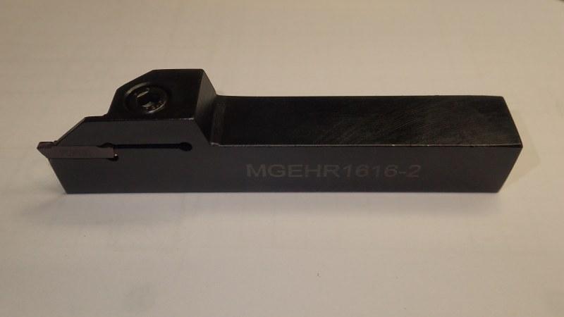

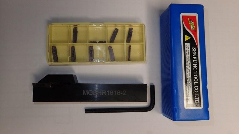

I have been lately looking go new paring off, threading and grooving tools. One friend dropped me a polyvee pulley form tool he brough me a brought me some MGMN 200 inserts and MGEHR shanks to try them.

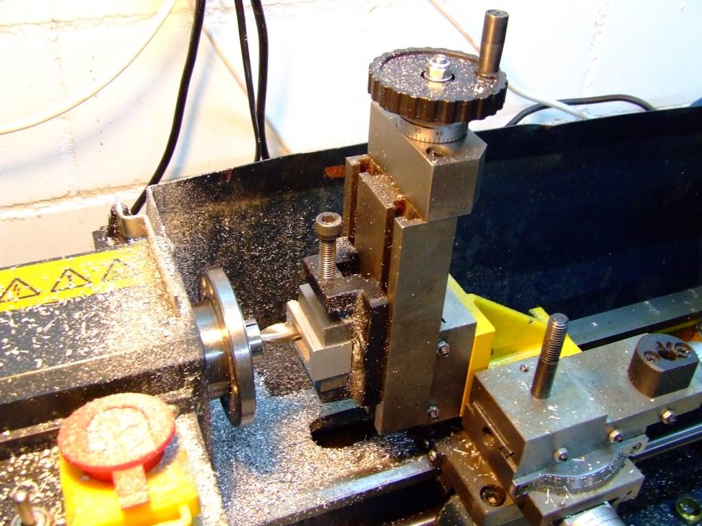

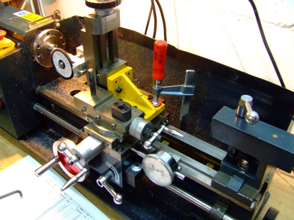

I am tempted to build very rudimentary rear toolpost for parting off (but normal one, not inverted one). Any Ideas for a quick change design that the whole post would come out clean and would index back without much waffing about?

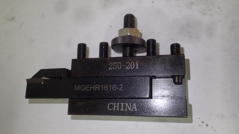

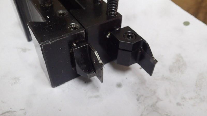

MGEHR1616-2 & MGMN200-G vs. SGTHR 20-2 & GTN2.
GTN wins.

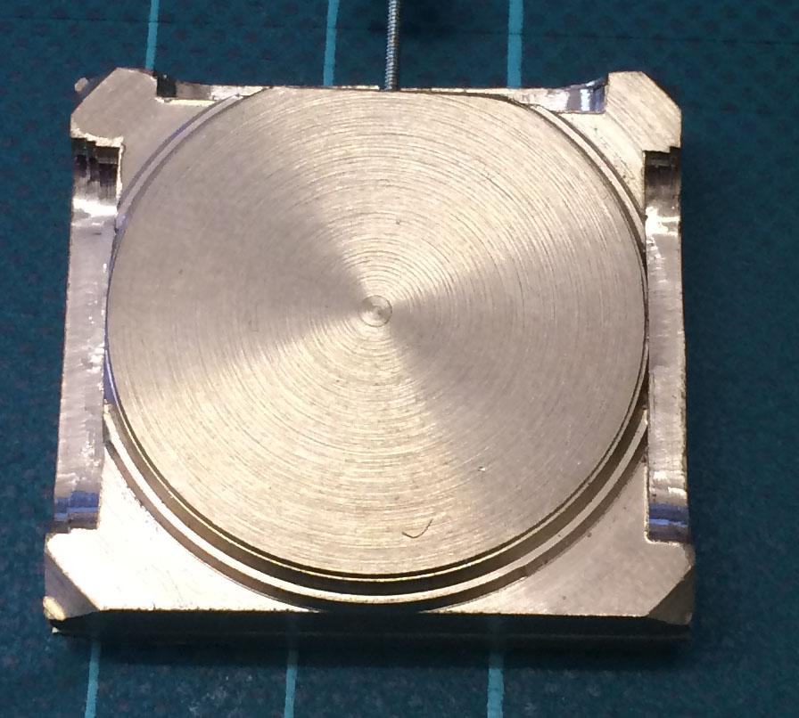

So, which of the two shown side-by-side is the winner?  I've never been great with all of the number/letter designations for holders.  Which criteria are you using to determine your winner?
In your last picture, just looking at the chips below (small short curled chips lower left, which may or may not be from the active parting cut), it looks like you're getting a lot of heat.  It would help to get some soluble oil coolant in there via a squirt bottle or more fancy delivery system, or straight cutting oil - which will do the same job with probably a lot more nasty smoke. ;)

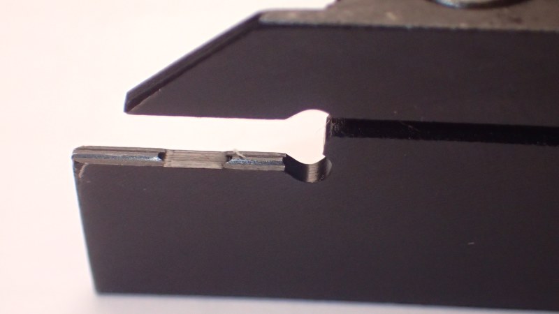

GTN is in the second picture on the left. One ended insert, friction seating no clampping screw to hold it.

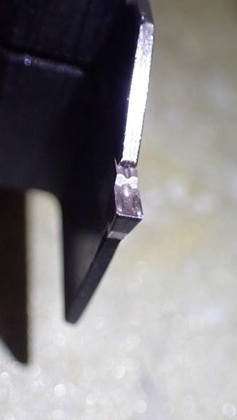

It winns because no chatter and cuts cleanly. Probably much of the reason the inser holder that has less overhang. Also difficult material chip was formed better on the Iscar GTN inser than on the two sided cheap chinese one. Although I must say that the one chinese I got was surpricingly well made and the tool holder is about 1/4 of the price  paid for iscar. Inserts are 10 times cheaper tha iscar. I got one box of the chinese iserts that are next to uselees: they cut bright drawn shaft, but chip formation is bad and they break often. These on the picture were much much better. Still no markings on the box but these insers actually work.
I have pictures of the two sided grooving system (MGEHR1616-2 & MGMN200-G ) at the end. Last picture of the cheap but surpricingly good insert after the I cut two cuts on MOC, four cuts on drill rold (silver steel) and whole evening of general parting off (maybe dozen of cut outs) on structural steel. If I can find aluminium inser for it I would dedicate that holder for aluminium parting off. However, on more difficult materials and deeper cuts than parting of maybe 35 mm dia I will be using GTN2 system.
