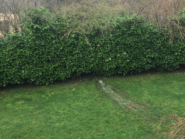

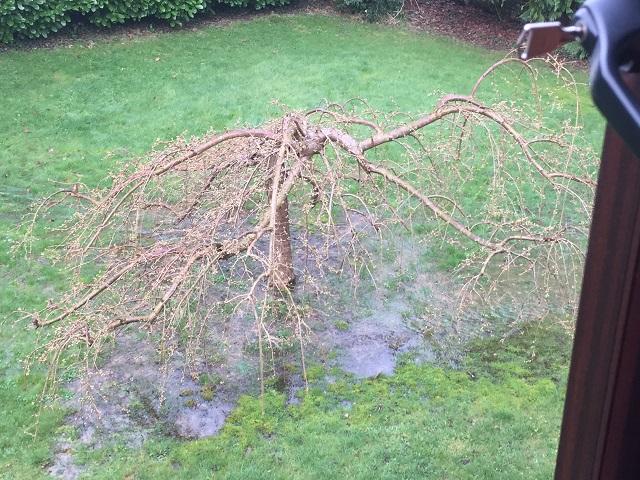

Sunday - a day of rest - but SOMETHING woke me up - ok no point in lying in bed, get up and do things! First action, brush my teeth. Oi who stole the water  :bang:
OK there was water but at a very low pressure. I glanced out of the bedroom window to see a 'gusher' in the front garden - probably about 6" out of the ground and LOTS of flow  :bugeye:
Quick Google got me Southern Water's emergency number, and when I called them they said they'd had several low pressure reports and were searching for the leak - 'I think I know were it is' I said !
This was just after 7 am - team turned up about 9 am but before arrival they'd shut valves to stem the flow - in the mean time I took a little video and a few pictures:

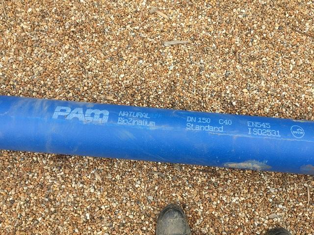

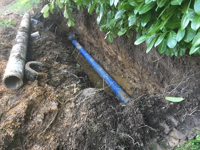

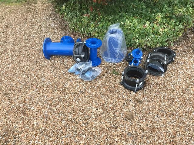

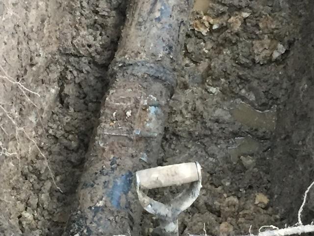

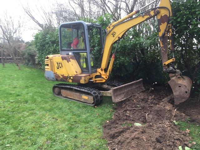

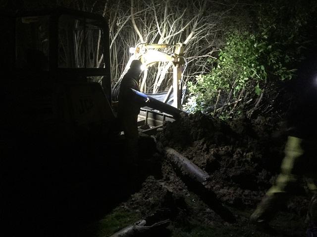

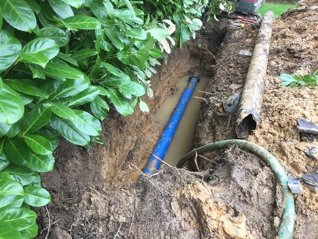

They brought a 1 ton digger with them and started digging up my front lawn - very soggy - lots of mess  :scratch:

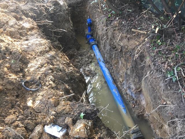

Eventually they got down to what was shown on the plans as a 150 mm ductile iron water main, but in practice turned out to be a 150 mm asbestos water main  :bugeye:

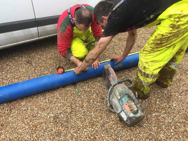

Oops - need another team - not allowed to cut asbestos pipes. OK another couple of fellows suitably trained turn up, and they decide to cut a 4 metre section out and replace flange to flange. More digging, big lorry arrives with 6 metre length of (this time actually ductile cast iron) pipe flanges etc
Careful measure up and out with the petrol cutter to slice off the extra

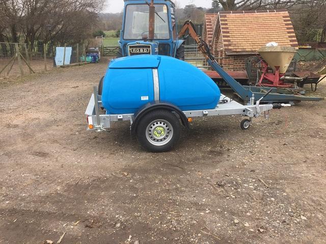

Now while this is happening we have no water for the livestock so I pressed them for a bowser to be delivered, which eventually turns up

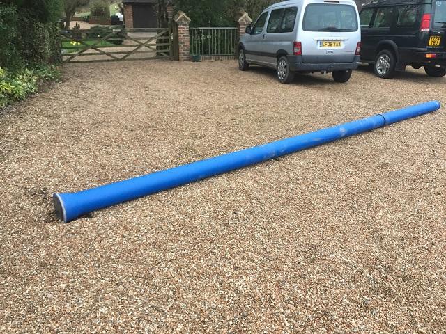

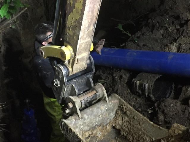

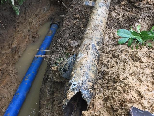

Cut length of bally heavy pipe now man ported across the soggy lawn and put in place.
The crack in the original pipe is substantial as you can see in one of the pictures

So, leak fixed time to turn on the water  :thumbup:

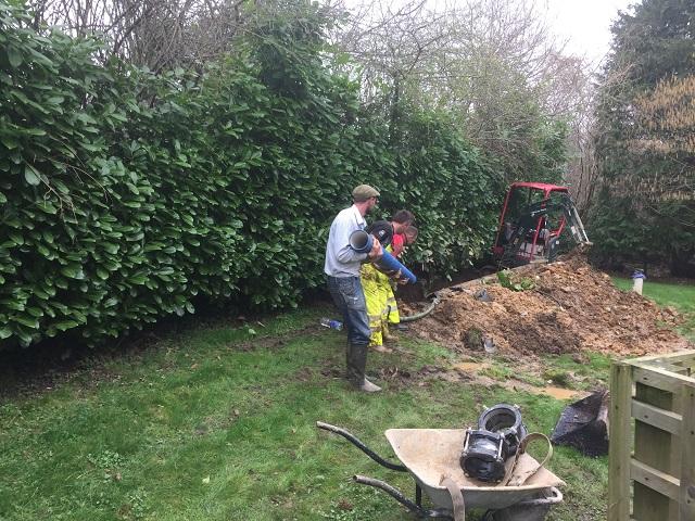

Ah - ever heard of water hammer  :scratch: :scratch: :scratch: :scratch:
Big hammer effect as large volume of water flows into big pipe - BURSTING THE PIPE about 30 foot further along our hedge.
As I type, there is another even bigger hole being dug and about 10 metres of my front laurel hedge have been felled to insert yet anther new bit. They had to borrow my JCB 803 for this hole as theirs wasn't big enough !

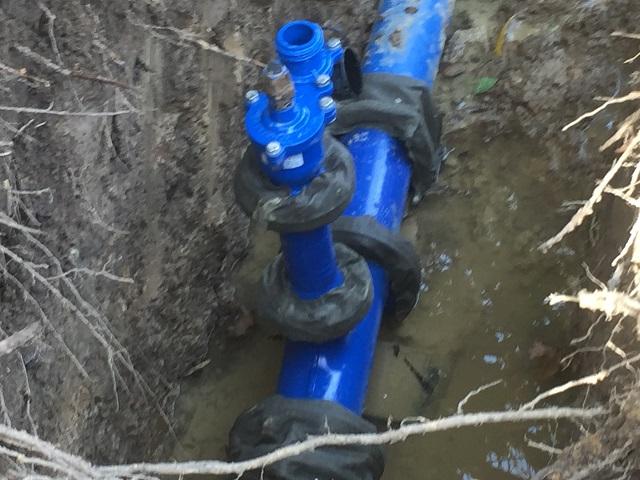

They intend to fit a fire hydrant in our front garden on this section, and have it open when the pipe is re-filled to stop the water hammer, but it's now 18:40 - still no water, and I'm having supper - more pictures later !

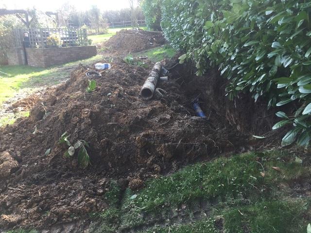

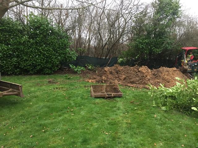

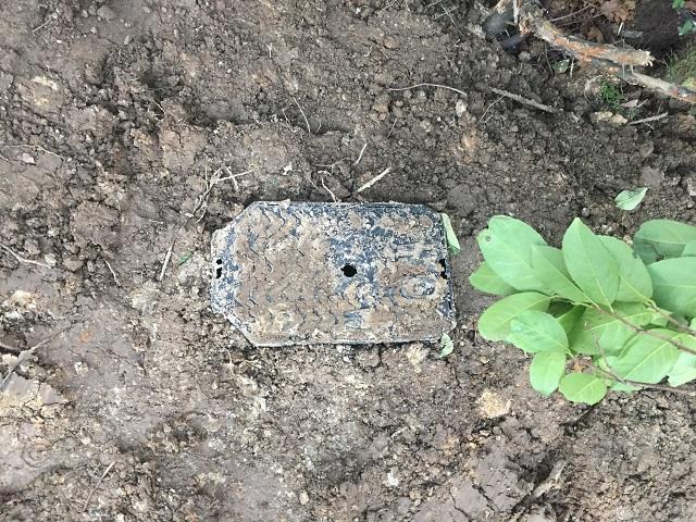

So supper finished but they're still at it - gave them a can of beer each as a consolation prize -  here's a few more pictures:
I'm glad that I installed good lights on the JCB803
In the last picture the hydrant is just visible in the bottom left corner

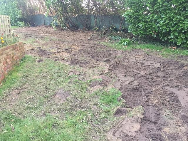

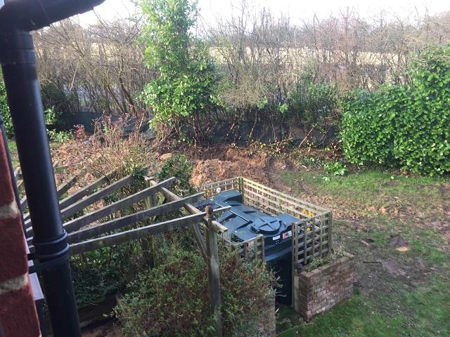

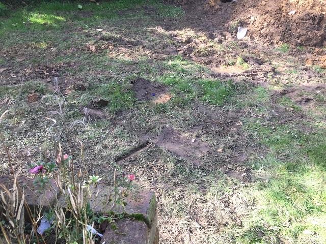

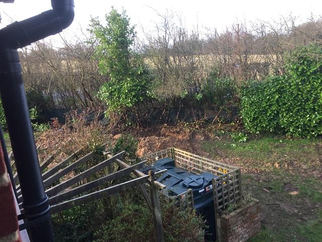

 :update:
So this morning I woke up to quite a different view from the bedroom windows :
Re: But I can't brush my Teeth !!!!
« Reply #19 on: March 13, 2017, 07:19:02 AM »

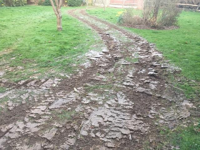

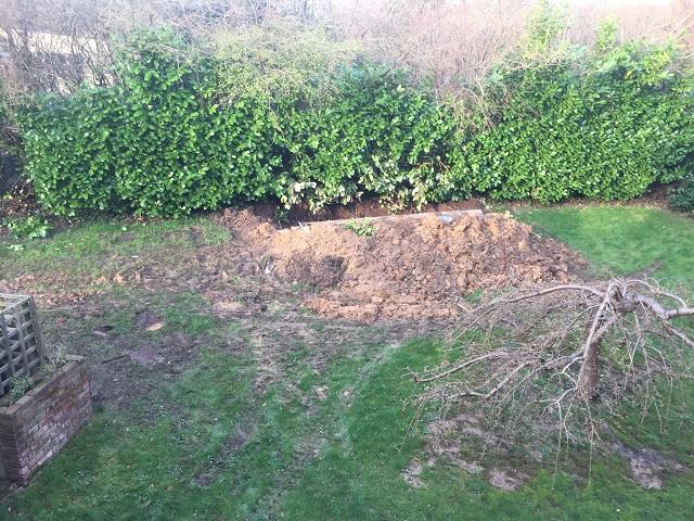

And it didn't get a lot better from ground level  :scratch:

Still, look on the bright side - we now have our own private fire hydrant  :lol:

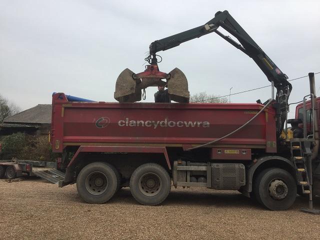

Chap turned up this afternoon with a big lorry to collect the water bowser - must have been a 7.5 tonner I expect, when he saw the remnant of pipeline that he had to pick up as well he said he'd have to come back with a gang to collect it as he couldn't manage on his own. I offered to put it on with the forklift if he dropped his 'drop side' so I could slide it on. When it came to it, rather than drop the side he had me drop the pipe from probably 5 foot, by heck it made an enormous noise into an empty steel floored lorry  :bugeye:

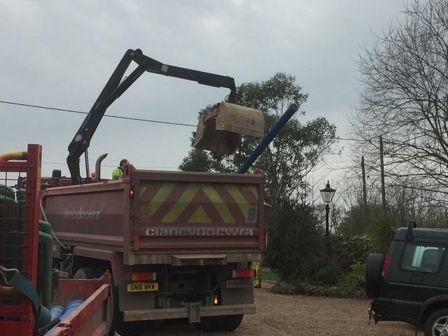

Spent a few hours on Monday pressure washing the JCB803 and it's buckets, as they'd left it in a bit of a mess, then darn me if they didn't send a gang over this morning to start the clear up ASSUMING they could use my digger.
Now if Clancy Docwra who are SE Waters contractors had rung up, said thanks for it's previous use, can we (at least) replace the diesel we've used, and if we agree term can we use it again I would have reluctantly agreed if they also agreed to clean it up when done. But to ASSUME without even contacting me got very short shrift  :poke: :poke: :poke:
So some hours later they came back with a hired one and have started back filling the trenches.

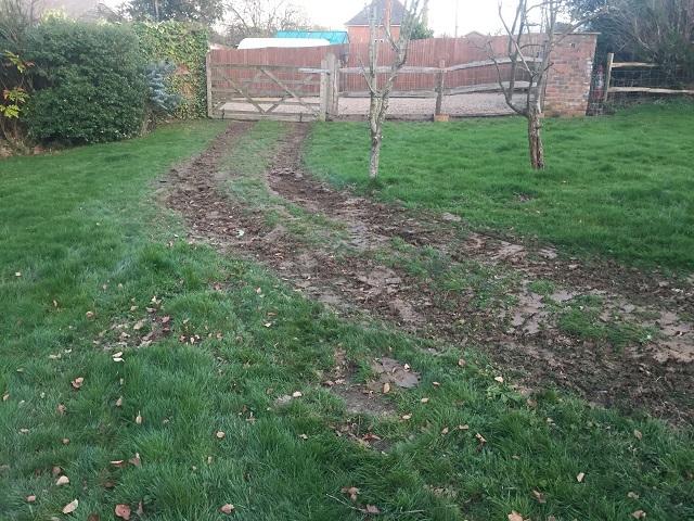

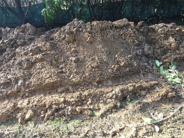

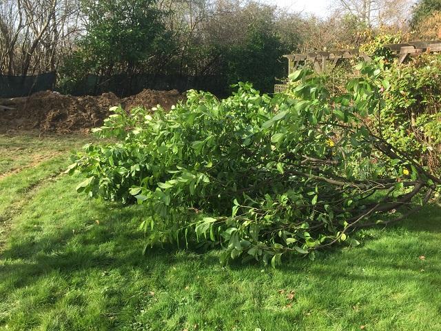

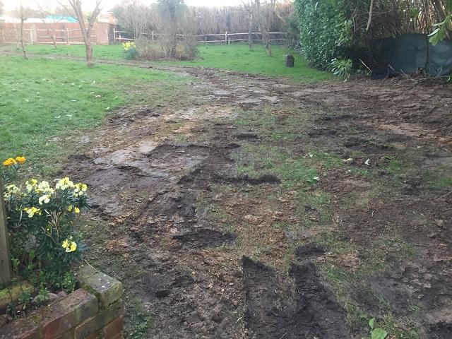

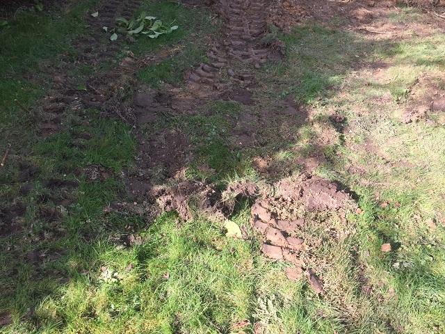

So yesterday a chap turned up in the afternoon and back filled most of the trenches, but said he needed a bigger digger. So this morning the 1 Ton was taken away and the 3 ton arrived, and he 'finished off' including loading the cut down hedge into a big lorry along with the soil that wouldn't go back in the trench (so no doubt we'll have 'sinkage' in a year or so as it settles.
He's done a fair job, but it's still a heck of a mess considering that before they came it was a lawn awaiting it's first cut of the season  :(

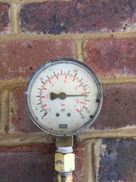

Now since this fiasco we've had several leaks about the place  :( A chap turned up to sample the water quality since the repair and I got him to test the pressure - he admitted that it was very high at 7 bar but there is actually no upper limit to what they can supply (there is a lower one) but so far our Insinkerator instant hot water boiler gasket went (repaired by custom made O ring), the downstairs loo ball cock started leaking, as did a cattle trough and four joints in 25 mpde pipe around the place - this can't be a co-incidence.
I'll try to get them to reduce the pressure on their system, but if this isn't possible I do have a chamber where we installed a private water meter, and there may well be room to fit a pressure reduction valve of our own - if necessary the meter can be removed as SE Water have sadly fitted one at our infeed connection.

It was probably the water hammer that you reported when they first turned the water back on that has upset the system and loosened gaskets and  disturbed ball valves. However, 7 bar water pressure does seem very high. I complain when mine suddenly went up to 5 bar and they turned it down. However, it depends on who else is on the main as they try to keep everyone happy so it is a compromise.

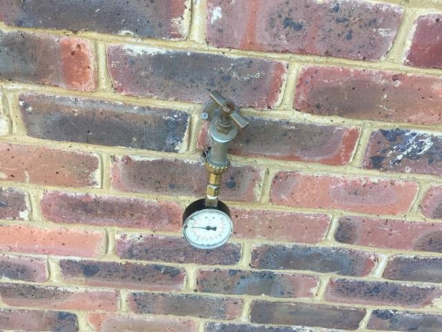

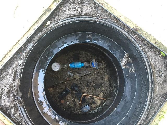

I rigged my own 'known good' pressure gauge up to measure the mains water this morning and in fact it's 9 Bar  :bugeye: That's 130 PSI  :bugeye: :bugeye:
(Flow rate is 4 gallons per minute)

I'd definitely consider getting a pressure reducer Andrew. I think the maximum recommended in domestic installations is 80psi. It doesn't need to go much high and you're reaching rated values for boilers, cylinders and the like.

Thanks John, yes you'll be pleased to hear that the teeth have been bushed brushed SEVERAL times since then  :lol:
However the landscaping hasn't started yet - they came round on Thursday, measured up the considerable amount of turf that they will need, and took sample leaves from the remaining Laurel hedge so that they can match the genus. (In years to come I don't want paler or maybe spotty laurel in what up till this incident was a uniform dark green hedge.

Today a portable Laurel Hedge arrived on the back of a lorry  :lol:
About 30 reasonable sized plants which they have planted in the foot of the previously destroyed hedge - hopefully these will grow quite quickly.

Well after quite a bit of persistent nagging, and putting on my cross face, at long last they have made good the front garden.
Three men for three days, 250 square metres of turf, three jumbo bags of top soil and a lot of watering.
Quite cleverly they used a turf lifter to scrape off the top layer and give an even surface to prepare for turfing.
