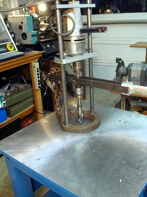

I'm having to drill & tap a ton of holes on my new CNC project. I don’t have a mag drill so I cobbled up this rig to ensure that the holes are all nice & straight.

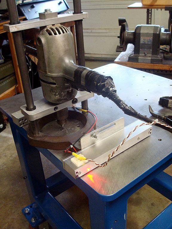

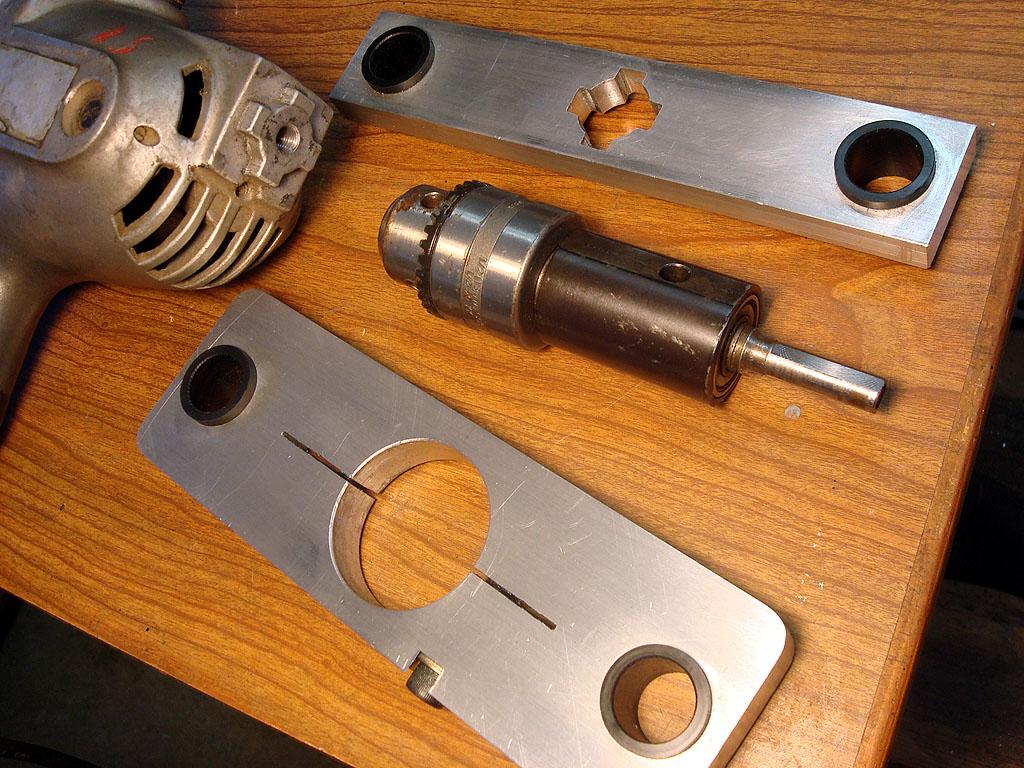

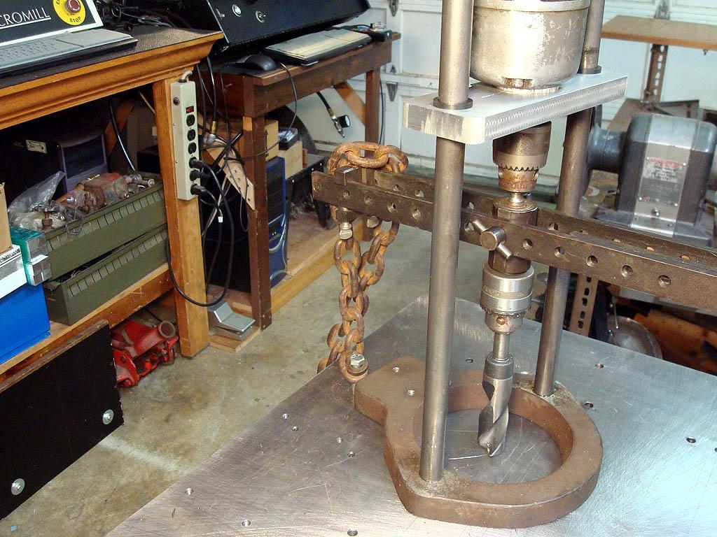

 A friend let me borrow his lever-assist safe drilling gizmo but in use it doesn't guarantee that the hole is perpendicular to the work.  I made up a guide stand for it by modifying an old British Leyland screw press I had squirreled away .  I modded it with some longer guide rods and 2 acetal bushed aluminum plates to attach to the drill.
He also let me have a 12V electromagnetic security door lock. I ordered another one from ebay for a total of (allegedly) 1200 lbs. clamping force. The E/M’s won’t be used to anchor the end of the lever, just to solidly clamp the base once the hole position is located.  They're wired in series for 24vdc.  A chain either wrapped around or bolted to the table at the far end of the lever allows applying as much pressure on the drill as needed. The length of lever is adjustable out to about 3 feet.

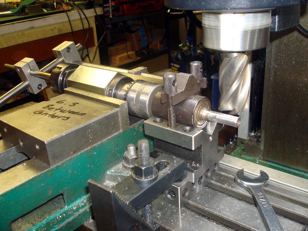

The drill spindle was buggered a bit from slippage so I milled 3 flats on it to stop that problem.    I included a pic of the wacky setup I used to mill the flats. Finally found a use for the clamped V-blocks I picked up a long time ago.
The pics show a large drill in it just for kicks; no way I'm drilling a hole that big in that nice blanchard-ground table top!  I didn't actually need the additional leverage of the safe drilling gizmo for these small holes but it's there when I need it.  I just aligned the drill over the punch mark, switched on the magnets, climbed up on a step stool & let my body weight work for me.

Oh my.....I missed that in the first pic......

Just as a further note on the ratty looking cord, the important part is still in good shape.  The cord itself was replaced probably 35 yrs ago & still going strong.
The original molded strain relief which I re-used turned to dust 15 years ago & at that time I made a temporary repair by slitting a piece of fuel hose, sliding it over the cord & up into the handle then wrapping with electrical tape in a highly complicated, precisely calculated  tapered fashion to reduce stress on the cord. :thumbup:
The replacement of the cord will be immediately brought to the attention of the maintenance committee. :beer:
