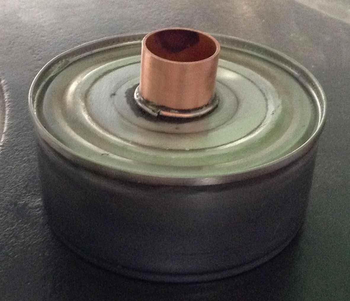

Been meaning to make one of these for ages, can't really use the workshop as floor paint is drying so mostly made this in the front room whilst other half out at work.  :D
Components being, dogs tuna tin from last night, 22-15mm copper fitting with a wrap of 2mm copper wire to fillet the joint.  Not very fancy, but killed an hour on a slow day.

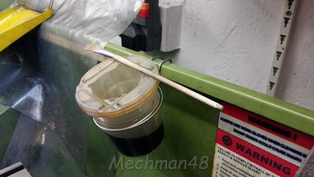

Mine is a child's unspillable paint pot, with a rare earth magnet tossed in the bottom to stop it being knocked off the lathe so easily  :ddb:
Re: Cutting oil dispenser
« Reply #2 on: March 08, 2017, 11:28:37 AM »
You just have to go one better dont ya? !........ :lol:
Picture?  :worthless:

Magican opener leaves a really clean edge.  I was able to flare this outwards with smooth pliers.  Now the lids cut edge sits inside the can.  Needle file to rough the edge and take off any coatings.  Flux and tin the edge with flux cored solder.  The metal is so thin you don't need a big iron.  Prep the lid, needed a bit more heat to solder the copper fitting.  Tin the lid inner edge, now press fit and using the soldering iron slowly melt the solder at the tin/ lid joint all round.   Add a little solder if needed to get a continuos seem.  Clean up and cool down, now blow into the copper fitting and see if the can leaks.  If it's sealed your all done, add oil and pour out excess from can back into bottle.

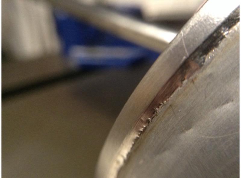

This is the soldered edge I got on the tin, modern coatings makes good solder mask so you only need a needle file and light touch to open enough metal to tin with an iron, not much more than a scratch then wick the solder round the can joint.  (too many tins)
*** Well that was a big cock up trying to edit and resize an image on an iPad ***
Here you go:

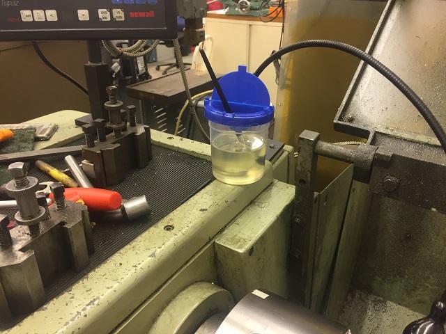

Made a second one for other lathe.  With what I learned from the first can, I soldered the reinforcing wire to the underside of the lid.  Don't really know why I didn't do it the first time round.
it was actually easier to solder as the ring is smaller this side and the solder easier to wick round.
Much neater topside with solder flashed all round the joint.  Only apply heat to the copper fitting and you won't set fire to the coating on the can.

By having a 'paste brush' in the pot you can apply small quantities of oil where and when you need it without bringing something metallic into the vacinity of fast spinning bits that you are turning, drilling etc
If you look at the child's paint pot picture that I posted, the brush is in situ

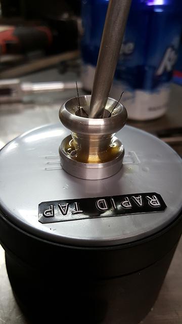

My exotic approach for the small amount I do is using one of my wife's empty hair colour bottles with the tube from a WD40 can inserted snugly through the cap.
       I used to fill the bottle with a mixture of 30W oil and Kerosene 25/75 approx. In use, I upend said bottle, gentle or not so gentle squeeze to get the amount I want and start work. I also sometimes just let the heat of my hand expand the air inside the bottle and achieve a drip feed when parting off.
       Lately I have begun using, "Angels Breath tapping fluid" because I made some up and A, it works ok and B, it stinks better.   :palm:
    Still, as has been stated previously, it was the joy of making the Tuna Oil tub that was the aim of Joules in his original post.
      Oh, and Angels Breath does work well as a tapping fluid. Strange, as that was its intended use.
     To save you asking, Angels Breath as I use it is a mix of,

While I like the Tubal Cain idea, I took a different approach.
When I have another container ready, I will make another one and annodize one yellow and one green for either Rapid Tap or A9.

My version is a simple kiddies non spill paint pot, fitted with a bit of copper tube hot glued in. Nice ideas from other members though, well done to all...
http://www.model-engineer.co.uk/forums/postings.asp?th=123559
George.
