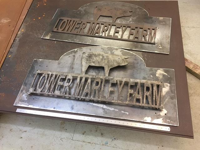

I've cut a pair of farm signs for either side of our farm gateway. They are 9 mm mild steel - two parts, a backing, and the lettering that will be raised off the backing 25 mm by delrin pillars and held together by M6 stainless hardware. They will each be fitted to a pair of standard scaffold tube set vertically in the manner of urban road name signs.
The background will be white, and the lettering black.
As these will be placed in my verge at the side of a busy trunk road they take a bit of blasting from muck and grit as lorries go past.
My first thought was to have them hot dip galvanised before painting, but I suspect that the zinc will web across the gaps in the lettering.
Then I thought perhaps electro-zinc plated, but can't find a local place to do it.
So back to paint - perhaps a heavy zinc rich primer followed by an epoxy - but I've never used the stuff, so I would really welcome suggestions from the knowledgeable members.
BTW these weigh A LOT so sending them afar is not easy - that's a metre rule below one of them.

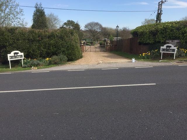

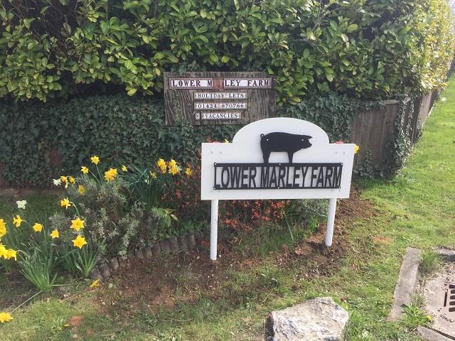

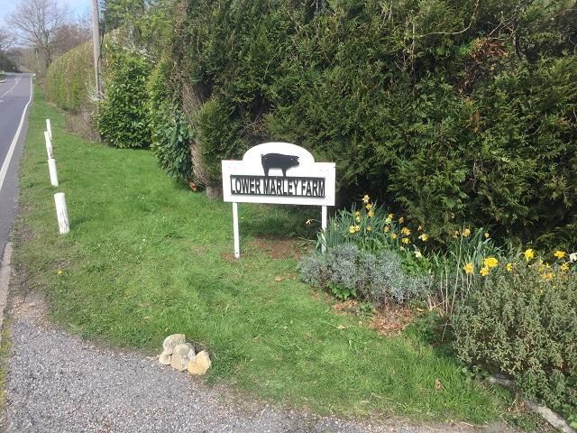

At long last the signs are not only painted but erected  :clap:
The fellow was supposed to be taking them to be hot zinc sprayed, then painting them in 2K black and white and delivering them back to me. Well they got zinced ok, but he ended up using my welding shop for the painting and was a right menace - hardly 'turnkey' but after a few false starts, and three days of mucking about with paint, I eventually got him off site  :bang:
So this morning I judged that all was hard enough to handle, and assembled them and planted them in the ground. Ended up having to use the forklift truck to get them to site - they are amazingly heavy and too wide to go in the tailgate of my Discovery, as I had hoped. Anyway they are in, and bedded with 'dry mix' which I have subsequently watered.
It'll be interesting to see how long before they appear on Google Streetview !
