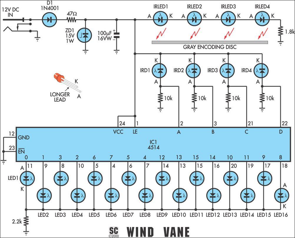

Gray encoding?
I think epe magazine did a weather station project that used Gray coding for the weather vane, but it was some years back.....
I came across this too.....might be food for thought...
http://sandaysoft.com/forum/viewtopic.php?t=4570

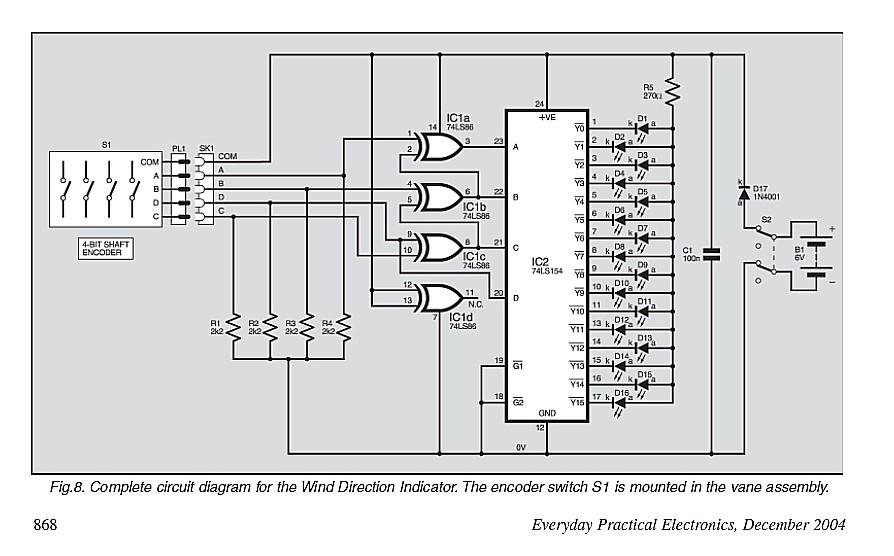

Hi John
EPE Dec04  wind indicator

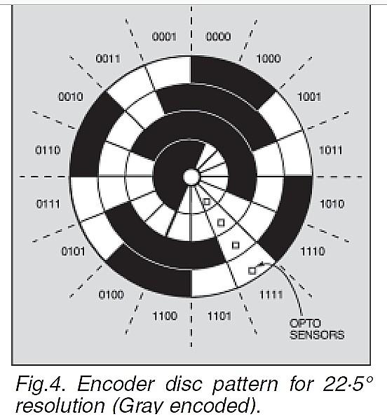

« Reply #5 on: March 07, 2017, 08:12:11 AM »
It can also be printed and wrapped round a cylinder or shaft to make a much more compact sensor.

« Reply #6 on: March 07, 2017, 09:07:28 AM »
If you need more resolution, this article describes how to generate larger numbers and decode back to something usable.
https://en.wikipedia.org/wiki/Gray_code

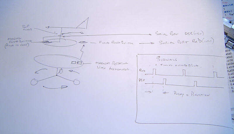

I've posted this before but it is such a simple clever idea (not mine obviously ) I thought it worth repeating:

BillTodd,  that might have been from one of my ideas!  The problem I found in advancing that principle further was the difficulty of designing thoroughly reliable slip rings.
Speedo cable? Well not so daft when you consider that some 'professional' systems used solid rod drive to the indicator with Hook's joints etc.  Dynes make pressure tube systems with a pitot head and a rather large container filled with water!
