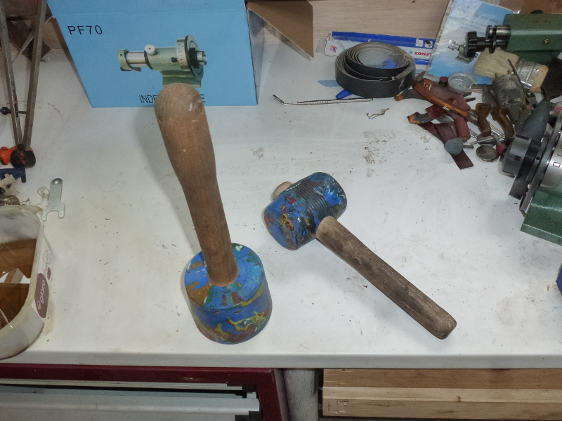

Things got a little out of hand at our meeting last week so I produced this today...
...just a little gavel made from recycled milk and shampoo bottles etc.

How did you manage to render down the waste plastic to make the solid shapes you have ?

I too have been collecting the same kind of plastic ( #2 – HDPE (High Density Polyethylene)) to "render down". I find the vegetable nets are particularly good, you don't need to chop it up! I've made a couple of mallets from it, on a conventional shape, the other, a wood carvers type mallet!
Anthony.
I just chop it up and melt in a toaster oven at 180C, adding more as the pile melts down.   I wear heavy leather gloves and knead the molten lump to get the air out then put it in a piece of water pipe with a cap on one end and put as much pressure as I can in a hydraulic press.

intresting, I use a variation on the same theme, to date I melt the chopped pieces in a tin can in the oven, pressing down the mass with a piece of wood to remove air bubbles. I use the tin can to form the slug of plastic which I either press the handle in whilst it is semi molten or drill a hole in the cooled block to mount it.
i think a two piece hinged mould would be interesting to try!

I made two HDPE billets today.
There has always been a problem getting the plastic hot enough without some of it scorching so I did it a bit differently today.  I heated the plastic until it was mostly up to temperature then packed it into the steel moulds but instead of putting the pressure on and letting it cool I put the steel moulds in the oven for another 45 minutes or so before moving to the press and putting the squeeze on.  Perfect results, the best I have ever done!
