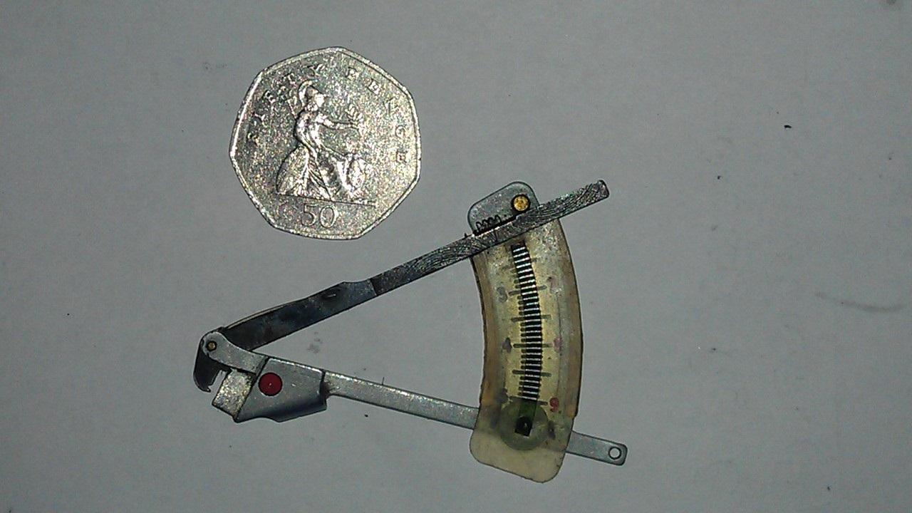

found this in a box of stuff i was given .any idea what it is ?

Does the anvil with the red blob on it pivot into two positions? The scaling, being red on one side implies that it refers to the measurement to the red portion of the anvil, and if the anvil doesn't pivot then the object being measured has to be an odd shape.
My first guess is that is for magnifying the measurement of something fairly thin such as sheet metal or whatever :scratch:)
(When I first saw it I thought that it was a jewellers gem measure, but I think the small size of the moving 'beak' precludes that)

Does anvil has V or slot?
Could this be used to measure set in saw blade? It has a little resemblance of saw setting tool, but that would be very tiny blade and for set, it should have a locking feature.

Some kind of hardness gauge given the large anvil versus the point which appears to be lower than the upper jaw after the point, enough area to raise a burr?

the anvil has a v . I have done a bit of research into the name printed onit  "Hatra"  and they make measuring equipment for the Knitting industry . so it's probaly some sort of needly guage

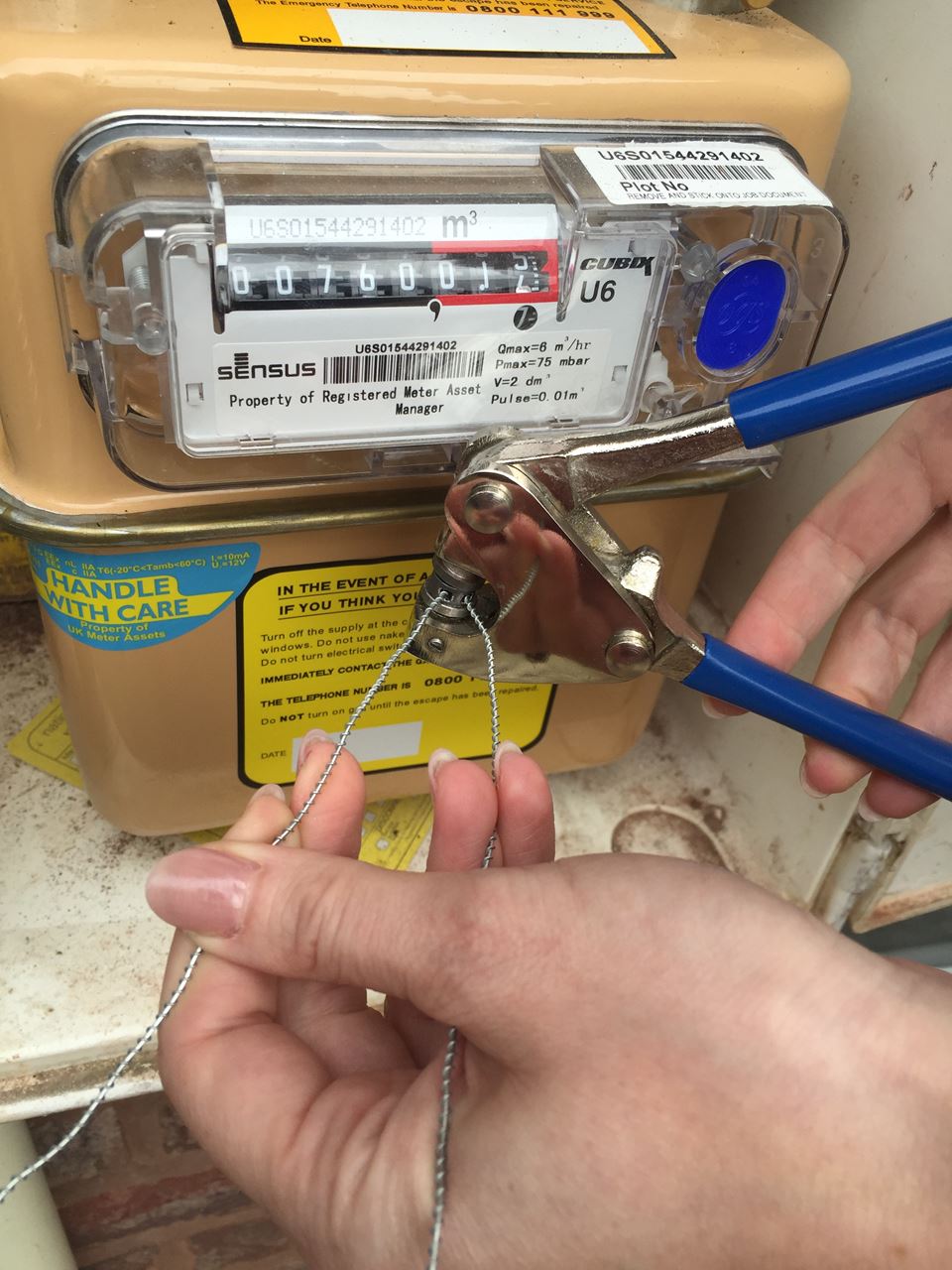

 It is a pair of seal pliers for putting the seals on electricity meters in the UK. The flat type with the little raised bit at the end, uses bowden cable threaded through the meter screw heads, and a soft tinned copper tube crimpted on to the cable using this tool

No I challenge that idea, seal pliers would have no need for a calibrated scale
Seal pliers look like this (but there are many variants)

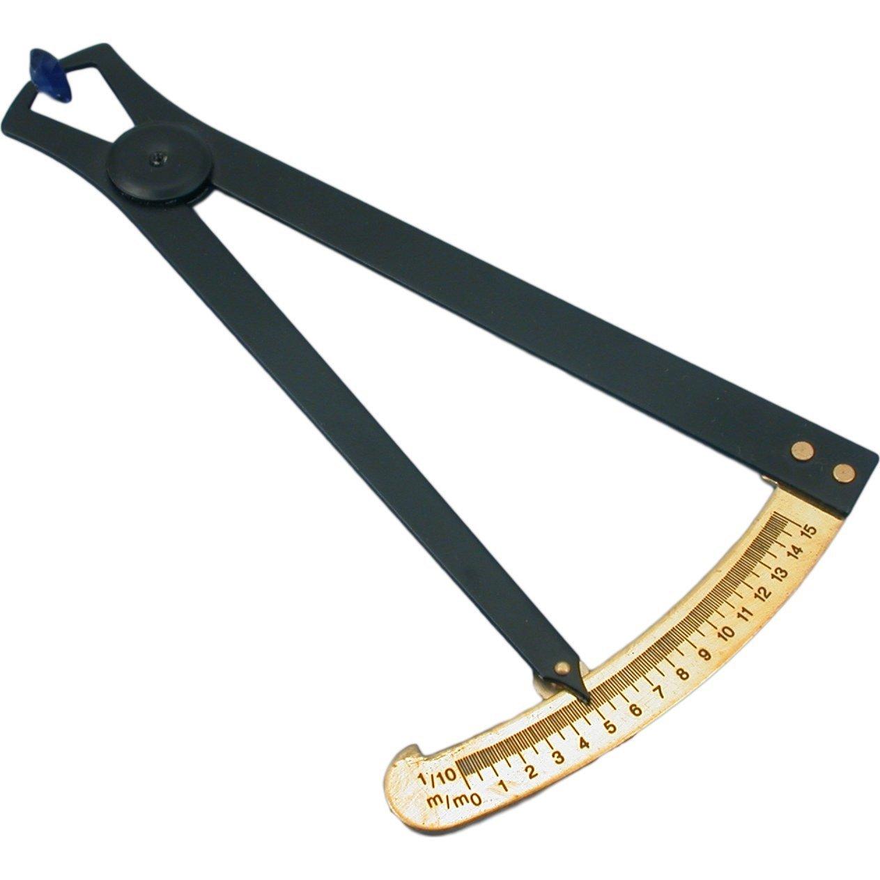

I still think it is a gem measure - this is a slightly more modern one:
(Image from Aliexpress of all places !!)

 You may well be right Andrew, but the sealing pliers being used on the gas meter and different to the more modern electric ones, which have a profile exactly the same shape as those jaws, I will try to get a picture of one tomorrow.

Slight issue Phil is that squeezing the lever on the OP's picture OPENS the jaws  :scratch:

I don't undestand the graduated scale where, for example, the 3 on the inner scale is opposed by 7 on the outer scale, 4 - 8 and 5 opposes 9.
Is it some kind of equivalence measure where you measure a known diameter and get the equivalent in another sizing system?
I'll get me coat!! went to take a pic of the meter seals today, only to find yer right< they are not that profile!! :doh:

What intrigues me is the fact that there doesn't seem to be a "1" on the scale, even in the resting position it is in appears to be a '1.5' reading. or something similar.  The "V" in the upper arm makes me think it is for measuring something flat along an edge, or making sure it only hits one very small area since the whole 'arm' will swing up and change the alignment.
Still have no idea what measures start at 2 and have the aforementioned  3=7, 4=8, 5=9.
I am actually intrigued by the milling marks to either side of the reading line, as well as the fact that it looks like the scale is see-through plastic?

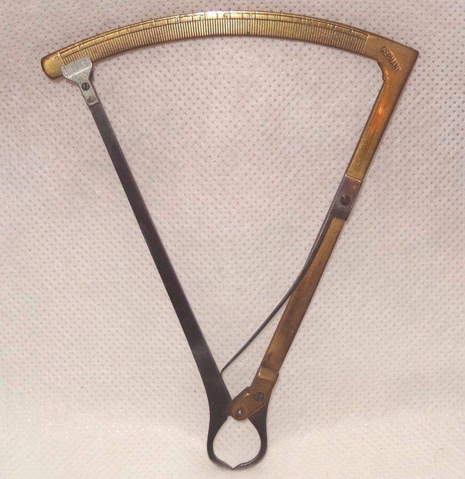

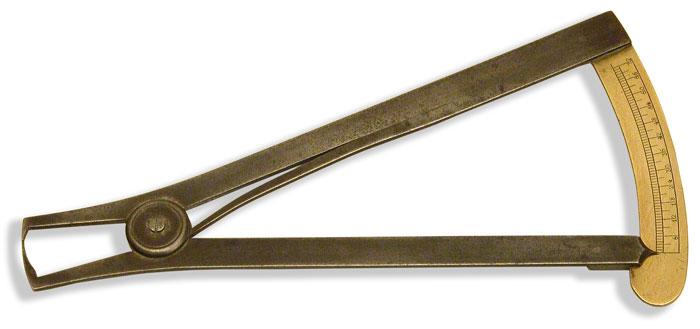

I have been searching the net and found two other tools with similar scales. I think as Andrew it is a Gem measure. The scale could be some other type than the two photos.
Vintage Antique Germany Brass Steel Spring Gemstone Diamond Jewelers Caliper
Millimeter Gauge Jewelers Diamond Gem Measuring Tool
