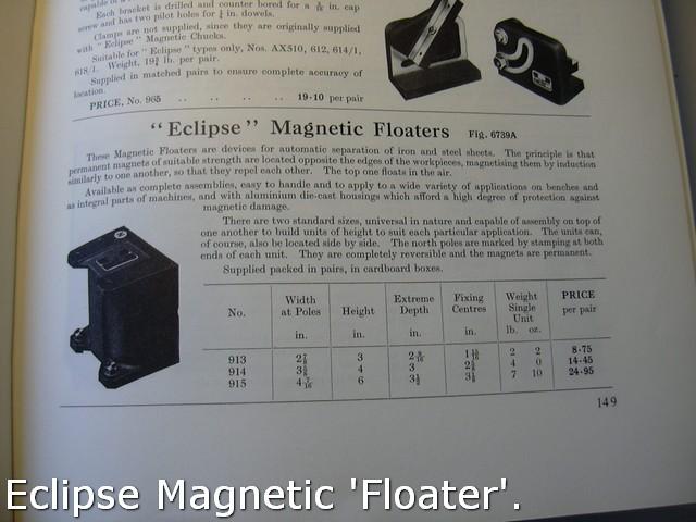

I'm sure I've seen catalogue pictures of a magnetic gizmo that's specifically configured to separate sheets of steel at one edge.  Maybe in my treasured hardback copy of the Buck & Hickman catalogue?  Works on the principle that like poles repel.
It might not be up to working on 6 mm thick sheet though!

Pete, yes I also remember something of the sort - I've a feeling that it used AC electro-magnets though rather than permanent ones  :scratch:

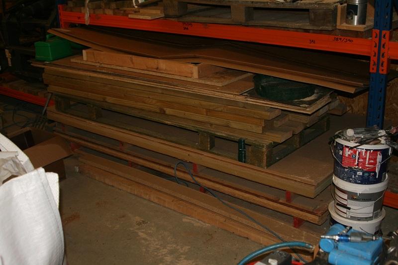

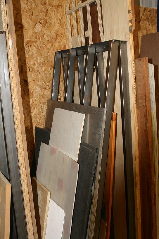

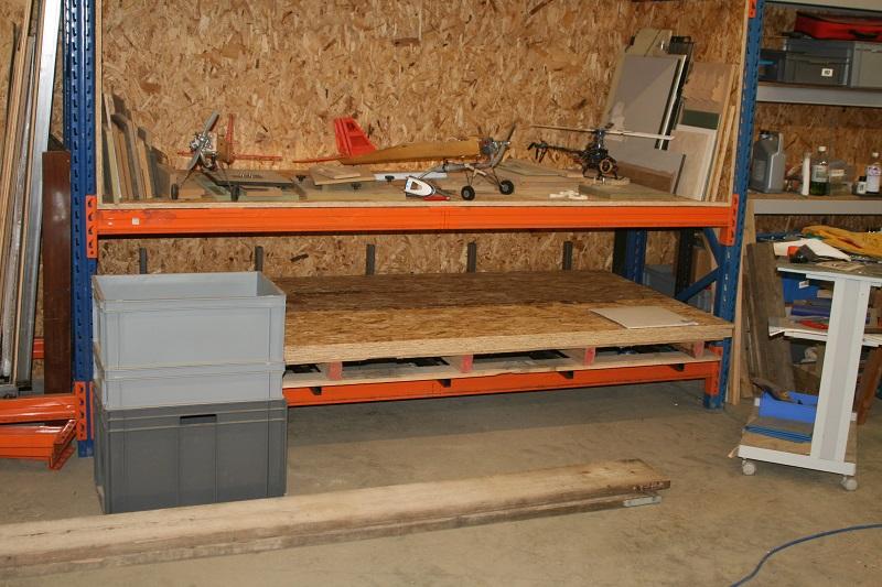

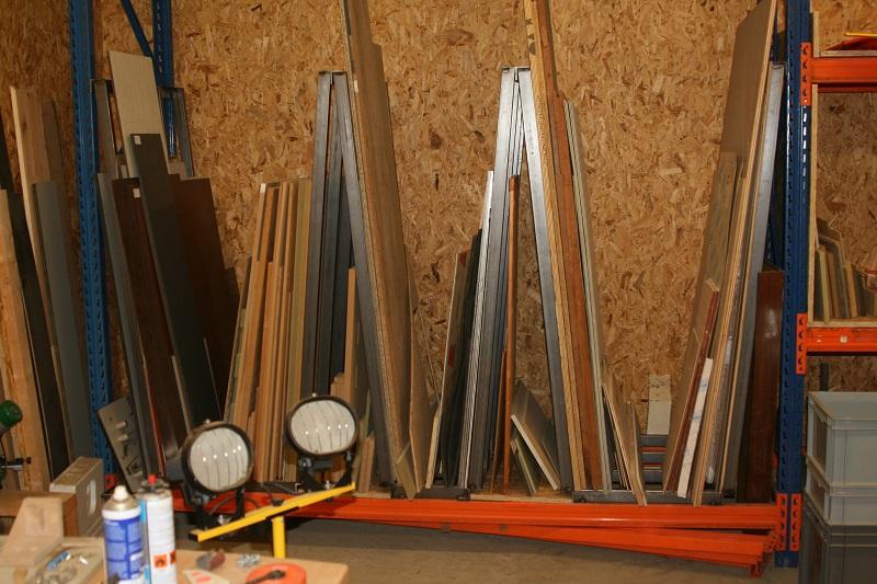

Here's a couple of my pix. My large sheet materials are mostly of the wooden variety, so a little easier to handle.
1. Just different materials on pallets on the floor
2. Proper version of pic 1
3. Sheet storage of all types. Main uprights could hold the full sheets and offcuts go in the centres
4. ditto
May spark one of your cunning plans.  :D

Nice Pallet racking Pete  :thumbup:
Sadly no room in the welding shop for that or it would be ideal.
I found the item I mentioned in my Buck & Hickman catalogue.  Here's the relevant entry:
(The prices are 1971/72!!)

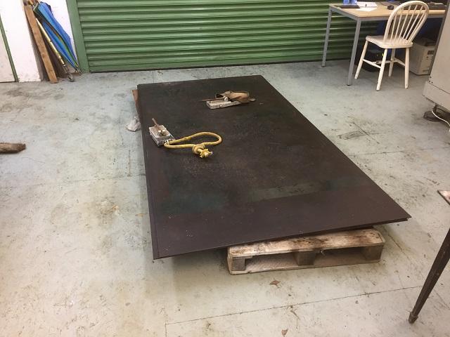

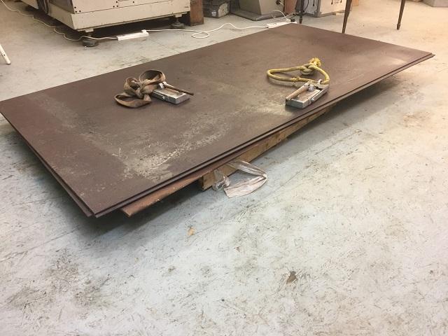

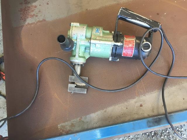

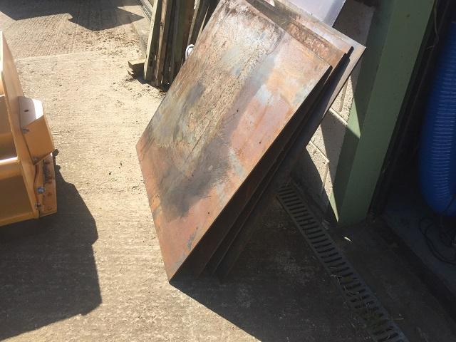

I gave up in the end, and, fed up with a pile of 6 mm 2.5 x 1.25 Metre steel plates on the floor of the workshop I cut them all down into half sheets that will lay flat on a pallet.

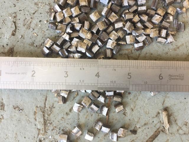

My old Duplex 1/4" nibbler worked overtime cutting many feet of plate, but worked an absolute treat, producing a  very impressive pile of 6 mm cubic shrapnel  :bugeye:
Re: Suggestions Please for Storing Sheet Materials
« Reply #25 on: April 10, 2017, 08:10:02 AM »
The piles of plate accumulated, this size is JUST about man handle-able  :thumbup:

« Reply #26 on: April 10, 2017, 08:10:42 AM »
Wow, that's quite a nibbler!
My little pneumatic one would herniate itself if I shoved 6mm plate into
(unmangled by AWEM 13:38)

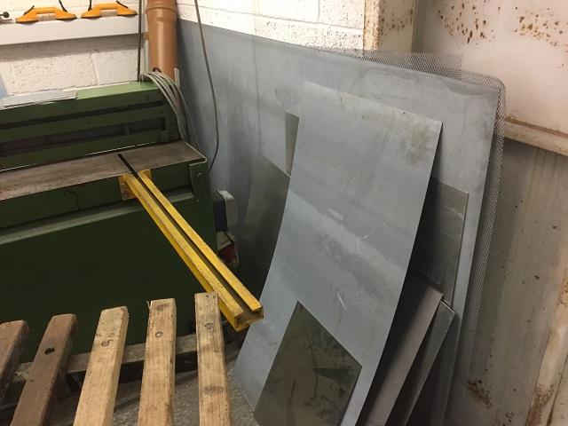

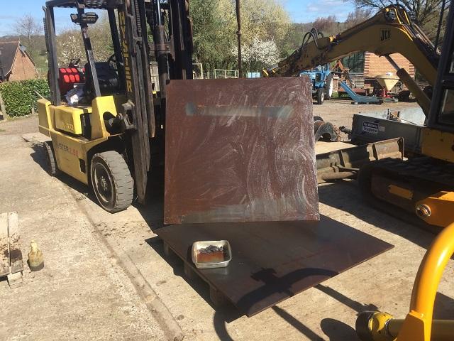

Then they all got dangled from the fork lift using one of my magnetic lifters, and given a good coat of Shell Ensis rust preventing oil, before being stacked on a pallet and tucked away in a storage container.
At last I have my floor back !

« Reply #29 on: April 10, 2017, 08:28:51 AM »
It doesn't come out to play very often, but when it does it's very handy.
I have actually cut 8 mm plate with it !!!!
