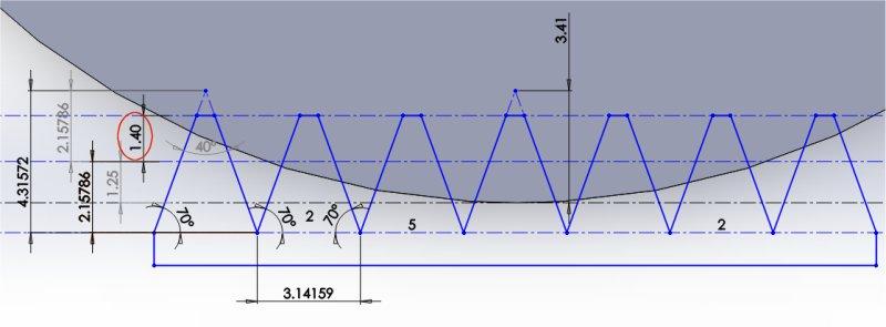

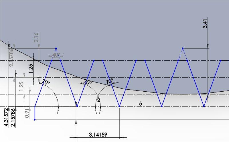

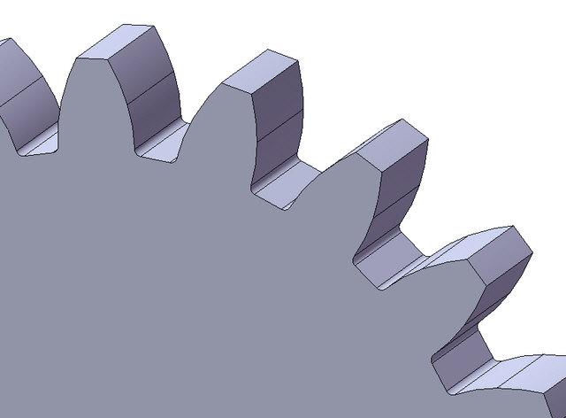

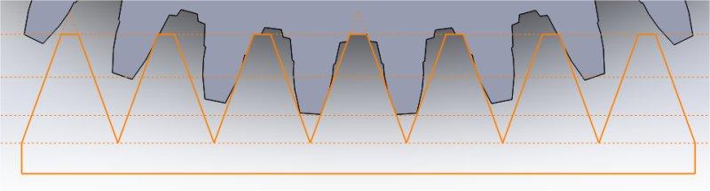

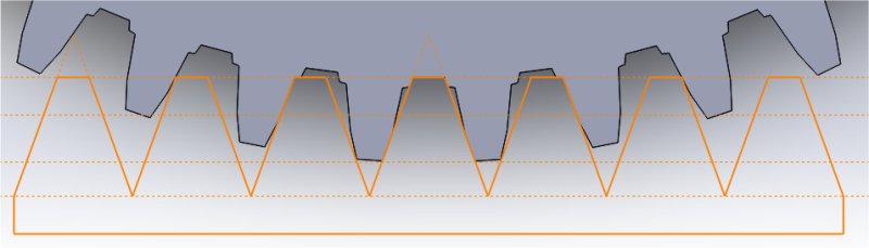

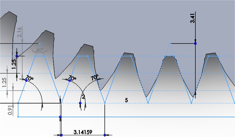

I spent hours last weekend making a cutter as pictured by the OP for 20DP gears. It did not work at all for cutting the actual gears. The cutter cut just fine, but the geometry of the finished teeth was, well, non existent. The teeth are pretty much triangular with no involute to them at all. I think I will try to replicate what this cutter does in a solidworks model. I should be able to see if this was doomed from the start, or it's a scale issue.
Has anyone else tried this method with a larger pitch tooth? The gears made at 48dp look good. Wish I could say the same.  :coffee:

OK, so in lieu of actual machines, I broke out SolidWorks as well  :lol:
Unfortunately, I just can't get mine to work properly  :scratch:
Please look at the 3 attached pictures:
The first picture shows my "cutter" lined up with a gear blank. The dimensions are all taken from Helicron's site, namely: 4.32mm maximum depth-of-cut (assuming pointy-tipped cutter). 1/2 way point between (2.16mm) is the contact point (gap & tooth width equal), so I assume this is my PCD. Actual DOC (assuming pointy cutter) is 3.41mm (again, taken from Helicron's site). And finally I've lopped off the top to 1.4mm above the PCD (red circled dimension).
This results in the "gear" as seen in the 2nd picture. Looks to me like the teeth are too skinny, have an odd "dink" where the tall cutter is catching just inside the PCD, and a strange "pit" at the bottom where the cutter is at max depth.
So... I reduced the cutter height-above-PCD to 1mm... and got the result in pic 3. The teeth still look too skinny, but at least that "dink" has gone away. Still got the weird pit though.
Obviously, I've mangled something somewhere. Can anyone set me back on the right track? The measurements are all based on Module 1 gear (as far as I understand Module...) & 20 degree pressure angle.
I've attached a ZIP containing the Solidworks (2013) part, so if someone fancies fixing it for me! Note that I'd like to use Helicron's method (i.e. simple 40-degree included angle pointy tool) to actually cut the cutter.
Thanks!
  • Posts: 1224
Re: Cutting Spur Gears -- A neat technique
« Reply #31 on: May 20, 2017, 05:23:11 AM »
Your rack still does not look quite right . The width of the V at the circumference of the blank should be at least equal to the flat at the top of the rack.  it looks like the flat is too wide given the depth of the cut.
  • Posts: 2489
« Reply #32 on: May 20, 2017, 05:48:05 AM »
Doh! You're quite right of course... I got the cutter blank diameter wrong - I was working with an outside diameter of 48mm, not a PCD of 48mm...
Re-set the diameter to 50.50mm (PCD + 2x 1.25mm), and it's looking better. I increased the cutter depth back to 1.4mm, as the tooth looked a bit shonky at 1mm.
Still got that "pit" at the bottom, is that because 1.4mm is too deep a cut? Or because it's only an approx tooth form?
Thanks for the prod anyway, made me realise what I'd done wrong  :thumbup:

« Reply #33 on: May 20, 2017, 06:22:11 AM »
Well... they mesh... more or less...
Might need a spot of virtual grinding paste in there to smooth things off a bit  :lol:
  • Posts: 1224
« Reply #34 on: May 20, 2017, 11:34:42 AM »
They don't look too bad  :D
what happens if you do another cut with the rack and gear half a tooth around (if you see what i mean).?

Hi Russell,
Every time I look at this again it makes my brain ache... For the pics I did above BTW, I did reduce the cut to 1.25mod (i.e. 1.25mm), it reduced the "pit" but didn't eliminate it.
So, attached is another pic of the cutter sketch.
The four dotted lines, starting with the top one are:
 - My maximum depth of cut (note the triangular peak marked 3.41 - that's the theoretical DOC if the cutter were infinitely sharp)
 - The next dotted line is the PCD (point where tooth & gap are equal, exactly half of the absolute maximum DOC, 4.32mm approx)
 - The third dotted line is the outer edge of the gear blank, and represents the point where I stop cutting
 - The fourth and final dotted line is the bottom of the cutter (=bottom of the rack).
Now... according to Helicron's site, the total DOC should be 3.41mm based on a 2.16 + 1.25 cut. But I'm not cutting as deep as 2.16, is that a problem??
Thing is, if I go full depth (i.e. the full (theoretical) 3.41mm cut, I end up with vampire teeth (pic 2)...?
 :scratch: :scratch: :scratch:
A bit more information:
Gear blank is 50.5mm diameter (increased to 52.32mm to account for the increased DOC)
I'm "cutting" a module 1 gear, so 48 teeth.
20 degrees pressure angle.
  • Posts: 2489
« Reply #37 on: May 22, 2017, 08:22:45 AM »
Ignore that last one... my DOC's gone all wonky...
No... don't ignore it... the DOC is actually 3.41mm from the base dotted line to where I've trimmed off my cutter.
Last modification....! Do ignore it, I've got my blank WAY too big. I'd missed the bit where the OD of the blank is N(o of teeth) + 2 in mm... i.e. 50mm.
I've still got a "pit" though. I can only assume it must be because it's an approximation rather than an actual involute.
« Last Edit: May 22, 2017, 08:49:06 AM by AdeV »
  • Posts: 545
« Reply #38 on: May 22, 2017, 02:24:16 PM »
Hi Ade
Don't forget there are two DOCs here.  The first one is for making the cutter - 3.41*MOD as you show.  The next one is the DOC when cutting the gear blank which according to Helicron is 2.25*MOD or 2.4*MOD for fine gears.
It may not help but I attach the spreadsheet I used to calculate the numbers when I tried this method - I wanted to make some 14.5deg PA gears. :smart:
