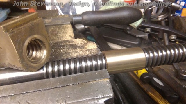

Used to have one 2 or 3 lathes ago but it was very badly worn and probably gone for scrap now. Adv had a few of the bits off it, chucks, steadies etc.
Made a couple of cross slide nuts for an Edgwick ? a while ago ?
Pressed an insert into the original nut [ too idle to make a new one ] and supplied a spare insert as well.

Also thanks to John Stevenson for that info regarding cross slide nuts- again whn I get that far I will probably give you a shout- I can see joining this forum was one of my better ideas!

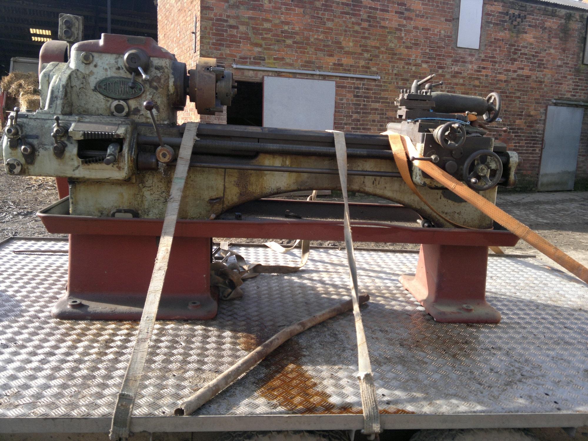

I have finally managed to get a photo of it uploaded- still on the trailer having fetched it though!
  • Posts: 9139
Re: Edgwick Lathe
« Reply #17 on: February 23, 2017, 09:06:55 AM »
Now there's a meaty bit of iron.

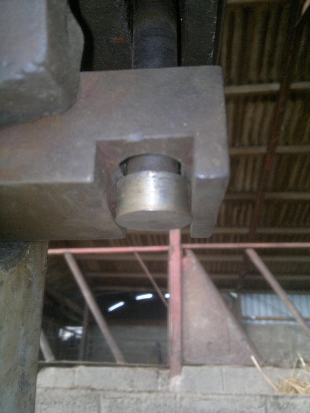

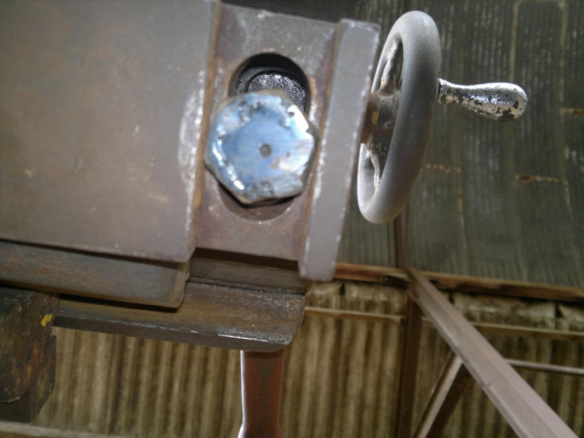

Back again!  Iv got around to looking at the non-working tailstock clamp- but being thick I cant see how it is supposed to work! Iv uploaded a pic of the underside of it- do any of the other Edgwick owners on here know whats missing/wrong that makes it "pull up" when rotated?
  • Posts: 9139
Re: Edgwick Lathe
« Reply #21 on: February 28, 2017, 02:25:46 PM »
Is that an eccentric cam on the end of the locking shaft? If so presumably it forces the 'shoe' in which it rides against whatever is next to it  :thumbup:

Thanks Ade. I don't think its a cam on the end- the unit need to pull vertically upwards to clamp against the underside of the bed- not sideways.  So being as thick as I am I can't see how it is supposed to do that. Hopefully Ade can shed some light on the matter..............

Turns out it's a pretty simple mechanism actually... there's a base plate (the "shoe"), and a clamping "thing". The bar that goes up from the "shoe" to the lever is threaded, as you turn the lever it tightens, raising the base plate which squishes the clamping "thing" against the underside of the ways.
See photos (click to embiggen as usual):
Lever in unlocked position:
Lever in locked position (note: more thread sticking out of the top):
Looking at your photo Matt, I think all you need to do is to tighten that threaded bar up so it's just touching the bottom of the shoe when the lever is at the back of the tailstock. I'm going to take a wild guess that it'll be quite stiff, I'm assuming the lump on the bottom is designed to bind slightly in the "shoe" so the lever tends to tighten on the thread, rather than just rotating the whole piece. If not, then I'd tighten it anyway, then wedge a shim in there so that it binds up.

Thanks very much guys- I was missing the fact that the handle is threaded onto the vertical bolt- I thought perhaps there was something missing off the bottom that raised the shoe.  The round piece turns inside the show so will need shimming out somehow as Ade suggested- anyway now i know what the issue is I will see what I can sort.  Thanks again, Matt

If the bolt rotates, then there is a problem with the shoe. The slot should be straight cut and a close fit to the head. The design is not unlike the Boxford, and I dare say, a lot of other lathes, in that you can adjust the length of the screw by 1/6th of a turn by pushing the shoe up so that the head of the bolt disengages with the slot, then rotating it.
  • Posts: 9139
Re: Edgwick Lathe
« Reply #30 on: March 02, 2017, 10:51:39 AM »
From the picture in post #20 it does rather look as though someone in the past has replaced the hex headed bolt with one that had a larger head that has been turned down to fit the slot, but doesn't grip - unless as I said in an earlier reply the circular head is actually eccentric and locks against the shoe.  :scratch:
Re: Edgwick Lathe
« Reply #31 on: March 02, 2017, 11:02:40 AM »
Has the previous owner turned the hex (or square) head off the bolt?

« Reply #32 on: March 02, 2017, 11:22:01 AM »
Could easily be cured by drilling the bolt head radially and pressing a roll pin in

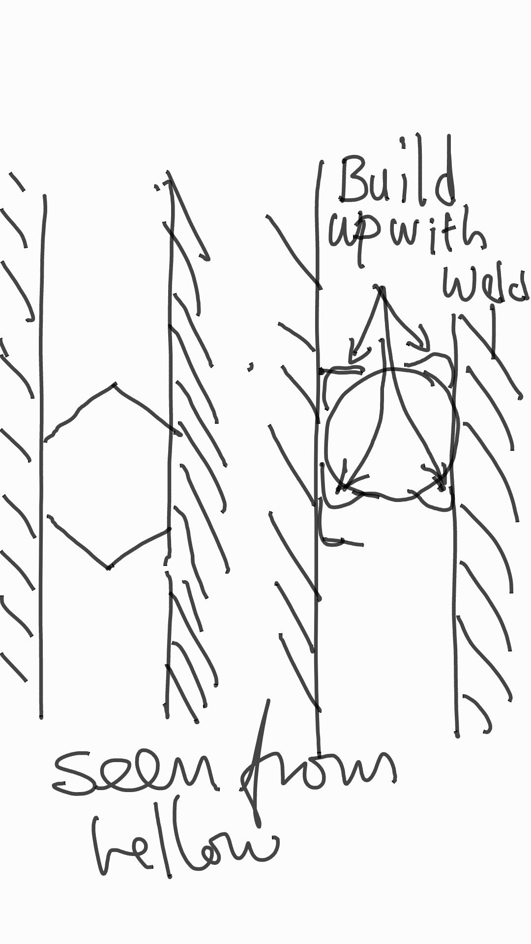

I just went back to the original pick, I had missed that it had been turned round. Andrew's solution is probably the easiest if you haven't got a welder to put a ridge on the head of the bolt. Normally the hex head is held in place in the groove.
Although Andrew's solution is viable, it will leave slack in the movement. Four welds to transform the head into a squar would eliminat play!

How about making a simple clamp to stop the head turning:
A grub screw (or 2) from the side could lock the round head. The width of the block could be a snug fit in the slot in the shoe.

I realised I hadn't looked under the shoe to see what was there... and sure enough, it's a ruddy great bolt head:
So I'd be tempted to go with Matt's solution: Adjust so it works, then weld to the bolt head so it jams in the shoe.

I have found a nut the correct size- so I am going to turn the "lump" on the end of the bolt down to the size of the hole in the nut, then weld it on. Then it will be as it was originally. I will post some pics when i've done it, but thanks for all the info guys.

Hi again, I have fixed the clamp by turning the old bolt head down and welding a nut on the end as I had planned. Have attached a pic, not the smartest job I'v ever done but it seems to do the job! Thanks again for all the info.
