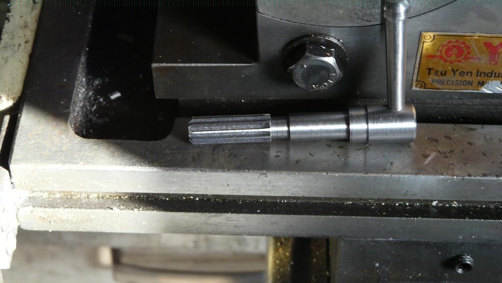

I have aquired a Tywanees dividing head Vertex BS-O same as the Grizzly G1053 that is shy some bits , the direct indexing gear no 18 in the PDF is missing , iff anyone hear has one please tell me the number of teeth for me to make one , thanks in advance .

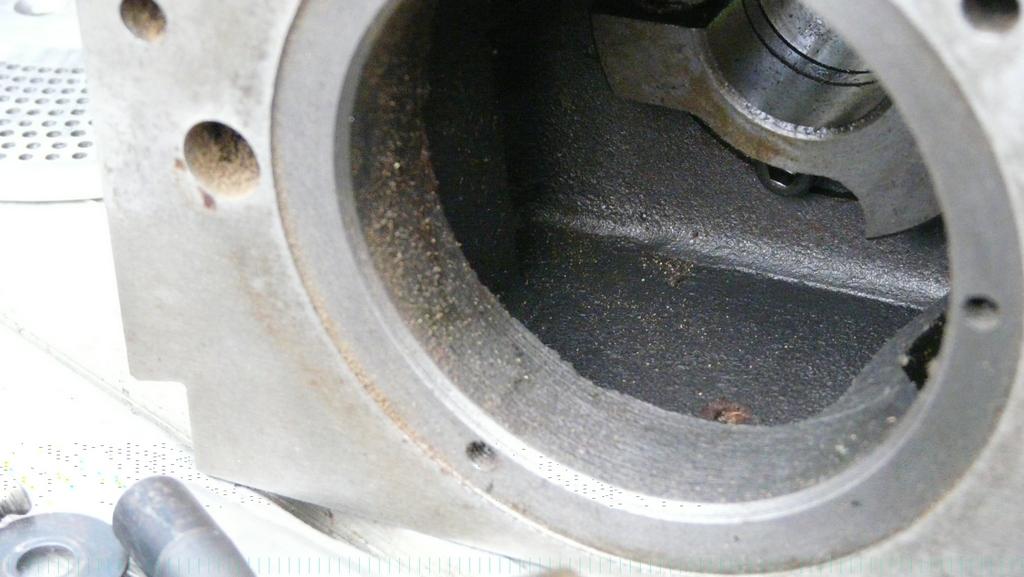

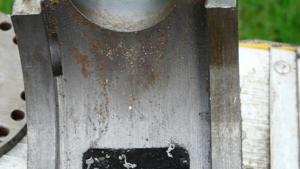

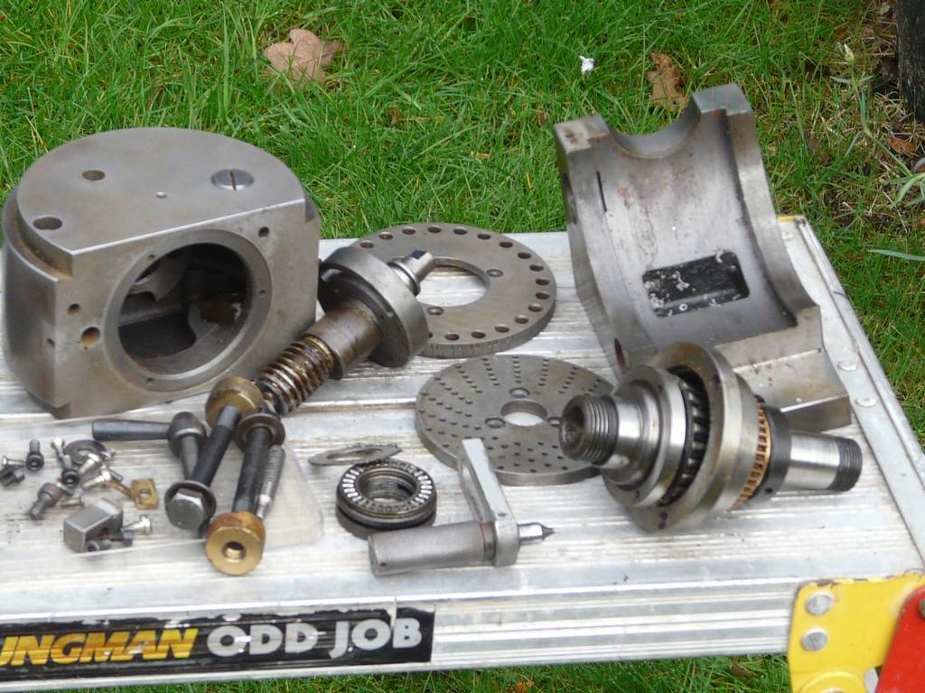

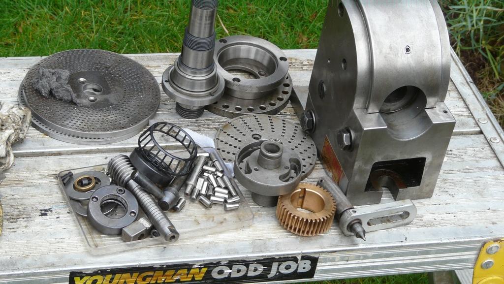

Part 18 is a 10mm shaft with a pinion on the end , I have disasembled the head as it has sawdust in it will take some pics tomorow and post , you like pictures .
Re: Dividing Head
« Reply #4 on: February 16, 2017, 03:37:46 PM »
Jeff,
It's got 11 teeth.
If you want any dimensions let me know.
« Last Edit: July 13, 2017, 01:03:18 PM by philf »
Re: Dividing Head
« Reply #5 on: February 16, 2017, 03:41:59 PM »
Thanks Phil mutch apresheated I would not have gessed it had that many , I thought 8 at most .

"I have disasembled the head as it has sawdust in it will take some pics tomorow and post , you like pictures"[/i
.... he he .. how ever did you guess that  :clap:
This coming together of forum members and gleaning information is what it's all about  :thumbup:

« Reply #9 on: February 17, 2017, 08:39:45 AM »

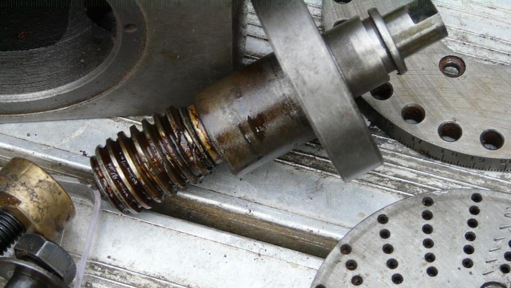

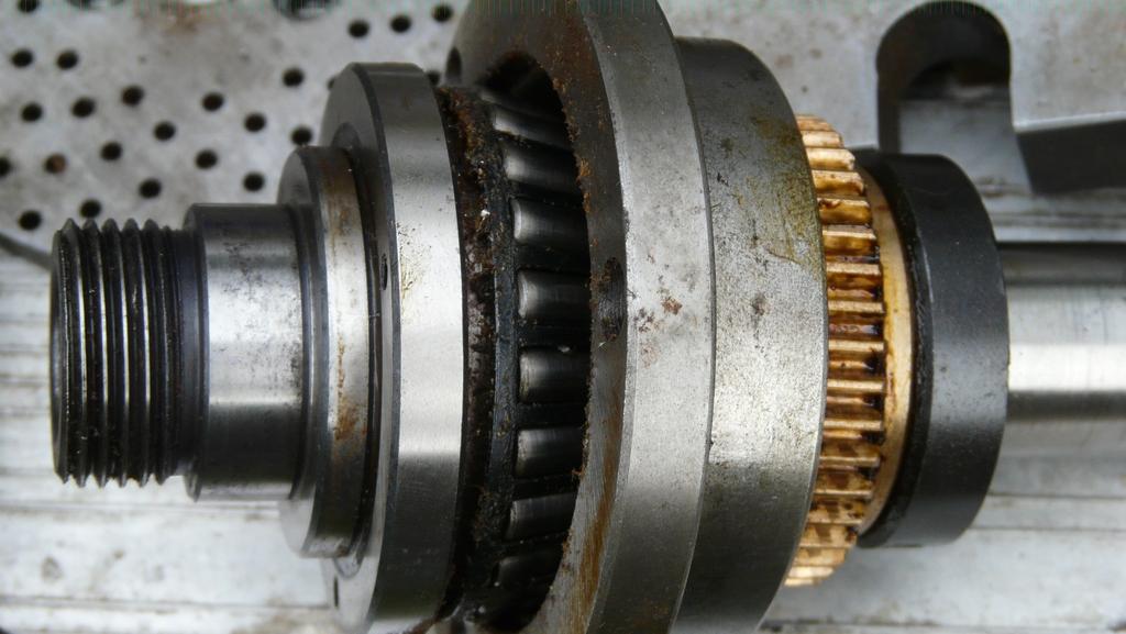

Got it cleaned white spirit and steel wool .
Re: Dividing Head

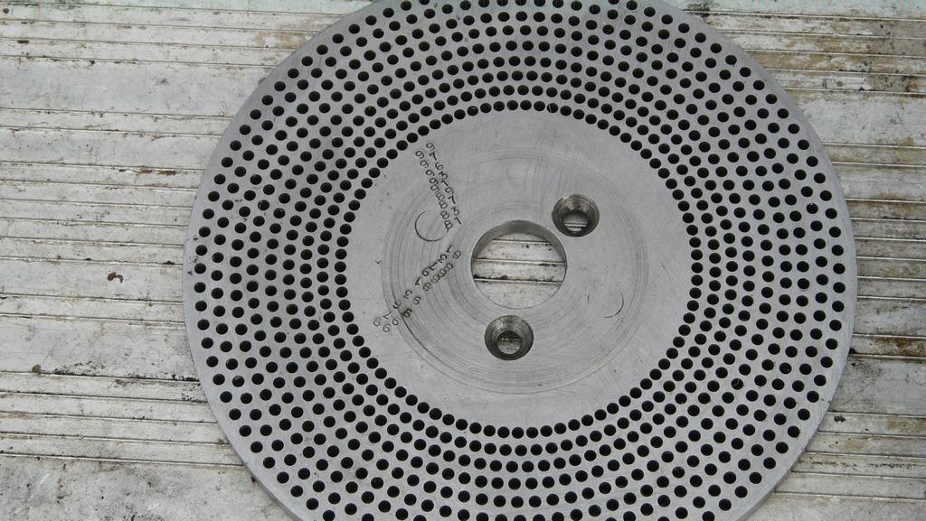

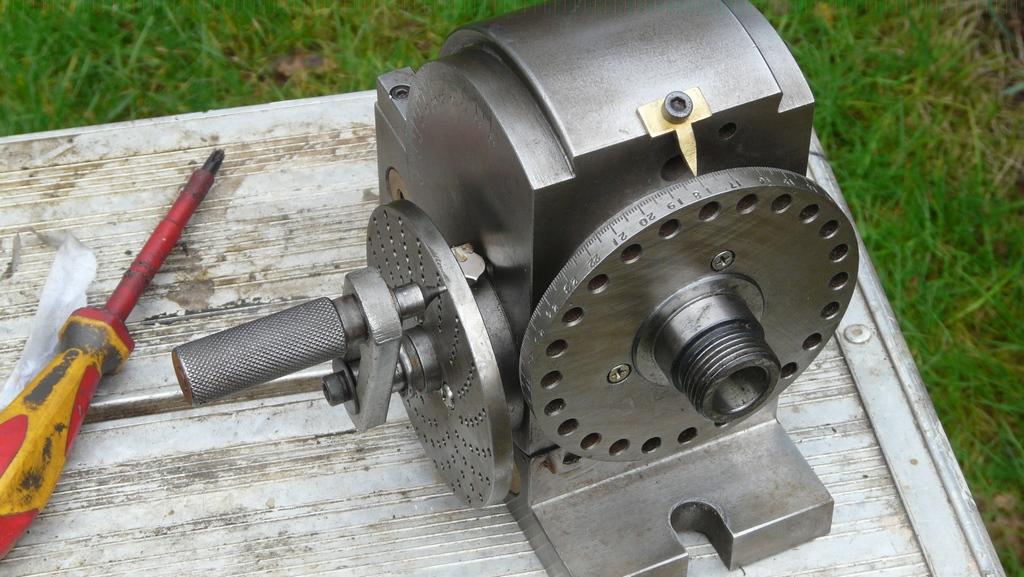

« Reply #10 on: February 17, 2017, 08:49:30 AM »

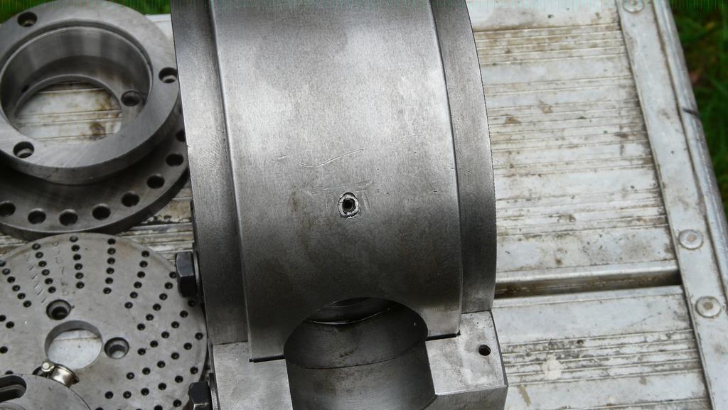

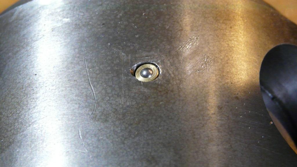

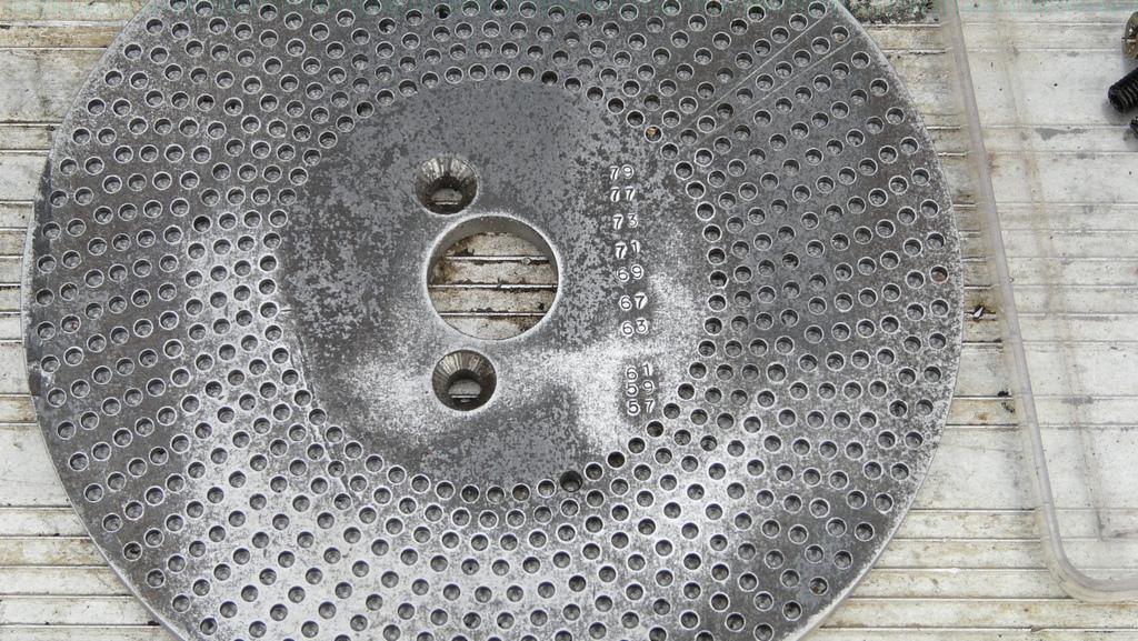

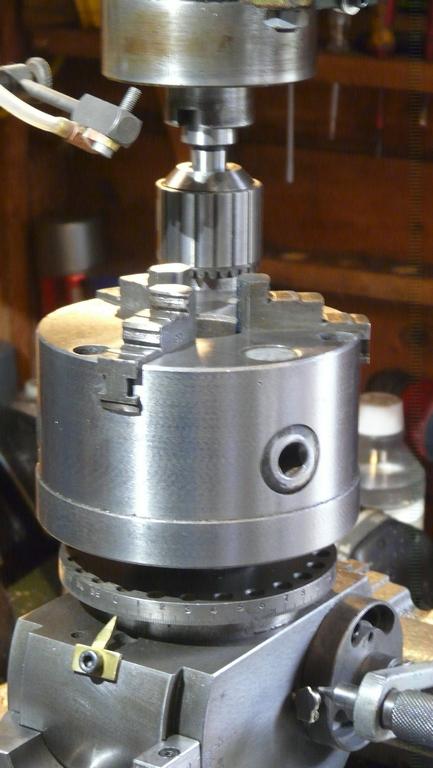

Put back together the rear oiler was broken drilled it out 1/4" only had 6mm so glued that in , also snaged two high range plates for it , fingers are missing and the nose is 1 1/4" x 12 my chucks are 1 1/2" x 8tpi and the locating blocks need replacing to fit my tee slots , but first will be the direct i8ndexing gear .
Re: Dividing Head

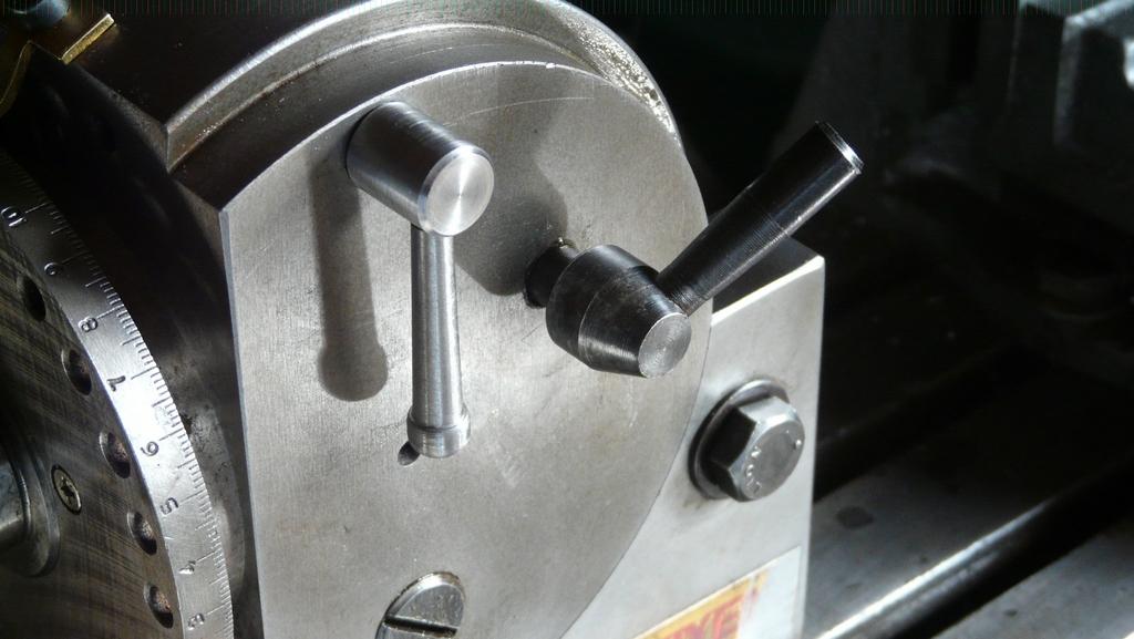

« Reply #11 on: February 23, 2017, 10:24:11 AM »
