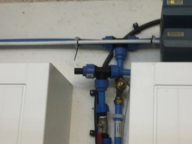

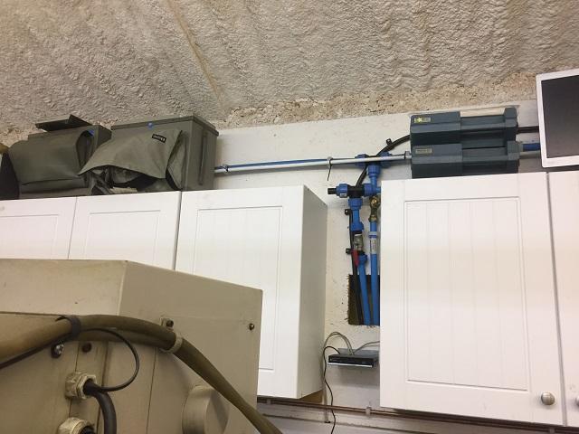

My nice civilised Hydrovane 15 (well I think that it's a 15 but never found a model number on it!) was cutting in a 85 psi and out at 125 psi which has been fine until I got my CNC Plasma Table - the Hypertherm PM45 plasma cutter on it specifies it at 90 psi (although it regulates it lower internally).
So a job yesterday was to tweak the pressure switch on the compressor up just a tad so that it never falls below 90 psi. Often compressor pressure switches - or at least the better ones - have settings for maximum pressure and hysteresis or dead band, thus setting the range from 'cut in' to 'cut out. But not this one - it's a cheapy generic one with only the maximum pressure settable. No problem, increase it from the 125 psi upper limit to a bit nearer the 150 psi that the compressor is rated at. I checked the test pressure of the tank and there was loads of margin, so 'one flat at a time', I tweaked the adjusting nut and cycled the compressor noting where it switched off.
I got it up to about 140 psi when suddenly the Hydrovane would not raise the pressure one iota. I thought I'd done massive internal damage to it, so a bit miffed I left the Portakabin where the compressor is housed, to go in the main workshop to google for technical diagrams of the beast.
As I got to the door, a chap that I have at the moment lowering a massive Laurel hedge called over saying he was glad I was ok as he'd heard the 'loud explosion', and come knocking on the locked workshop door to check I was ok :bugeye:
What explosion - I'd heard nothing ! So I went hunting along the considerable length of my air distribution system and eventually found the culprit. There was a three way Tee joint, where one branch is for future expansion, and the blanking plug had decided it was no longer going to stay put  :bang:
« Last Edit: February 16, 2017, 01:24:36 PM by awemawson »
Re: Boom - or the Power of Compressed Air !
« Reply #1 on: February 16, 2017, 01:01:47 PM »

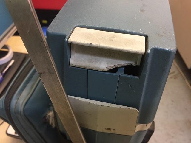

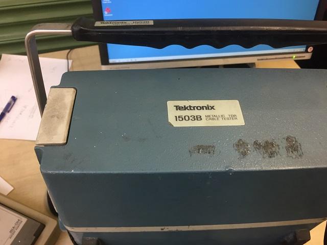

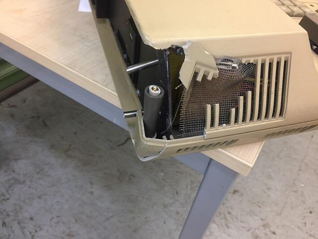

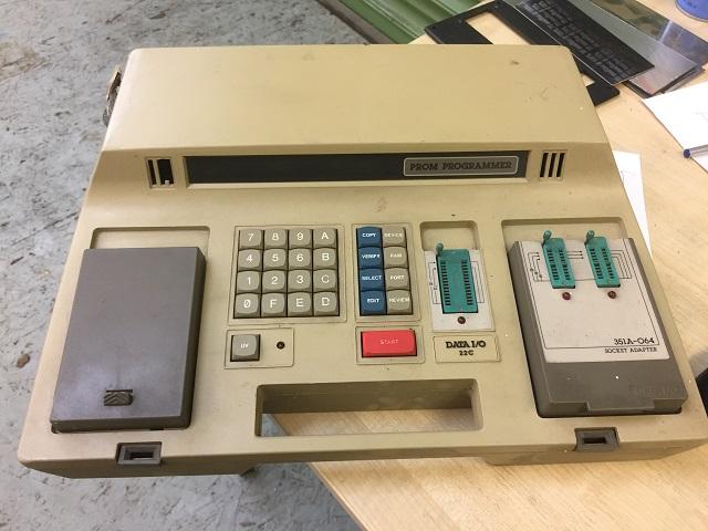

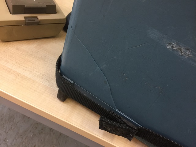

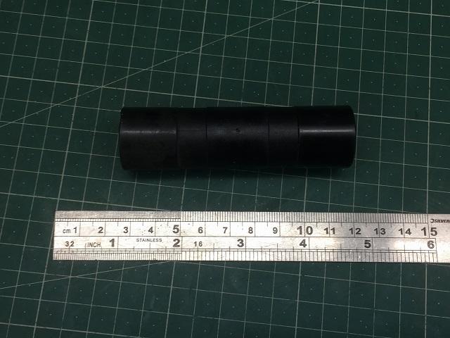

Now this is a 'proper official blanking plug' for 25 mm MDPE pipe certified for pressures in excess of what I'm using, so maybe I'd not tightened it quite as much as I should have. The plug is a harder plastic than the pipe, and I suspect that the 'grippers' don't bite into it as much if at all.
So no wonder the poor old Hydrovane couldn't raise pressure  :lol:
However, the huge explosive blast sadly cleared the top of the cupboard where the joint is, knocking to the floor a Prom programmer and my Textronix cable measuring device. Falling onto a hard floor they both have suffered damage, and as they fell, they knocked the polycarbonate safety shields off my Fanuc Tapecut Model M wire EDM machine but luckily they survive the encounter.
« Last Edit: February 16, 2017, 01:28:51 PM by awemawson »

I replaced the original blanking plug, (which had vanished!) with another from stock, and tightened it up murder tight, but today I found the original way over the other side of the barn. It must have bounced all over the place to get where it was   :bugeye:

 Bad luck Andrew, that damage is a bit of a B*stad, but if you can find the bits, it will fix with Hepworth solvent cement, I have some on the desk as it happens. It actually blew those off the shelf onto the floor?
« Reply #6 on: February 16, 2017, 02:05:17 PM »
Phil, as I said I wasn't in the workshop when it happened (lucky or I may have had other 'accidents'  :bugeye: )
So whether it was the impact of the 'blanking plug bullet' or the blast of air, or more likely a bit of both that did it I'm uncertain. But yes they were knocked off completely.  The Textronix TDR 'scope powers up, but reports 'screen temperature alarm' but is ok if you accept the error and continue - I'd imagine that a sensor has been destroyed or perhaps ripped off by the impact. I haven't ventured too near the Prom programmer - actually I can't remember actually using that one - it was a 'too good to ignore' bargain sometime.
