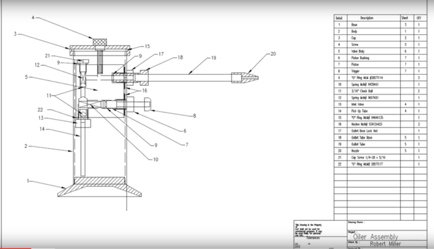

Re: Eagle Type Oil Can
« Reply #7 on: February 02, 2017, 12:56:22 PM »
Hi Stew
  I had watched the videos and took a screen shot from the video, very low tech  :Doh:  , and was just going to make it fit my bit pipe.
Hi Joules
  A 3D model is always a handy  thing to have   :poke: :thumbup:
« Reply #15 on: February 04, 2017, 06:32:56 AM »
Ok here we Go he'rs the drawings
« Reply #23 on: February 06, 2017, 03:19:47 AM »
Hi Oil can makers
I've had a mistake on the drawings pointed out to me:-
Part 2:- Valve body the 7.5 distance from the centre to the 3/8*32 hole is wrong it should be 10
 :doh:
Sorry
